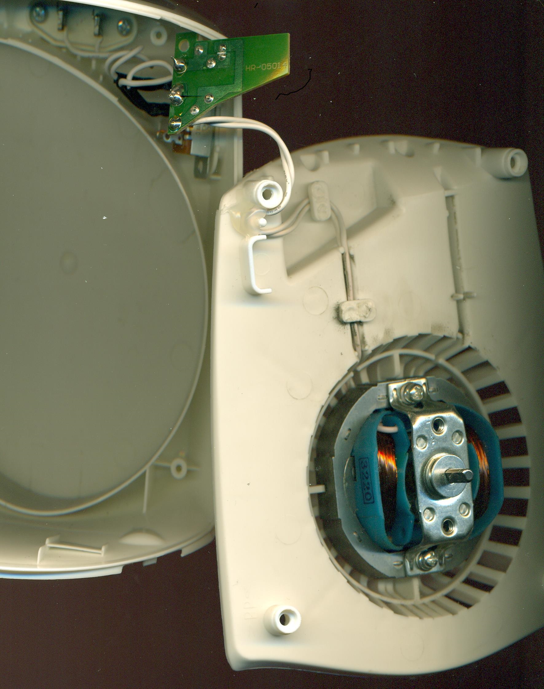

                  I have a Hamilton Beach "True Air", model 04531GM , Series B2021AT, wall-mount fan/air freshener. This unit is comprised of a fan motor, ON/OFF switch and a LED. The Led appears to be white color and is soldered to a small PCB that has a diode and 33 Ohm resister sitting beside the diode. These components are soldered in place of course.
                  As a learning project, I would like to test the diode with my DMM, which is a Radio Shack catalog number 22-805 and has a diode setting, as well as the usual other settings.
                  I have attached a picture of a diode that looks like mine, with the silver band at the negative cathode end.
                  Is it possible to test this diode with the leads soldered in place, or would I have to desolder one lead ? Naturally, I would not have the power ON (fan plugged into an electrical outlet).
                  Thanks in advance for your replies.
                  ToddB66

                            If you got a reading the same both ways, it sounds like either there is a resister in parallel with the diode or the LED you mentioned on the board is in parallel but reversed. You need to look at the tracks on the board and determine what else is connected to the diode.
                            Some meters do not give an accurate reading in the 'diode' mode. In reality, the diode mode will only give you an indication of whether the diode/transistor is ok. I have had components that read ok but will break down under load so dont take the reading as gospel. The only real test is to read voltages when it is running to determine if they are working as they should.
                            If you want to practice on components, go buy a mixed bag of resistors, diodes etc and test those. The solder them into basic circuits so you can understand what readings you get when components are not in isolation. If you were in AUS I would post you a collection to play with.

                              Qiaozhi,
                              Attached are two pictures showing the inside of my True Air model 04531GM air freshener and the top & bottom of the PCB for the LED, including the 33 Ohm, plus/minus 10 percent resistor and black-colored rectifier diode.
                              If I uploaded both pictures correctly, you should see the top side and bottom side of the PCB......if not, I'll leave the one shot and try to upload the correct second view. BTW, I plugged the unit into a wall outlet and the LED works, despite our suspicion that the diode might be faulty (since I got the same 027 reading with the meter leads touching the diode leads both ways.
                              Last edited by ToddB66; 03-06-2015, 09:33 PM. Reason: Q..I'll add the second picture in a new post soon.
