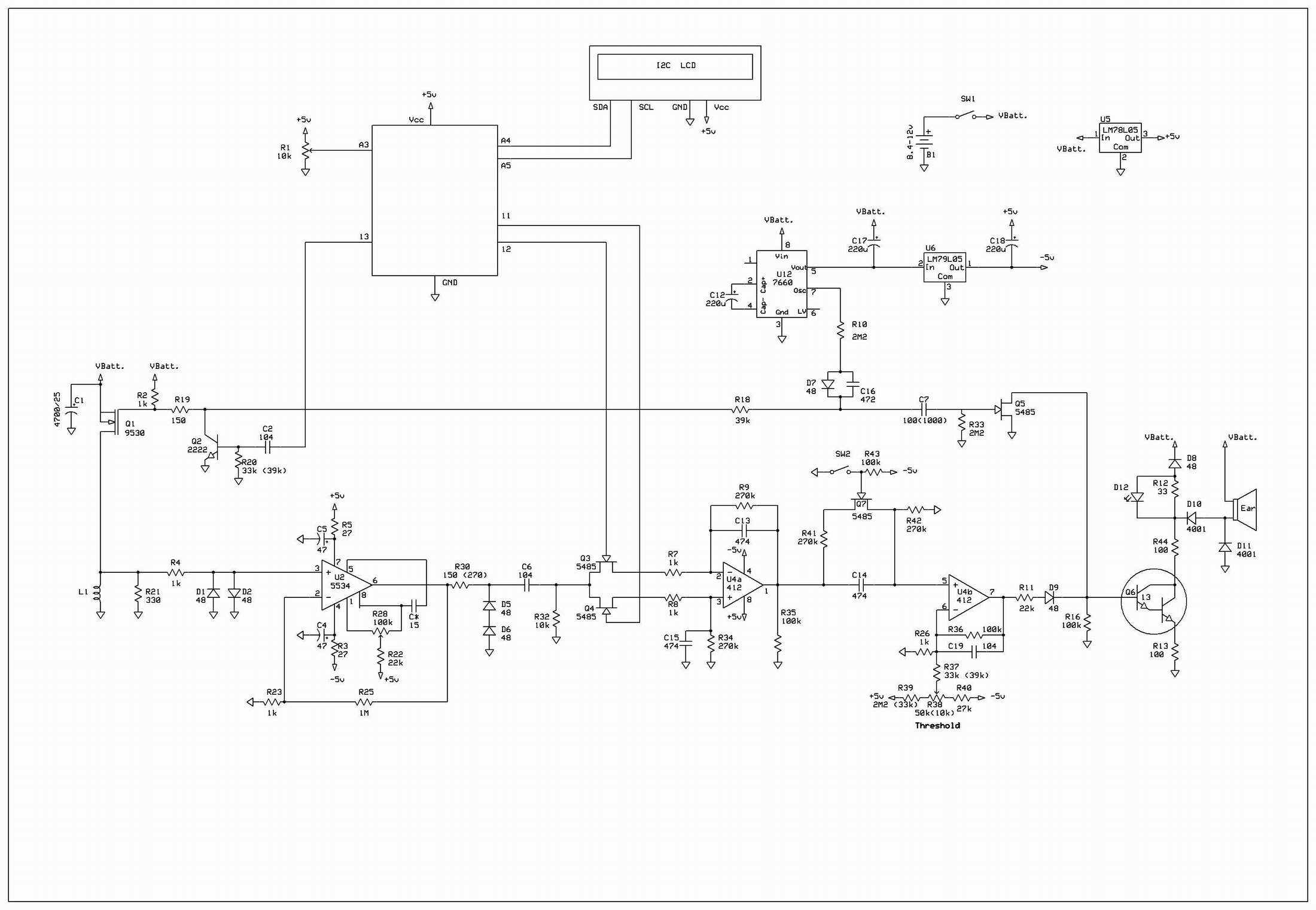

                this is the layout im using
                      [ATTACH]38768[/ATTACH]
                      @ivconic not being funny but have you tried using linux im finding windows a pain have to hit upload a few times to get it to flash, i used ubuntu when you load it up use the shell use sudo arduino and no driver or nothing needed, if you use the icon to launch the ide the com ports don't show up
                          You can nick a "tic or few" more if you control the whole port instead picking it's pins separately.
                          Even that it's not the method which will provide you accurate timings... unfortunately.
                          What you are planning with this? Are you planning further improving... let's say adding a LCD and digital audio output?
                          Maybe soft buttons and more "jingle&bells"?
                          Each functionality you add later; will affect your present timings.
                          Without use of interrupts there is not much that can be done on this subject.

                          Using his approach i made small step forward by implementing I2C LCD and displaying (by now) only one variable on it.
                          I can share it here just as an example.
                          I took Barracuda and just pulled out CD40106 from it. Than attached Arduino on it's place...
                                [ATTACH]38775[/ATTACH]

                                Ivconic what are the polarities of the waveform pulses that you are applying to the gates of Q3 and Q4 ? is it just battery ground and plus 5 volts
