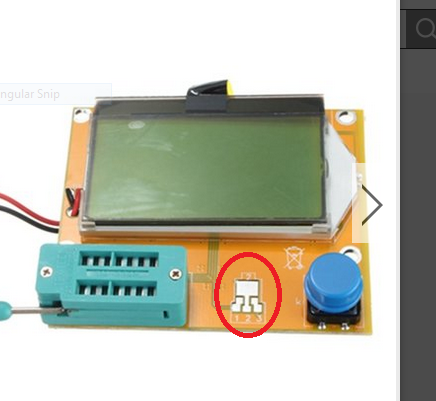

              "I have a simple ESR tester, selfmade, but want to sort SMD transistors that I have many of."
              I made up some special test probes so I could check SOT23 etc transistors. You need two small bits of Veroboard (perfboard, stripboard etc) , the solid undrilled tracks at the edge of the board. Or use some scrap of copper clad board. One probe has two 'tracks' on it, to probe on the side of the transistor with two legs, the other probe has just one 'track' . Wire three leads to the three 'tracks', and on the other end, use a header to plug into the tester ( a multimeter, in my case). Place the SOT23 device on a flat surface, and press the two probes onto the legs, so the tracks match up with the legs.
              I will try and add a drawing/picture later.
                my schematic is still live there http://pro-radio.ru/user/uploads/164242.gif
                  These Contacts are to test SMD.
