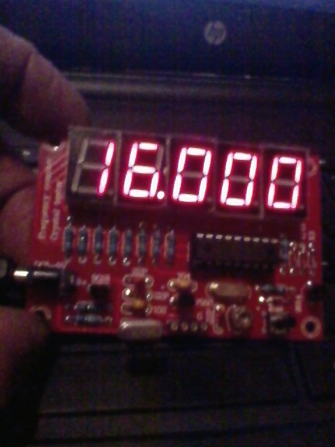

    Uses ? Not Much. LOL with only 5 digits it would be Ok for audio work but not much else. Built in Crystal Checker is some what worthless. Osc will not fire up with crystals less then 8 MHz as built. This can be fixed by increasing Cap Values in Osc.

        Counter works quite well with the 5 digit limitations. The Crystal Test Osc is Chit. You would need to put a switch bank piggy back board to cover better range. Yes it works. If you extended the Display off the PCB you could Box it and look cool. I'll use it or swap it off as barter material. LOL

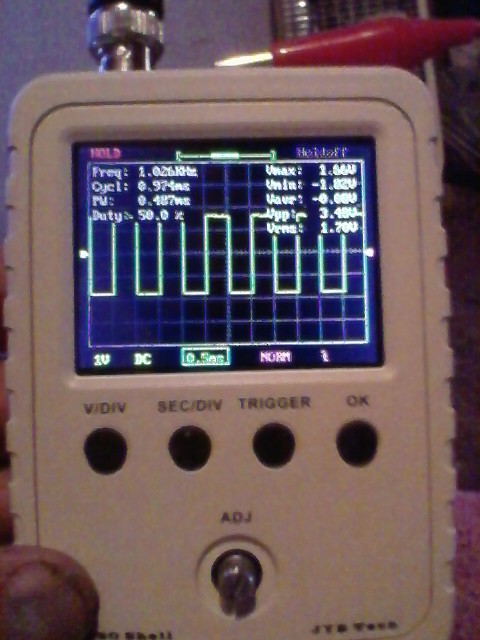

                    Being only single channel the DSO 150 can do quite a lot checking a detector but not any good to check phase relations. you can take a look at the over all timing on a PI step by step and see the receive signal decay. DO NOT measure strait off the coil. The DSO150 is limited to like 20P/P on the input. Handy for looking at your Sample Delay signal. The Freq Counter function is handy. It Can produce a 1K square wave test signal good for chasing audio issues. Good at letting you see noise issues on the signal train. For the Price $21.00 shipped here in the U.S. they are well worth it.
