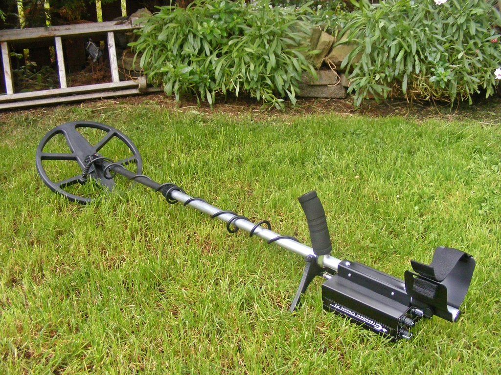

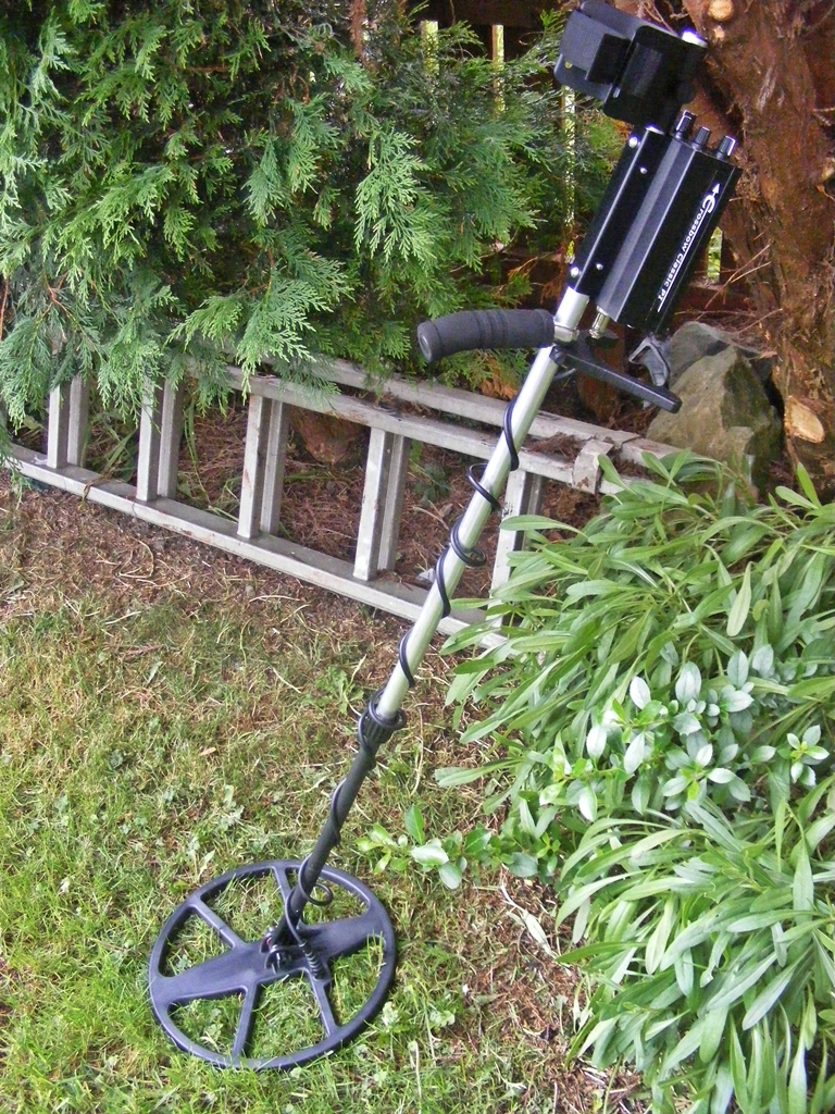

    this was my crossbow before i put it on to a straight shaft.

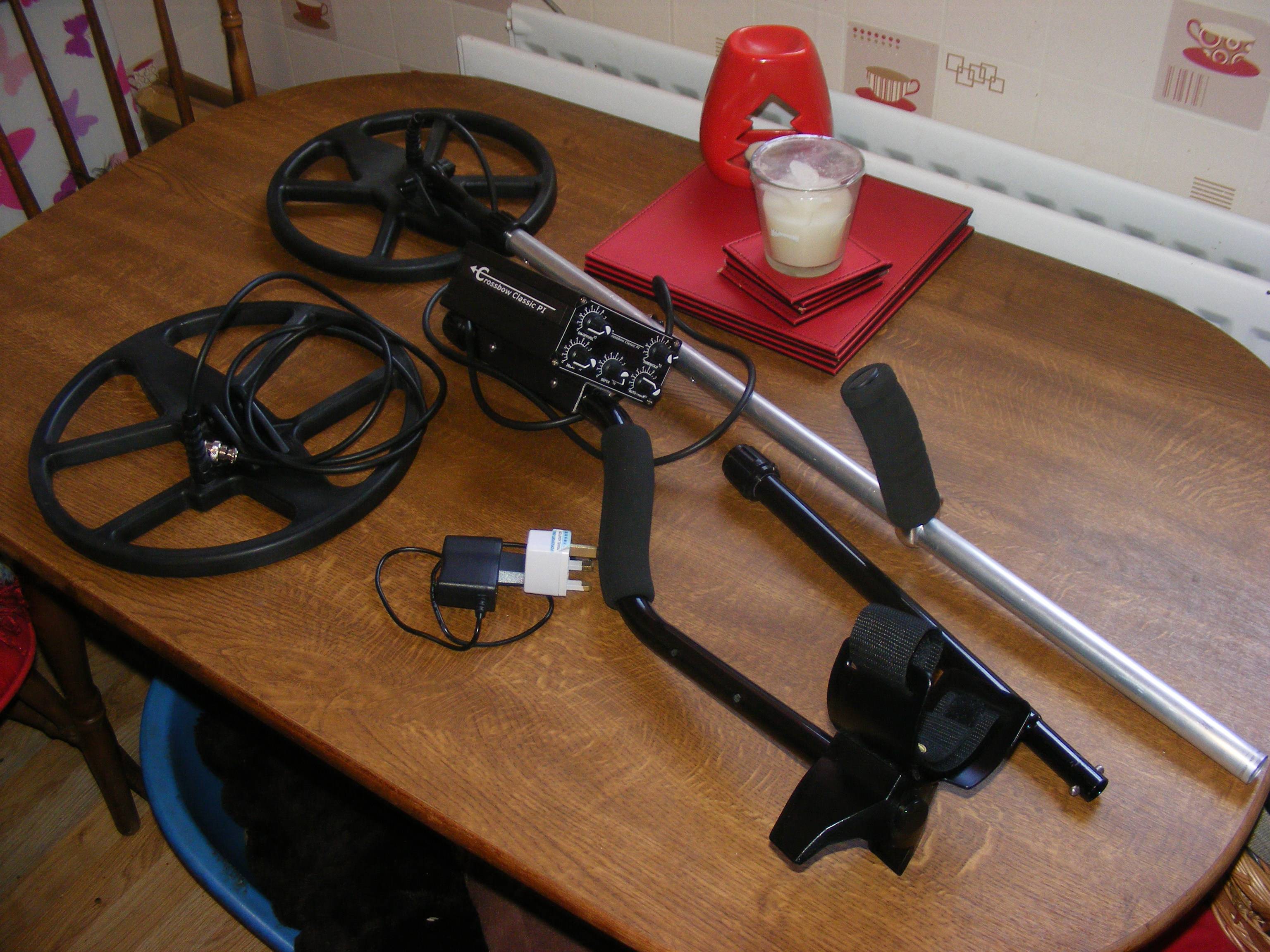

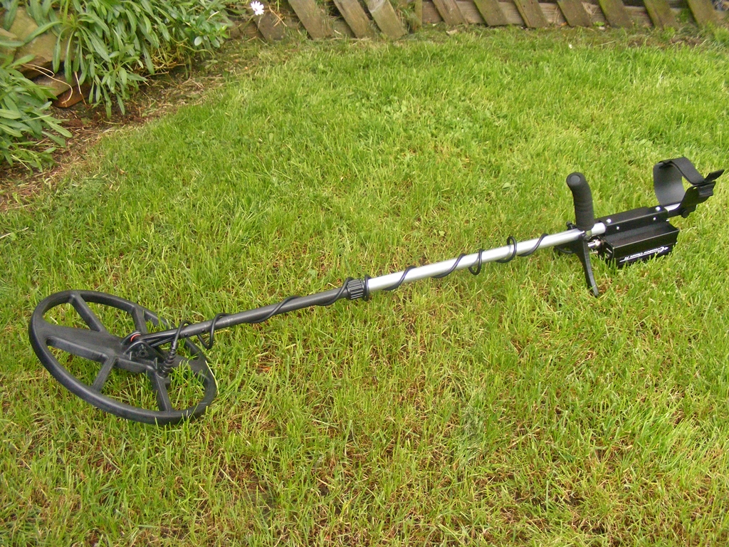

                photos re-added.
                  Originally posted by keith777 View Post
                  photos re-added.
                  Thanks for re-posting the photos.
                  This is not an original Crossbow Classic unit. It's a clone produced using an PCB design I sent to Sven.
                  The original had a battery check LED on the front panel, and you can see that's missing here. Also, the enclosure and the coil are different.

                        Since it's based on a PCB design I sent to Sven, it should have the same performance as the original. I've no idea how many clones have been produced, maybe Sven knows. I don't think there were many, as it's quite a complex design for many people to duplicate.
                        From the eBay photos, it looks like the battery pack was replaced by a larger capacity Li-ion type, and there were some other quite minor modifications.
