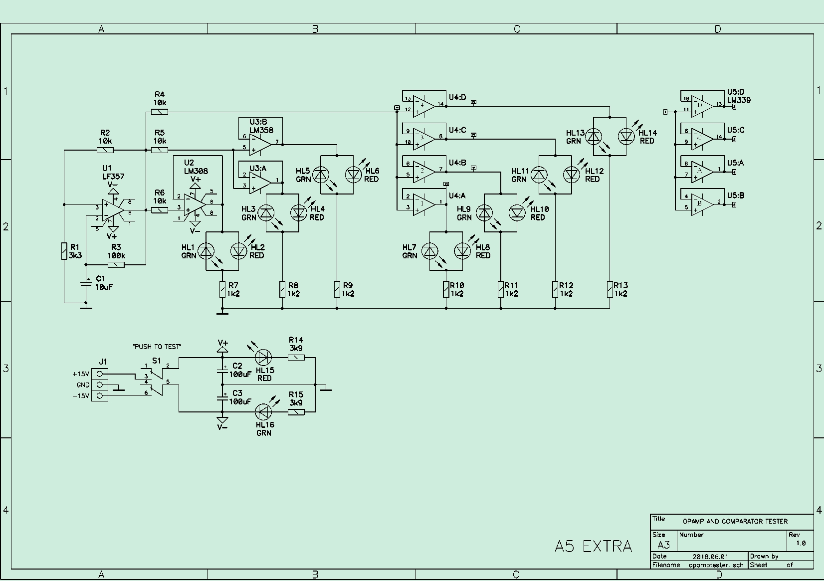

                            schematic is same just i increased a current through the LEDs to approx 10mA (with +-15V supply). i looked datasheets of opamps, noted limited output op-amp current is 30mA but sometimes there are not data. so 10mA is right and no run out of the max 30mA. with +-9V supply the LEDs current will be yet low.
                            batch of LF357 i checked and they are OK (good way - you can check a couple at once LOL). would check them in DP now.

                                this opamp tester i did much years ago. in 86 or 87 i do not remember. it was good time of Spectrum ZX80 personal computer
                                we made. certainly the spekky was not original, it was Zonov's schematic. i tested some opamps before to solder in the board.
