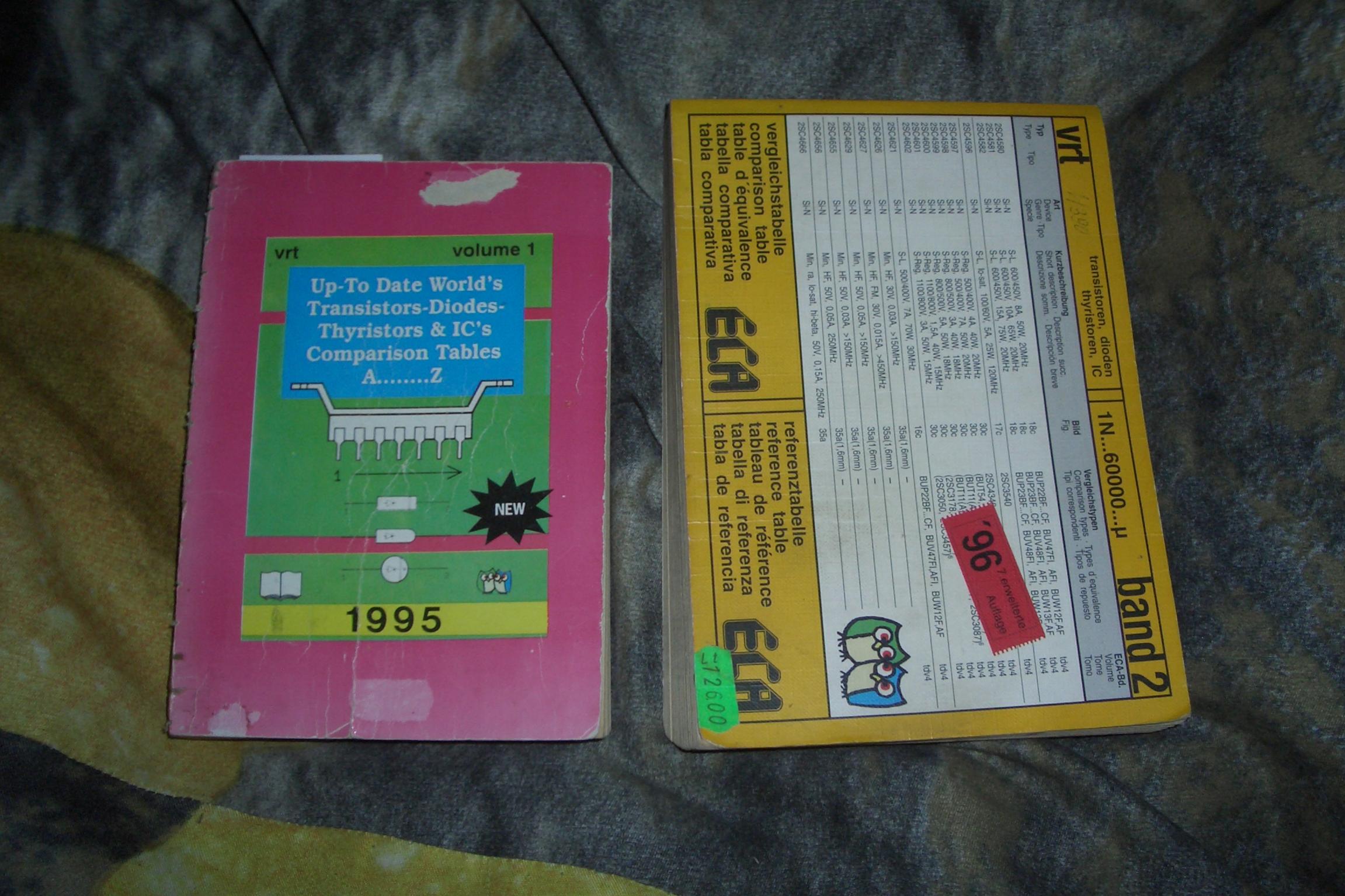

                            thanks but... your practic is poor.
                            i desolder/take the transistors from PCBs and i do not see another tipo in them. just only THAT manufacturer REALLY uses.
                            there are only 50-60 tipo, not more. not millions how you fantazy yourself. i have datasheets from 199x year and two fatty paper books if you think i am dumper.
                            my practic and experience is so much you did not see in a sleep.
                              It blows me off the chair
