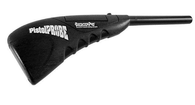

      A Detectorpro pistol probe. Need a casing upgrade as its fragile and flimsy, was thinking of making it longer or altering the shape, just wondering if chaning the search wires to the controls would make any difference to the performance. Looks a load of rubbish but performs very well as a PI probe.

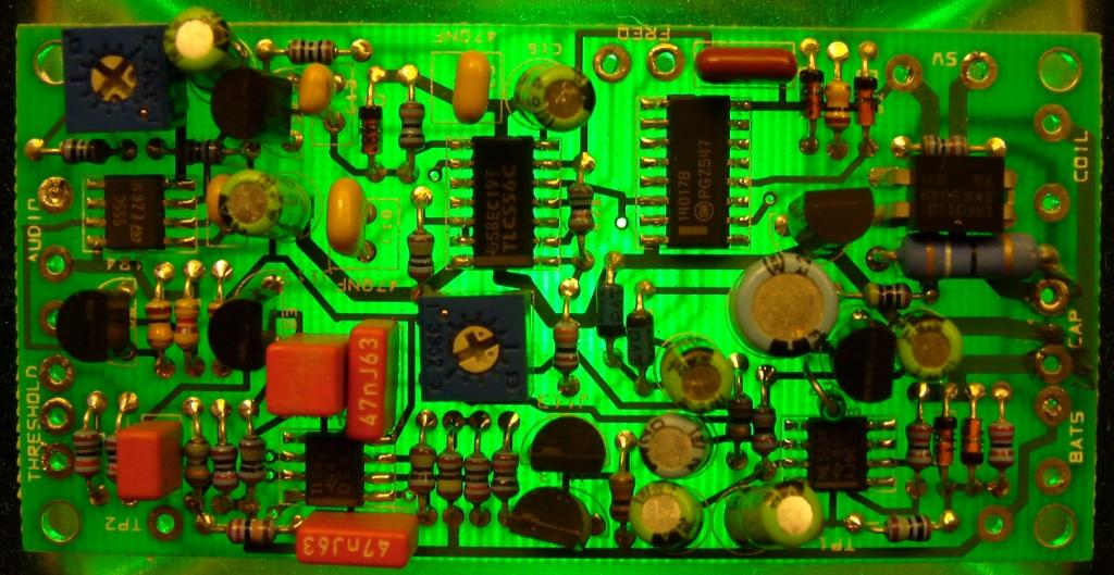

            Does the PCB inside the housing resemble this one?

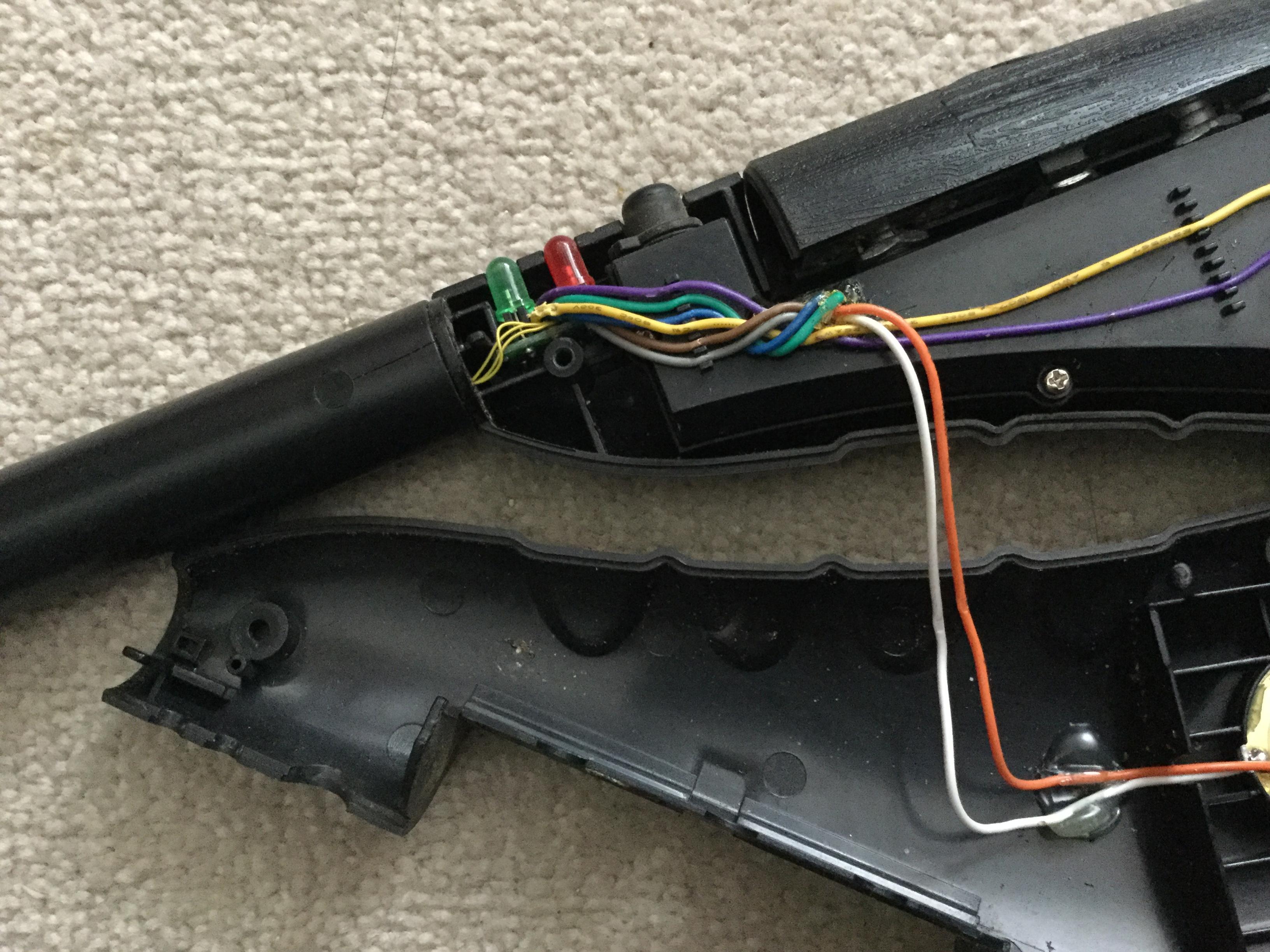

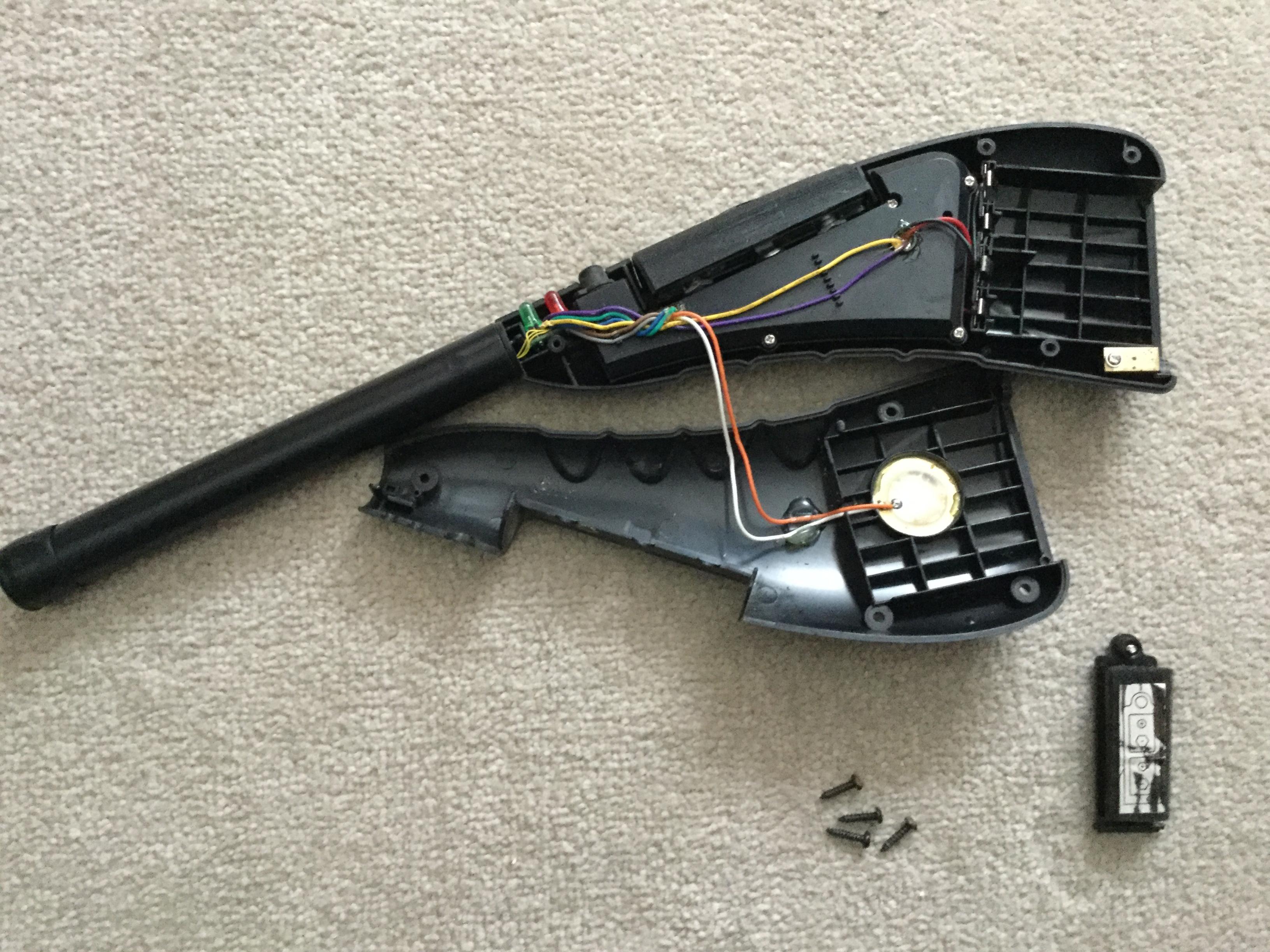

                I have taken the pro pointer apart without going too far as the wires are glued in which is a pain. I had a peak inside of the electronics but it?s hard to get the lid off and they are different to the picture. I noticed that there were very fine cables going to the Probe coil all the same colour. I also looked at the link, it didn’t show you much, only by what can be done only adding a cable to the coil wires, more about it looking like a gun than anything else. Still has that ugly triangle wedge on the end which would be more slim lined if the battery positioning was done a different way. Are there any other detailed links. It?s quite a delicate body as you can see a crack has formed in the cheap plastic at the Probe to body end.
                Anyone know what I would find inside the Probe, most probably glued in. Could I get one of these from a different source with curly cable of the shelf or get the parts to make one.
                  Typical of most consumer devices, designed to be assembled once and not ever taken apart.
                  Looks like the three fine yellow wires go to the sense coil. Guessing this is a center tapped coil wound on a ferrite rod.
