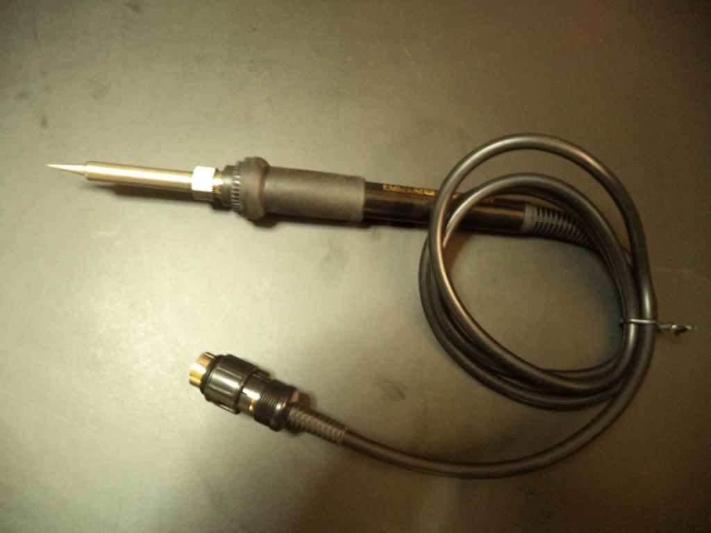

          Than i bought cheap Baku 936D. Poor design at handle, poor design at attaching the peaks.
          Most of all; poor peak quality. They simply taking a part after few hours of soldering.

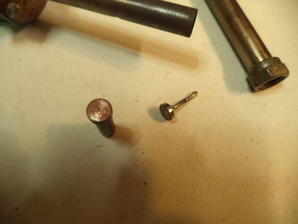

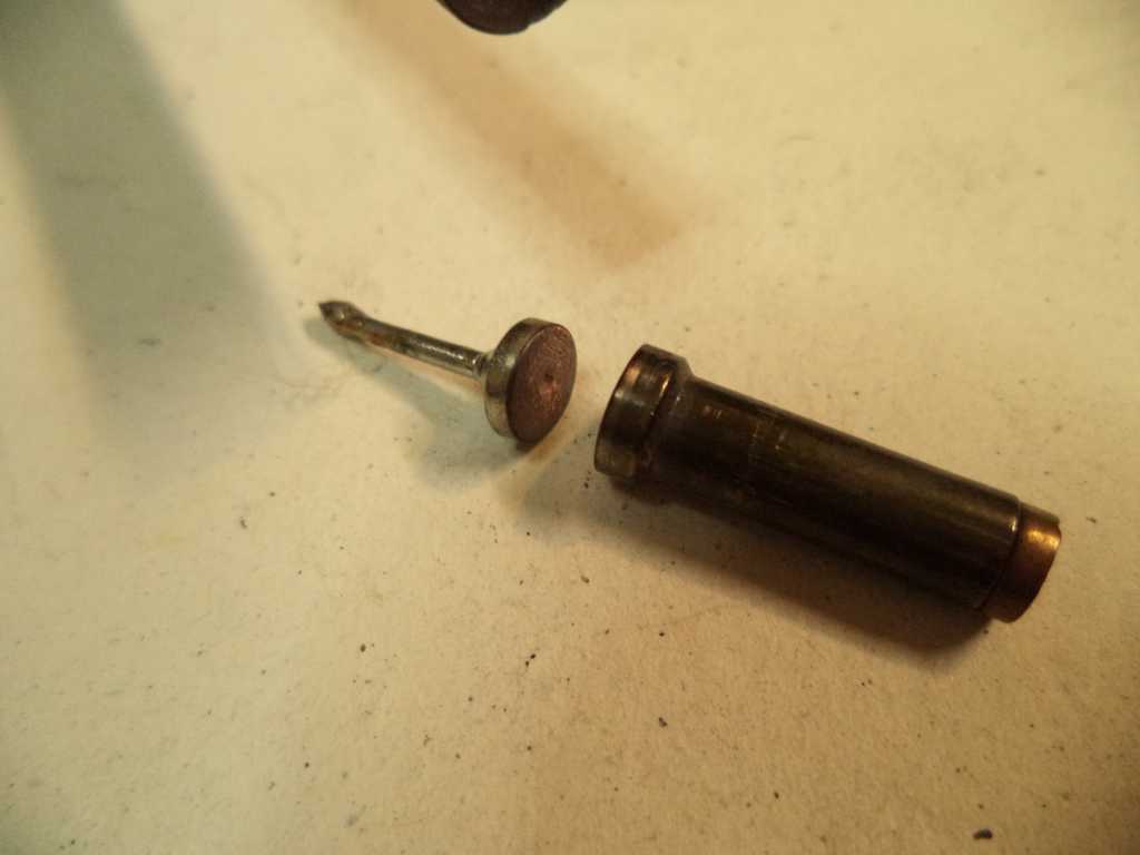

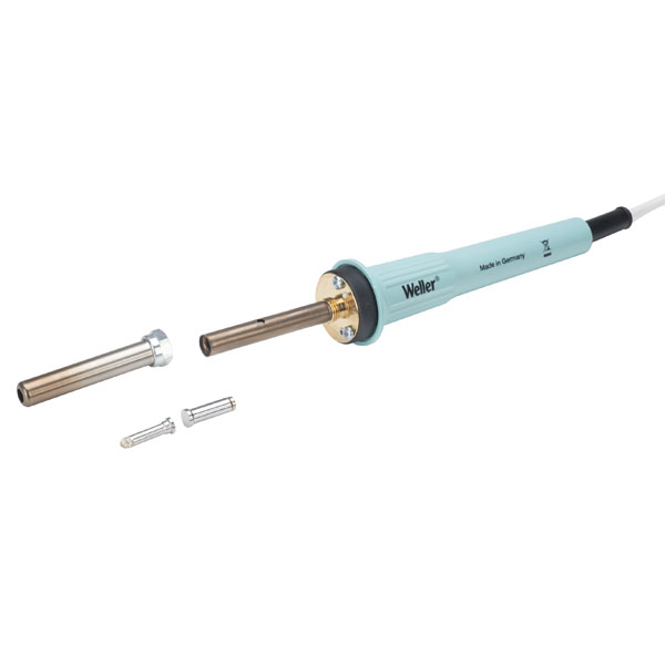

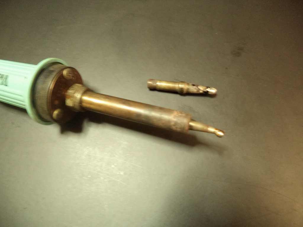

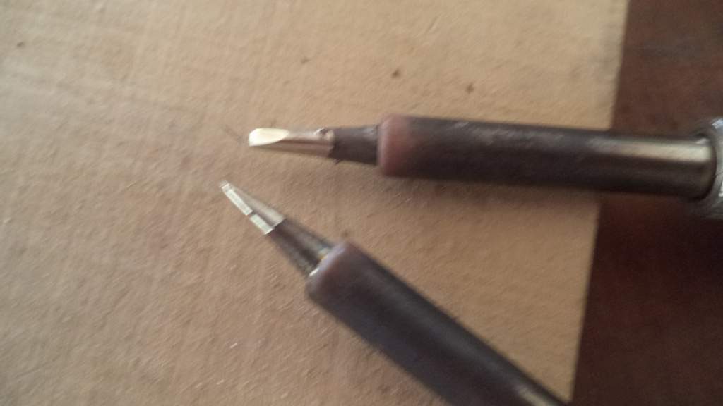

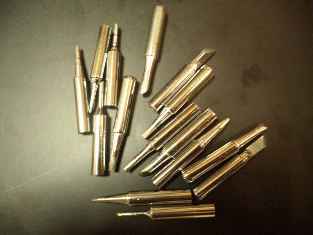

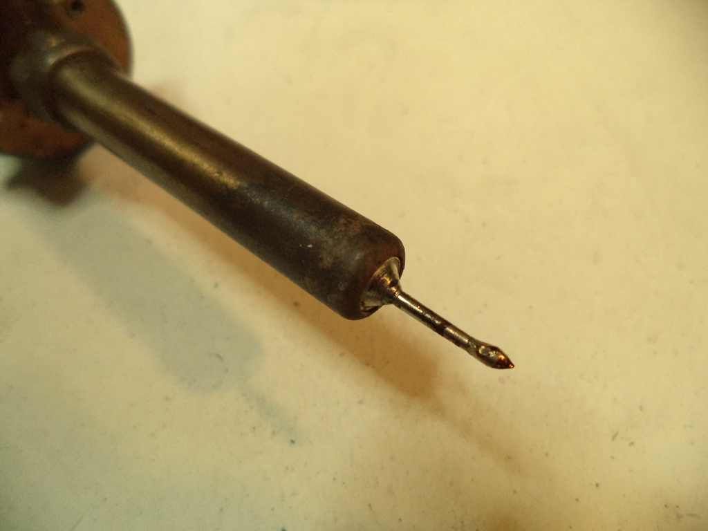

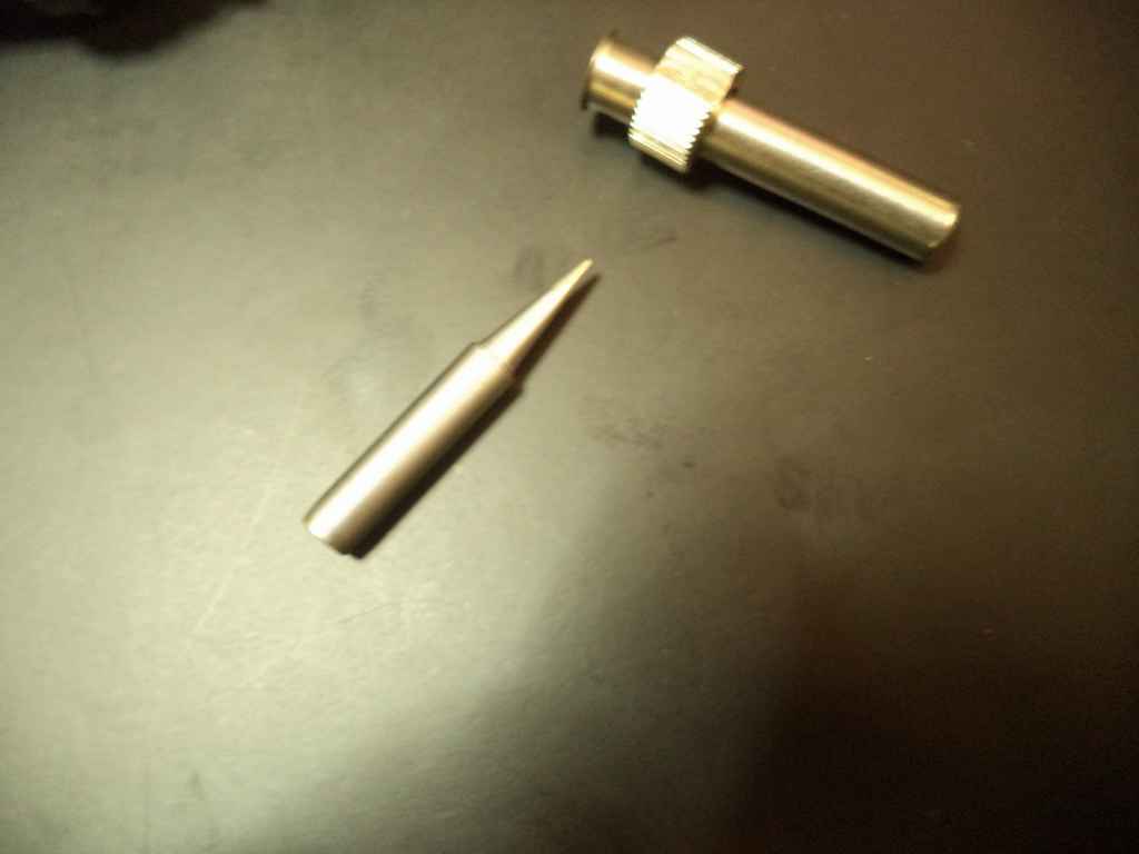

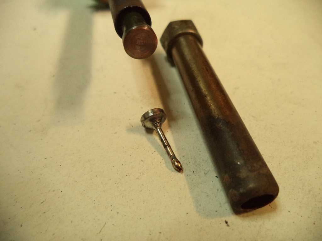

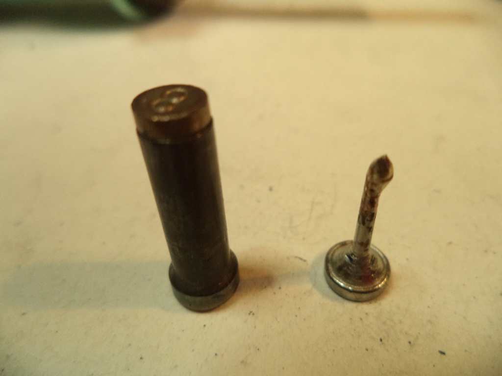

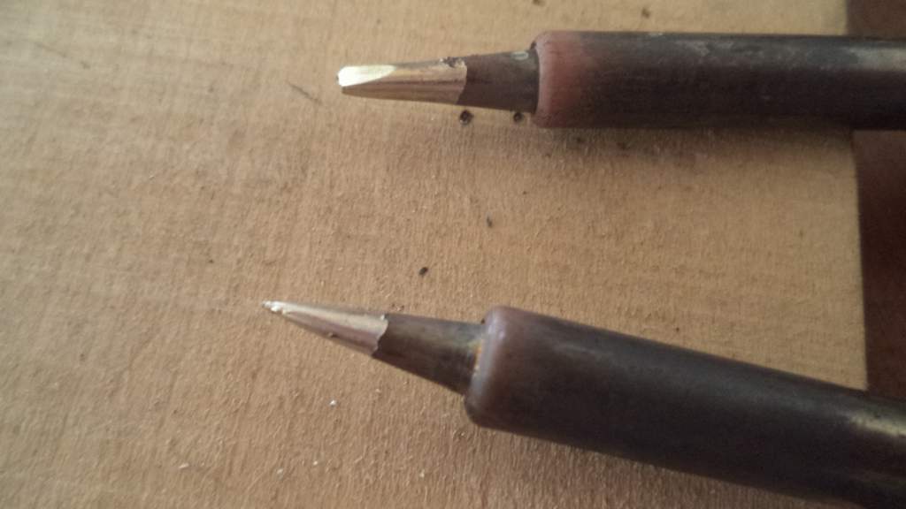

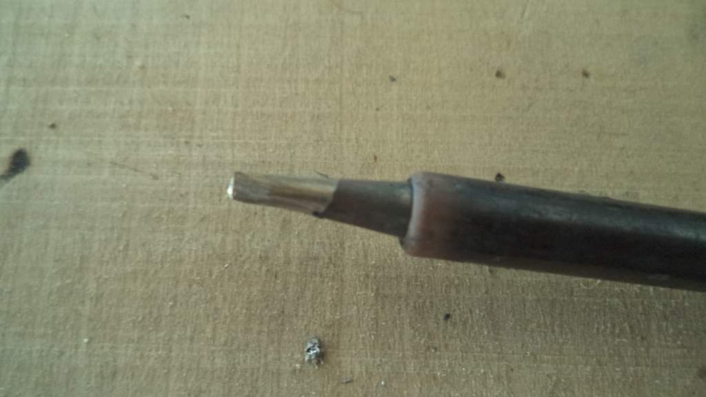

            Same history, im also was using Weller magnastat
            for over 30 years,from 1984, before i was using the 220 volt,
            one 25w and one 40w, at the crisis in Greece ,i have
            problem with the tips. then i bought also, this cheap
            Chinese soldering iron (hakko style)and i found out that it
            is garbage for me. ...EXCEPT ONE POINT , the soldering tips.

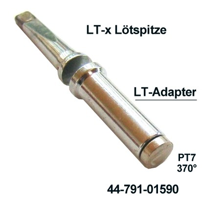

            they are better than original old Weller, the last years
            im cut these chinese tips with Dremmel , and the magnastat tips
            and make a cheap (not bad) solution for the Weller
            iron. WEller is using this solution to.

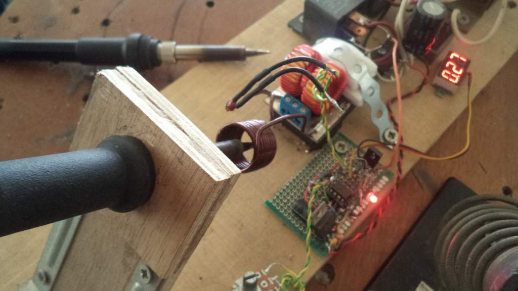

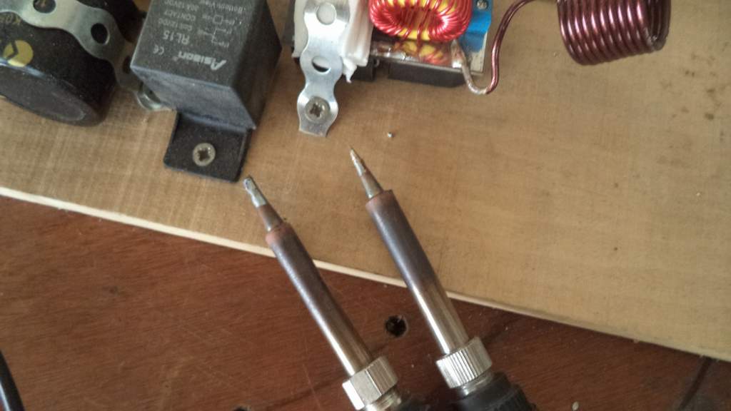

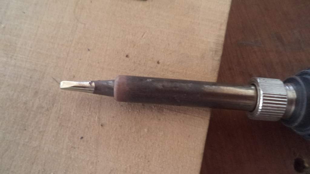

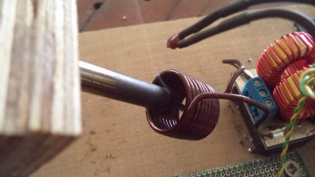

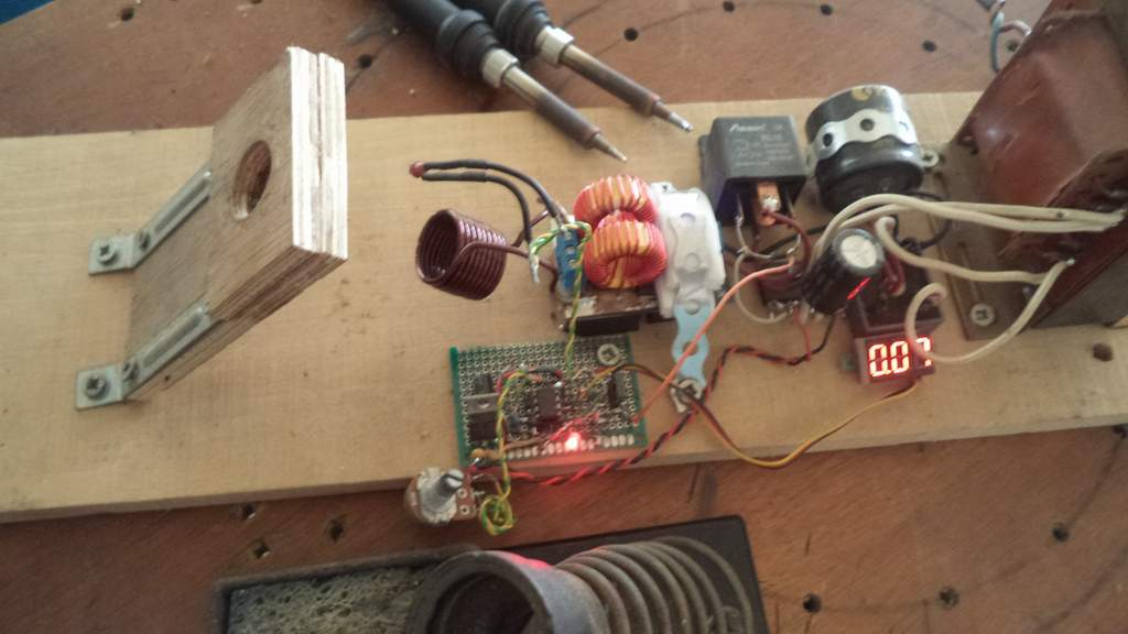

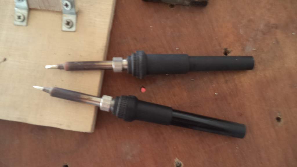

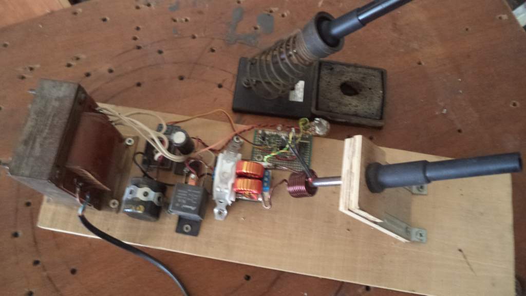

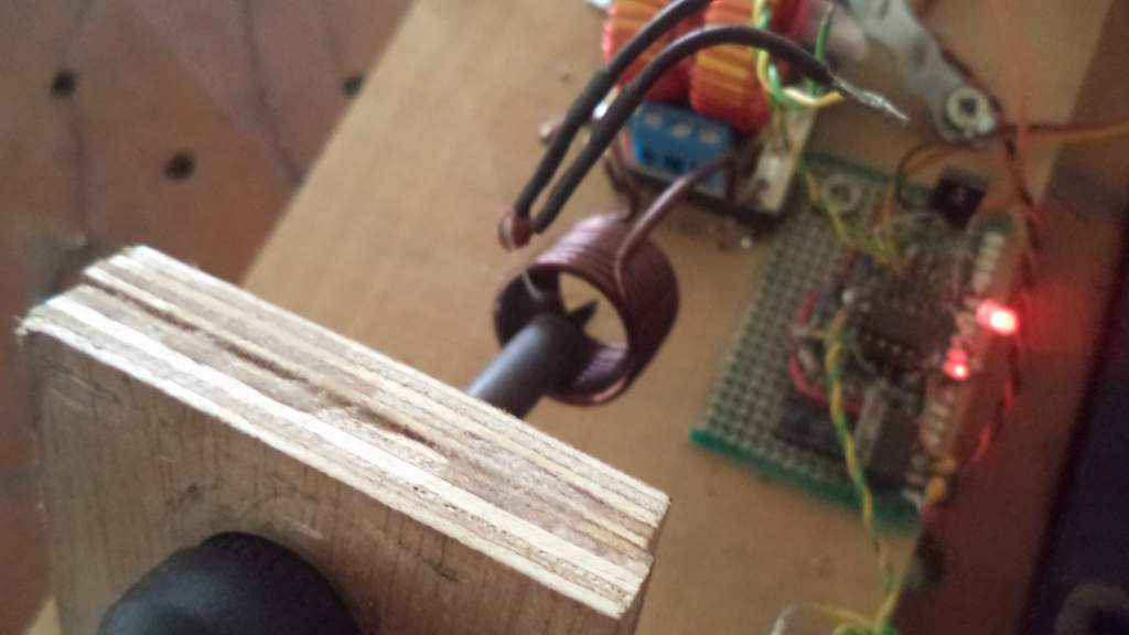

                  But now i think i have the best solder station of the
                  world ,and the cheapest, he he he, do not laugh,
                  TRY IT.
                  It is a makeshift construction, and no more permanent
                  than the temporary one. can be improved and made perfect.
                  im using this for the last 5 months , and working
                  better than ever, the little pcb doing nothing now.
                  it has to be improved to.
                  The BIG (little) secret is the cheap chinese tips are
                  made inside with iron , so the induction is working
                  perfect.

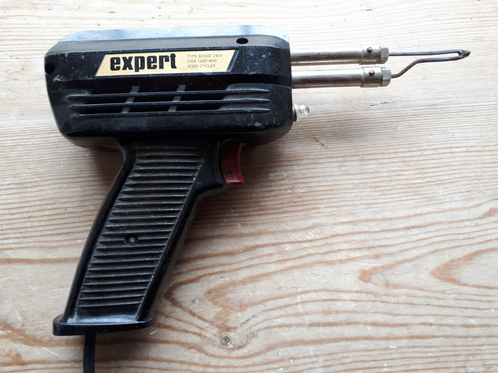

                        Just remembered that I still have an old working Weller Expert soldering gun, type 8200D, 100/140W.

                          Xtrem that's original idea, i must say that.
                          Induction heated tips!? ha!
                          I suppose you must act fast when soldering; because tip is getting cooler fast?
