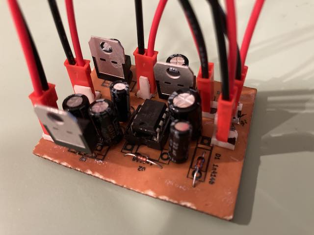

    I have been working on the Hammerhead PI, but I am not using the provided PCB. I have been designing and building each section on a separate PCB (I use KiCad) so that I can fully understand how each section works. Also it lets me re-use sections in later designs. Eventually I will combine all the sections back into one PCB.
    Unfortunately I am not very good at making PCBs. Printing and etching is never a problem, but I can never seem to keep the top and bottom layers perfectly lined up.
    Today I did a double sided PCB for the oscillator but realized I could not easily solder it because the holes are not thru plated, and the top and bottom layer are slightly off again. I can't solder a chip socket on the top side of the PCB : (
    Maybe I will just send the gerbers out to a PCB shop instead!
    What method are you using for prototyping circuits?
    thanks
    The silk screen on this one is not good!

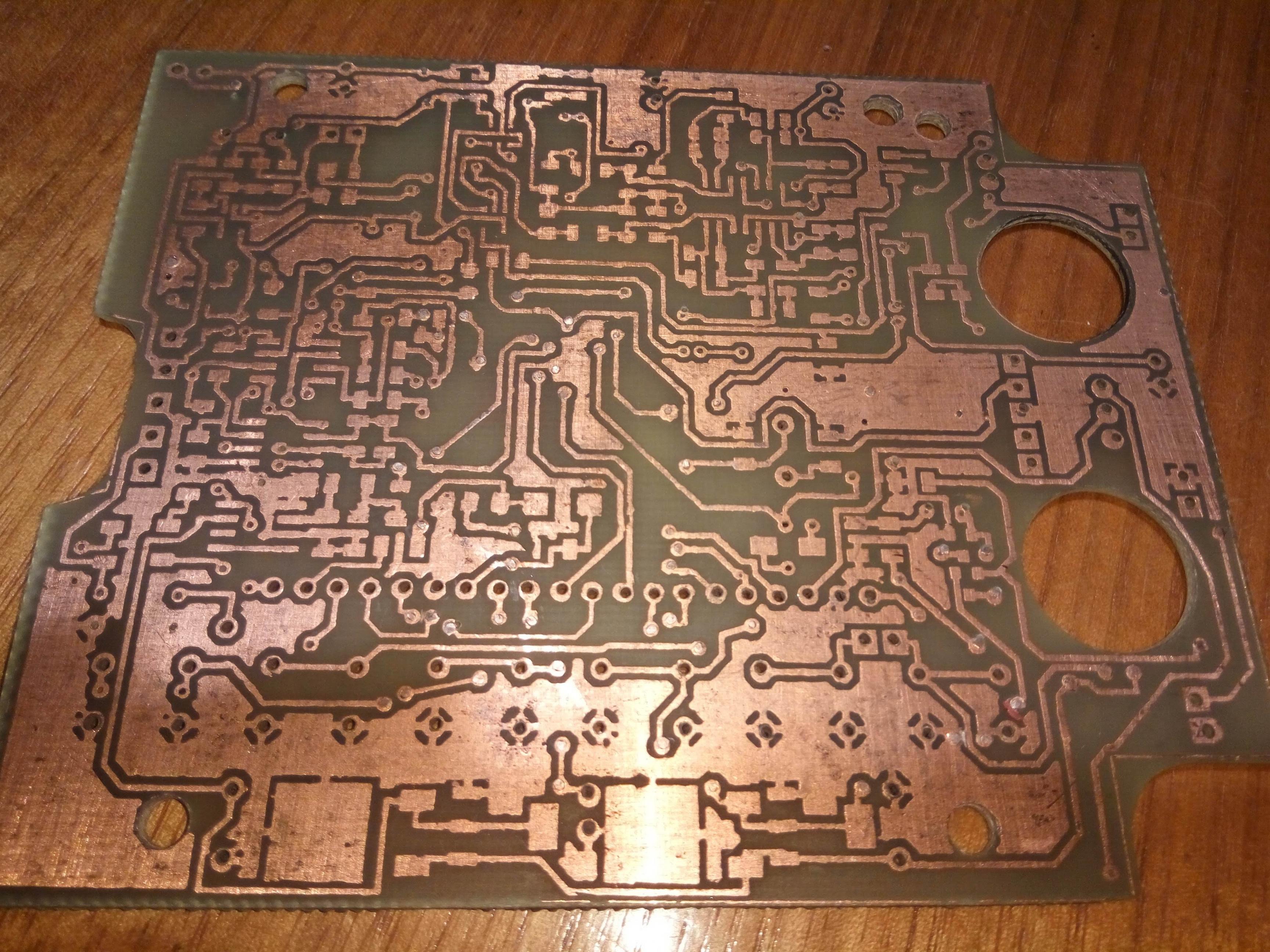

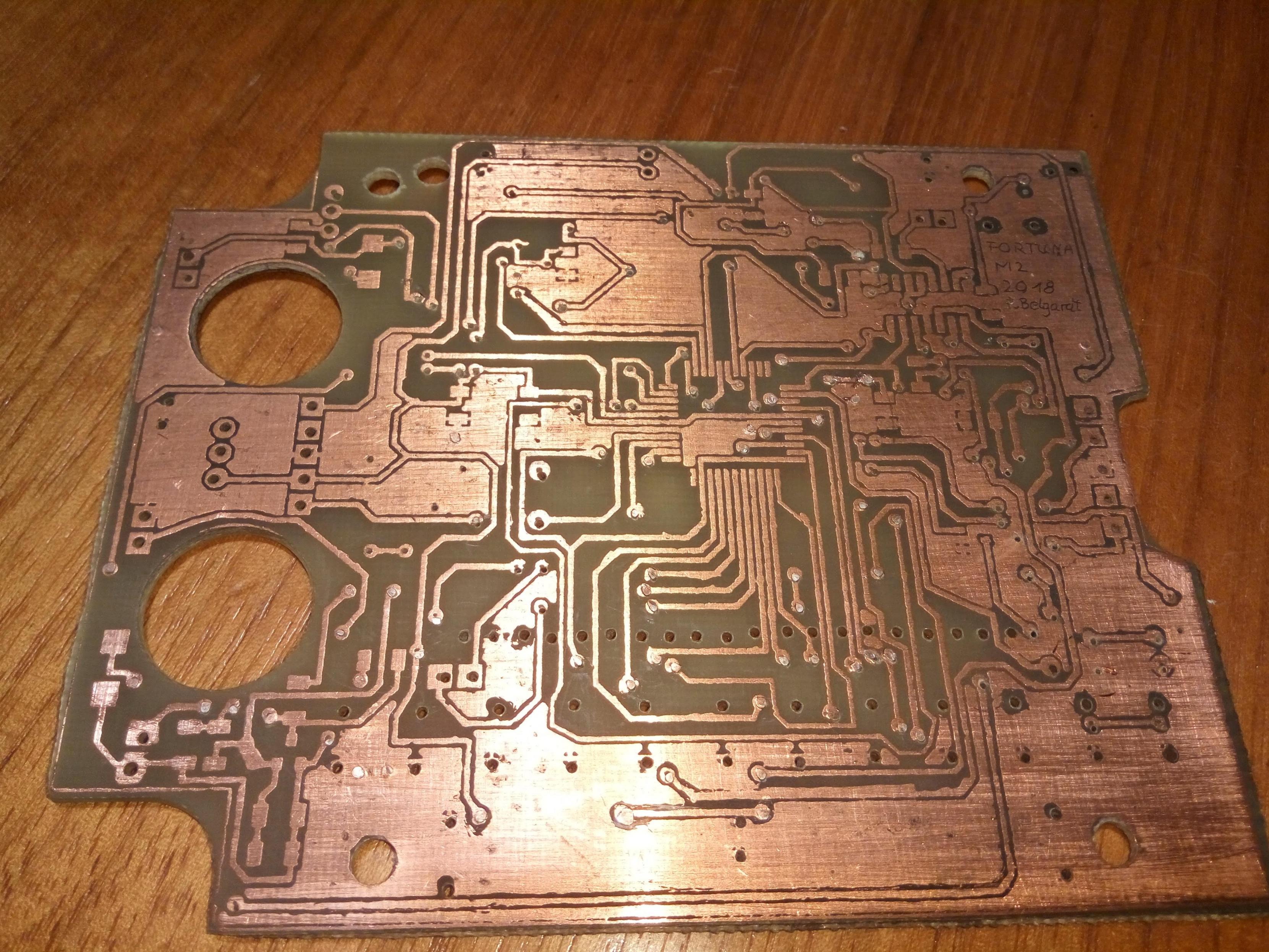

                  Here some pictures of my most demanding double sided pcb prototype. But anyway a good lesson..

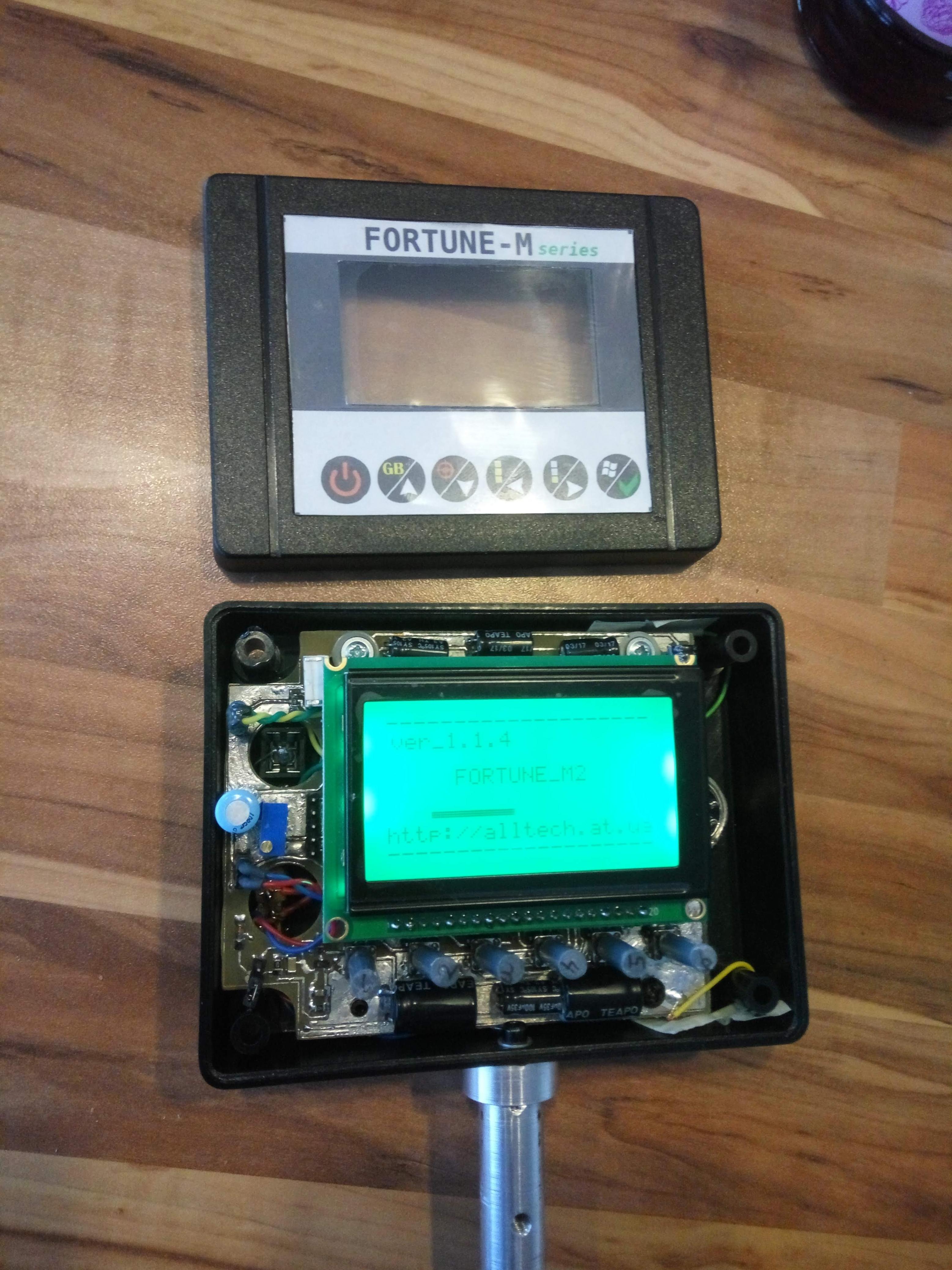

                  After many hours...

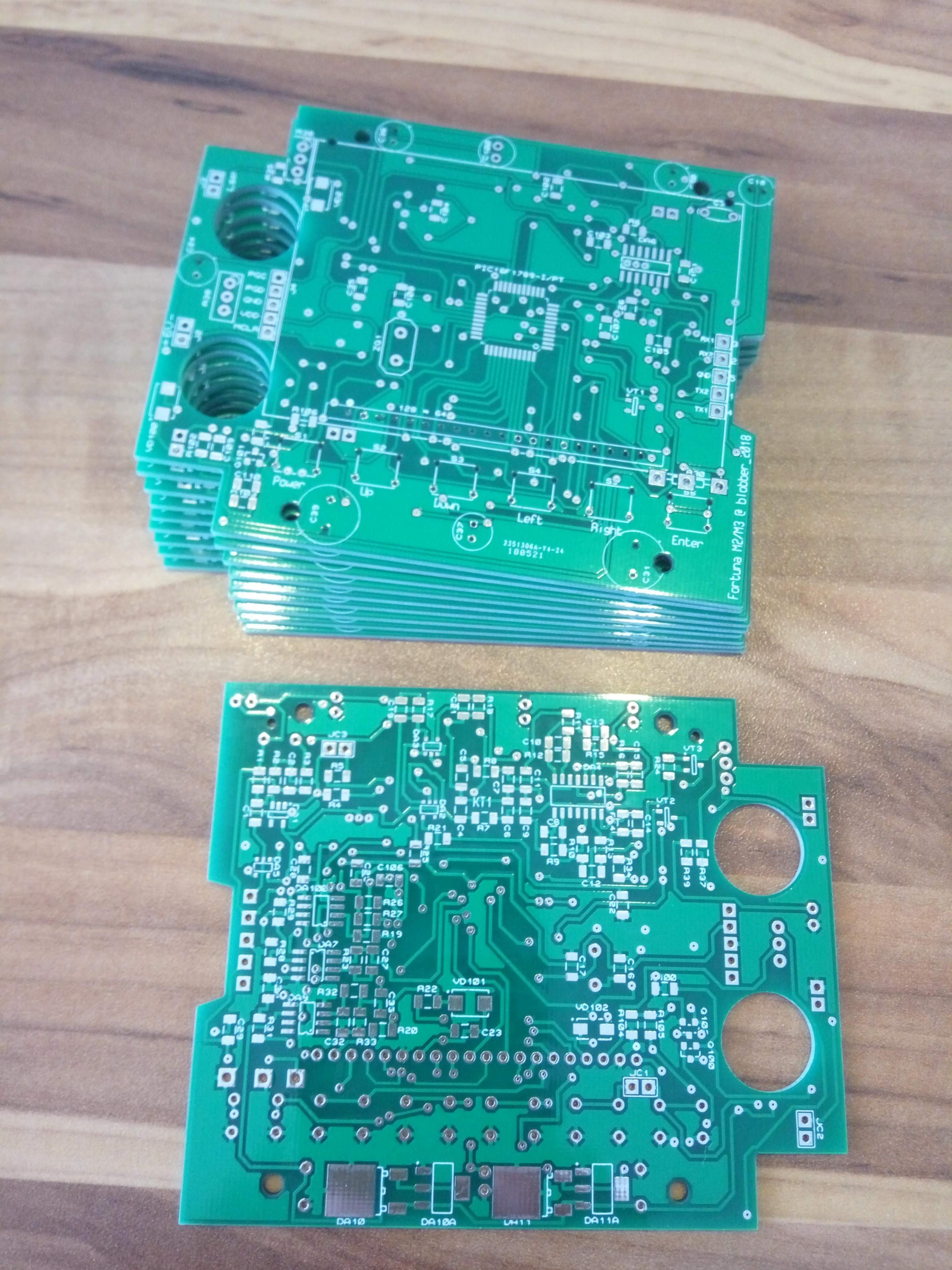

                  ..later when I was sure, to have a working unit, I've ordered some pcb on jlcpcb
                  I think, I would do it again in this way.
