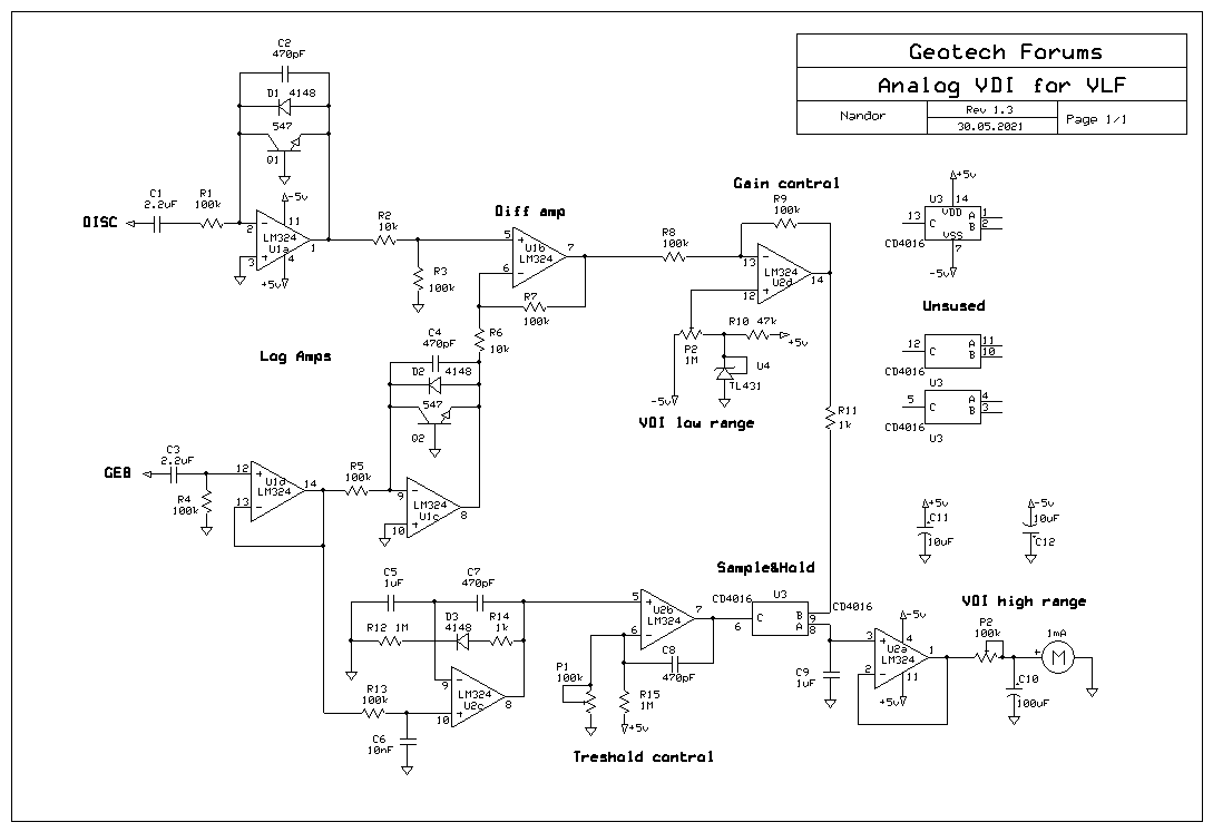

    Not many days ago I have found an interesting little schematic, it's a VDI VCO.Click image for larger version
    Here is the VDI schematic, it has some errors but the pcb lay file is ok!Click image for larger version
    best regards!

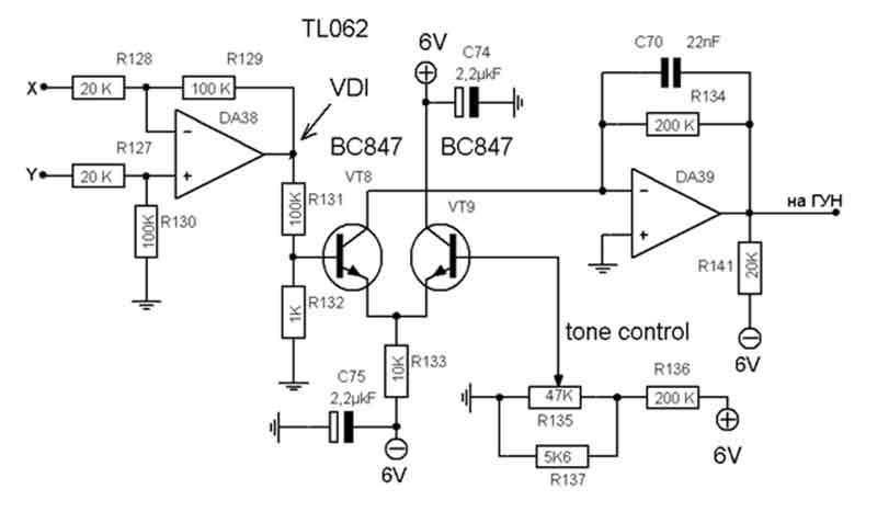

      • Well, you *could" use the VDI that is on this sight, and instead of driving the display, use the DAC to drive an analog meter..... The whites works by using a logarithmic opamp for each channel, and then subtracting the results with an opamp. Subtracting two logrithms from each other, is the equivalent of dividing one by the other. So the x and y channel values get their logarithms computed. This is done by a matched pair of transistors, where one transistor is in the feedback of the two opamps. The transistor has a logarithmic voltage response, and generates a log amplifier.
