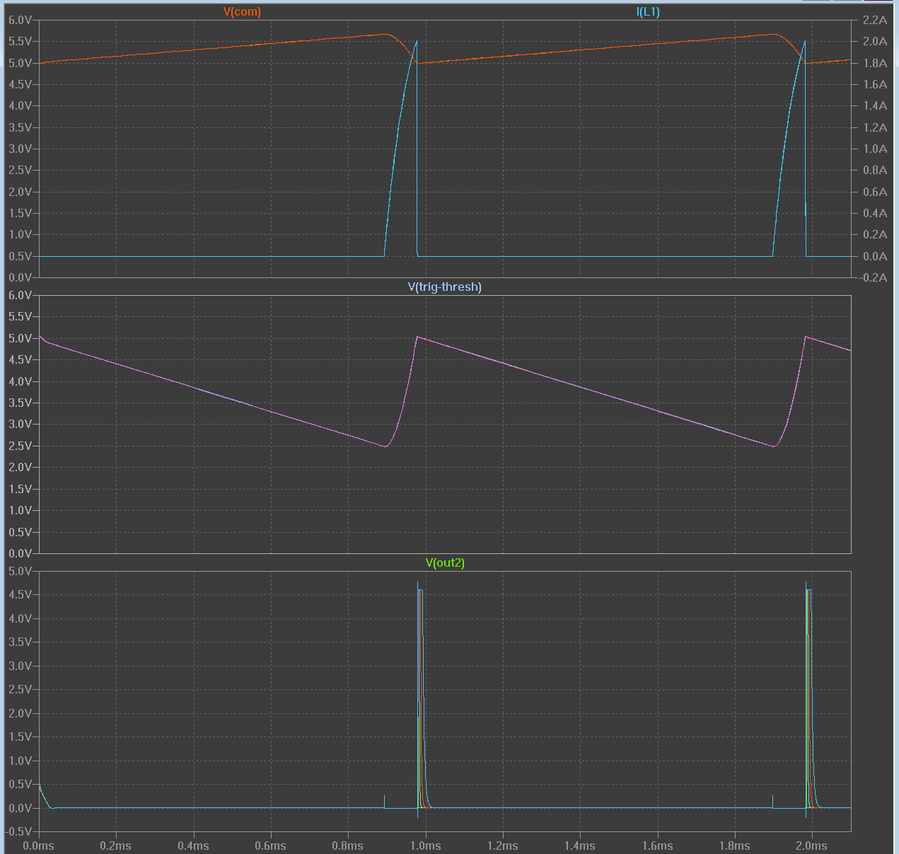

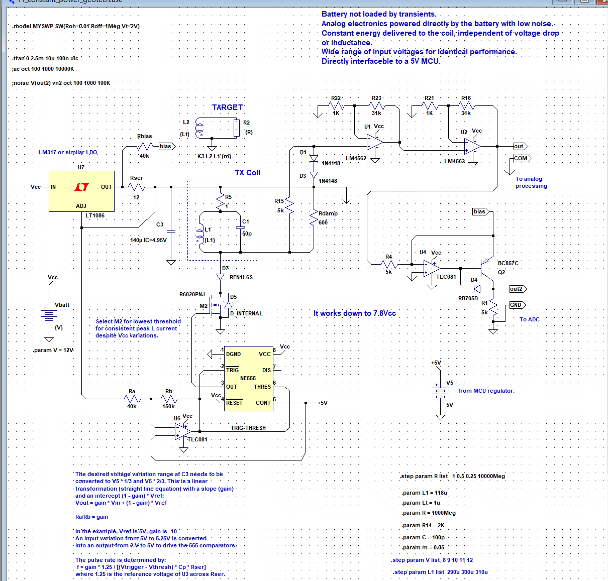

    I want a PI that can drive the coil headed exactly at the same power throughout the battery life. Why? Because a normal PI draws the high tank current peaks directly from the battery, and as the voltage and peak current go down so does detection depth. I want consistent performance at the max till the battery gives up really bad.
    So I went into invention mode and I came up with this thingy that charges the coil to exactly the same high current value at a constant pulse rate even when the battery is so weak that it can barely deliver 100 mA. The peak coil current and pulse rate are not affected by the battery voltage or its discharge capacity. As a bonus, a wide range of battery voltages can be used.
    The basic idea is to have a constant current source I charge a large capacitor C. When the cap voltage reaches a given level VH the cap charges the coil, when it falls to a second level VL the MOSFET fires the coil. The voltage at the cap rises to VH at a constant rate (linear ramp) then drops back to VL during the coil transient, but only a small step about 0.5 V.
    The cap transfers a constant energy value (VH - VL) x C ^2 to the tank.
    The pulse rate is constant and determined by I, C, the discharge transient time Tdis time and the reference levels VH and VL: PR = I / ( (VH - VL) x C ) + 1 / Tdis.
    Traditional PIs usually require additional voltage converters to create voltage rails above and below the battery voltage in order to feed the analog circuits (see the +5V and -5V in MPP for example.) This thingy does away with that because it uses the cap voltage as the analog ground. We then have three steady voltage levels: battery+ with no glitches because it's feeding a constant current, battery GND and a relatively slow moving capacitor voltage slowly ramping up and down about half a volt around the middle of the battery voltage. Power source noise is dealt with by eliminating rather than adding components!
    The analog circuits, e.g. Op Amps have their power terminals connected to battery+ and GND, with the virtual ground being provided by the cap. This means a changing common mode for the analog signals (VH - VL) at about 1 kHz, but modern Op Amps having a CMRR (common mode rejection ratio) well over 100 dB, the common mode noise will be far below the signal noise.

              I also set myself the goal of stabilizing the coil energy regardless of the battery charge level. The easiest way was to use a boost converter. It works very stably and reliably.

                  The boost converter is a solution for existing designs. My goal is to simplify the total design minimizing the number of (noisy) voltage converters - especially the pesky ICL7660's.
                  The NE555 is an excellent MOSFET driver and has all the additional elements to control both the coil energy and the analog ground rail with the assistance of an op amp. In discrete designs it reduces the monostable count and no regulators are required, just a voltage reference for the CONT pin that can be a 4.7V zener.
                  As a front end for an MCU it provides the amplified signal referenced to battery GND and reduces the timing overhead, just add a 5V regulator for the MCU if not using a cheap board like Arduino Pro Mini of Adafruit Trinket that already includes it.
                  I'm now trying to attach an Attiny85 for signal processing and audio synthesis.

                              Thanks for the fresh ideas Teleno.
                              How do you look at this, what if we exclude lm317 constant current source (as badass energy eater) and instead use analog feadback loop to regulate NE555 TX pulse width.
                              This may help to keep current constant during battery discharge.
                              But, i see, with lm317 positive voltage raill will be less spiky.
