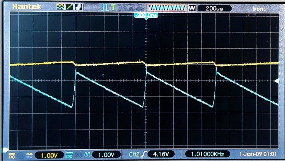

                    I had a better capacitor at hand, not really great with an ESR of 0.15 Ohm but the results have vastly improved.

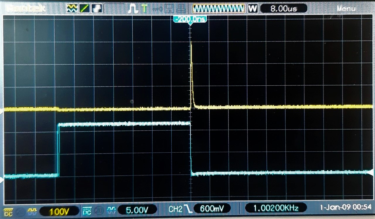

                    It's only 150uF of the 220uF that I need. That's why the flyback is only 300V (Coil is 188uH / 210pF / 2.1 Ohm. Rdamp = 390 Ohm).
                    Still it looks like this PI circuit is feasible. The signals now are very close to the simulation.
                    Vbatt = 12V.
                    The gate signal (blue) output by the 555 is sharp and clean.
                    Yellow is the floating ground (the voltage at cap C3).
                    Blue is the outpout of U6 that controls the 555.
                    The period can be neatly adjusted to 1KHz.

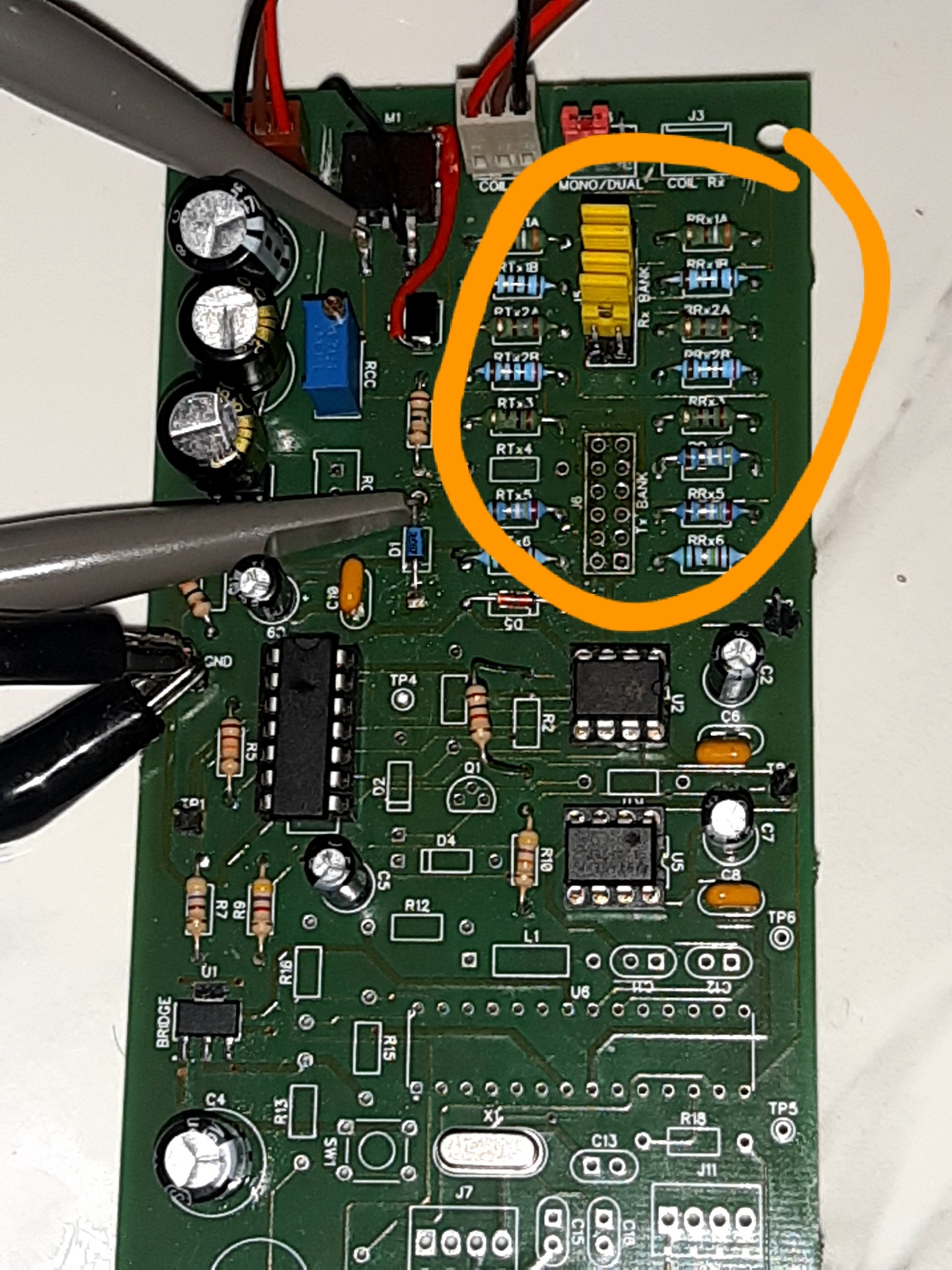

                              The amplifier output is at odds with the simulation and can't figure out an explanation.
                              In the sim, the transient decays to 1mV within 6 usec, but the real circuit takes over 80usec. Why the huge difference?
                              The following is the output of a a two-stage amplifier with gain 2 x 25 based on a fast LM4562.
                              Coil parameters:: L=188uH; C=220pF, Rser=2.1R
                              The damping resistor is the theoretical, 450R. It's implemented on the PCB as a switch-configurable bank of metal film resistors connected in series and scaled as multiples of two: 400, 200, 100, 50, 25 and 12.5. Miniature bridges on the PCB short sections of the bank to obtain the desired value. See top right on the PCB:
                              My first thoughts about what's going on:
                              - parasitic inductances/capacitance of the resistor bank and its PCB traces.
                              - lower actual gain of the opamp the mV range of the input stage. Notice the feedback loop includes the damping resistor, see schematic.
                              -fake op amps, though I've tried an TL072 and an NE5532 with exactly the same results. Surprisingly, the lowest noise was measured in the TL072.
                              I would appreciate any insights.
                                I have found that simulations do not take into account how long the op-amp take to recover from saturation.
                                Both the 072 & 5532 take 10's of usec to recover when their outputs are driven into the rail Voltage.
