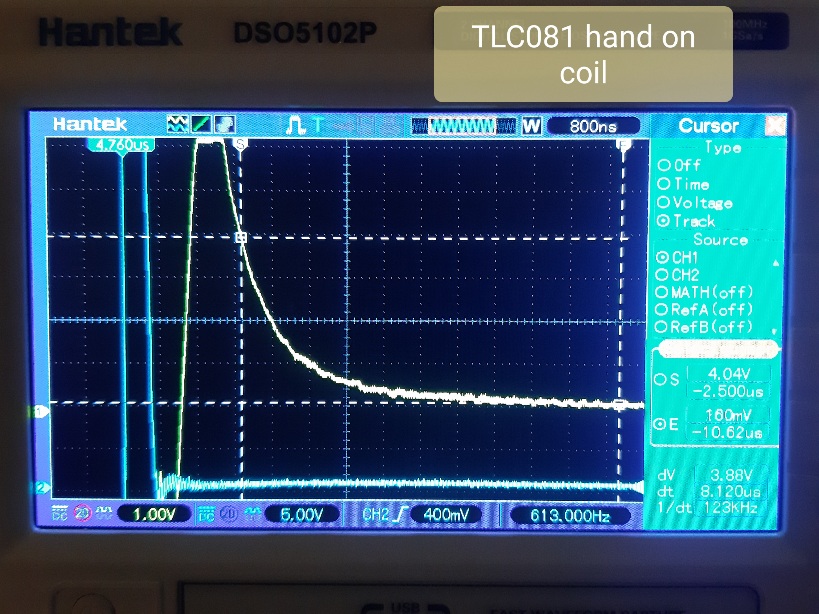

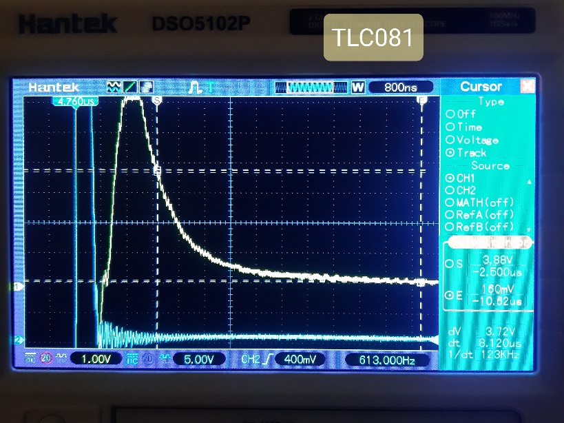

              The PCB layout is always a suspect but a finger on the non-inverting pin didn't affect the ringing. A finger on Rdamp does though. I suspect the true cause is a secondary resonance mode in the coil, but first I had to test the feedback theory. If true, then the 12 MHz ringing should be gone if the wideband Op Amps are replaced by slower types. I used the TLC081 ( 10 MHz GWB) as UC1 in the schematic with the following results:
              Preamp output (b in the schematic):
              Preamp output with hand next to the coil:
              Even without "handing" all the periodic noise is practically gone. The preamp is still fast enough to sample at 2.5 us. Responsive to my 0.2 g test gold nuggets.

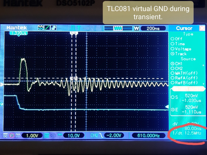

              From this it would seem that the feedback theory was correct... but then I looked at the virtual GND during flyback and I caught the 12 MHz oscillation still hanging in there!
              Virtual GND during flyback:
              The bandwidth of the TLC081 is unlikely to afford a 12 MHz ringing, but just to make sure I tried a TL071 (5.25 MHz GWB) with similar results at the virtual GND.

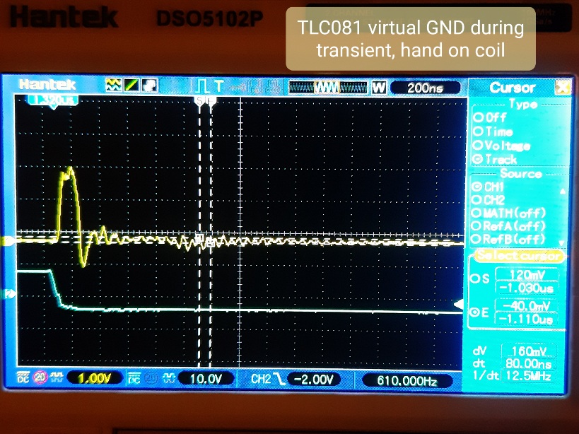

              Again, the hand makes it go away.
              Virtual GND during flyback (hand next to the coil):
              From all of the above the following causes can be discarded: EMI from nearby appliances and positive feedback in the preamp.
              It is apparent to me that the 12 MHz ringing is coming directly from the coil either as EMI fro a transmitter (unlikely) or as a secondary resonance mode of the coil.

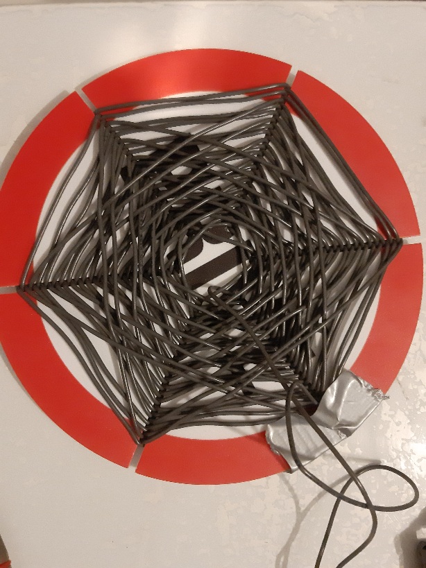

              The latter seems the real culprit because if you look at the back side of the coil it looks like this:
              I guess all those crisss-crossing strides of different lengths are behaving as coils within the coil causing higher resonance modes (additional poles in the impedance spectrum).

                      Looking at your coil, I see that your using plain wire for the coil leads or cable.
                      How long is the cable? Could the the 12Mhz come from the cable?
                      Did you try to twist the cable?
                      Did you try with coax? single coax, or one lead of the coil using a coax, the inner wire being the coil lead, the outer wire connected to the shield. The other lead, inner wire as lead, outer part of the coax connected on the one side to the ground on the TX board, the other end left free, thus being connected as a shielded wire.
                      For the shielding I like to use 3mm to 7mm PVC foam sheet, painted with graphite paint. The thickness of the shield serves as spacer between the coil wires and the graphite shielding. A thin wire embedded in the graphite paint connects to the outer coax.
