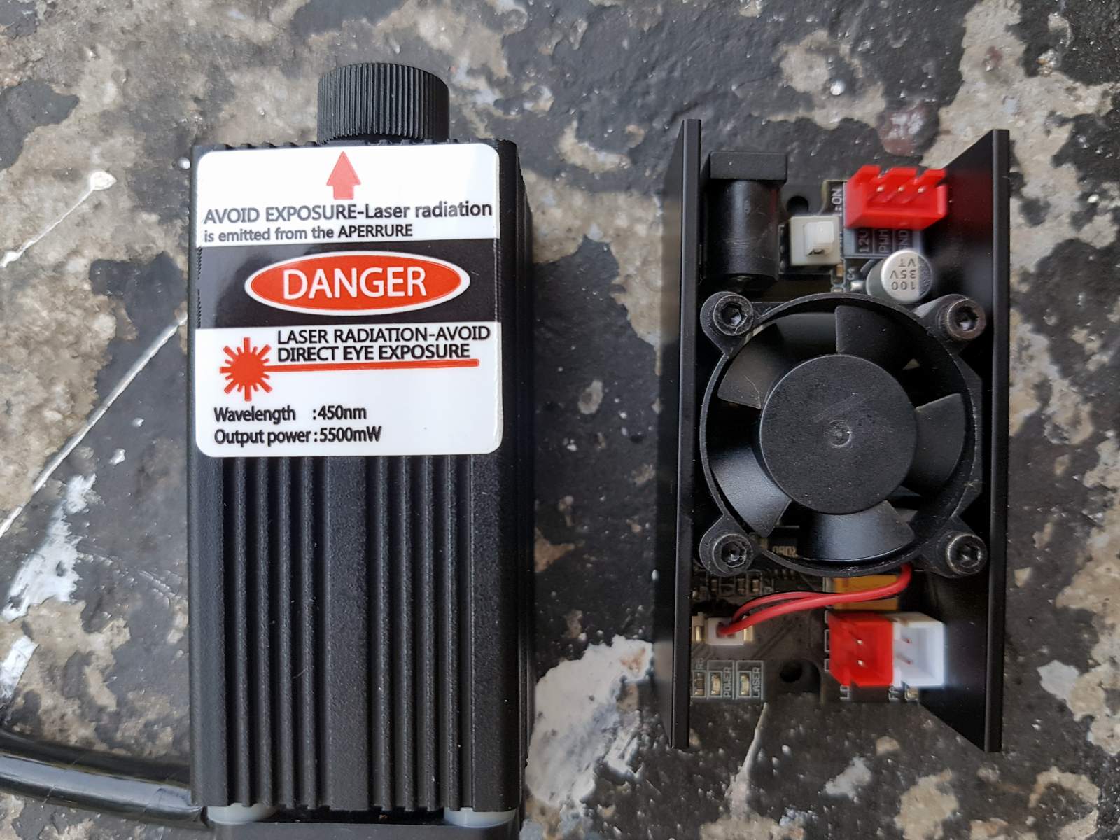

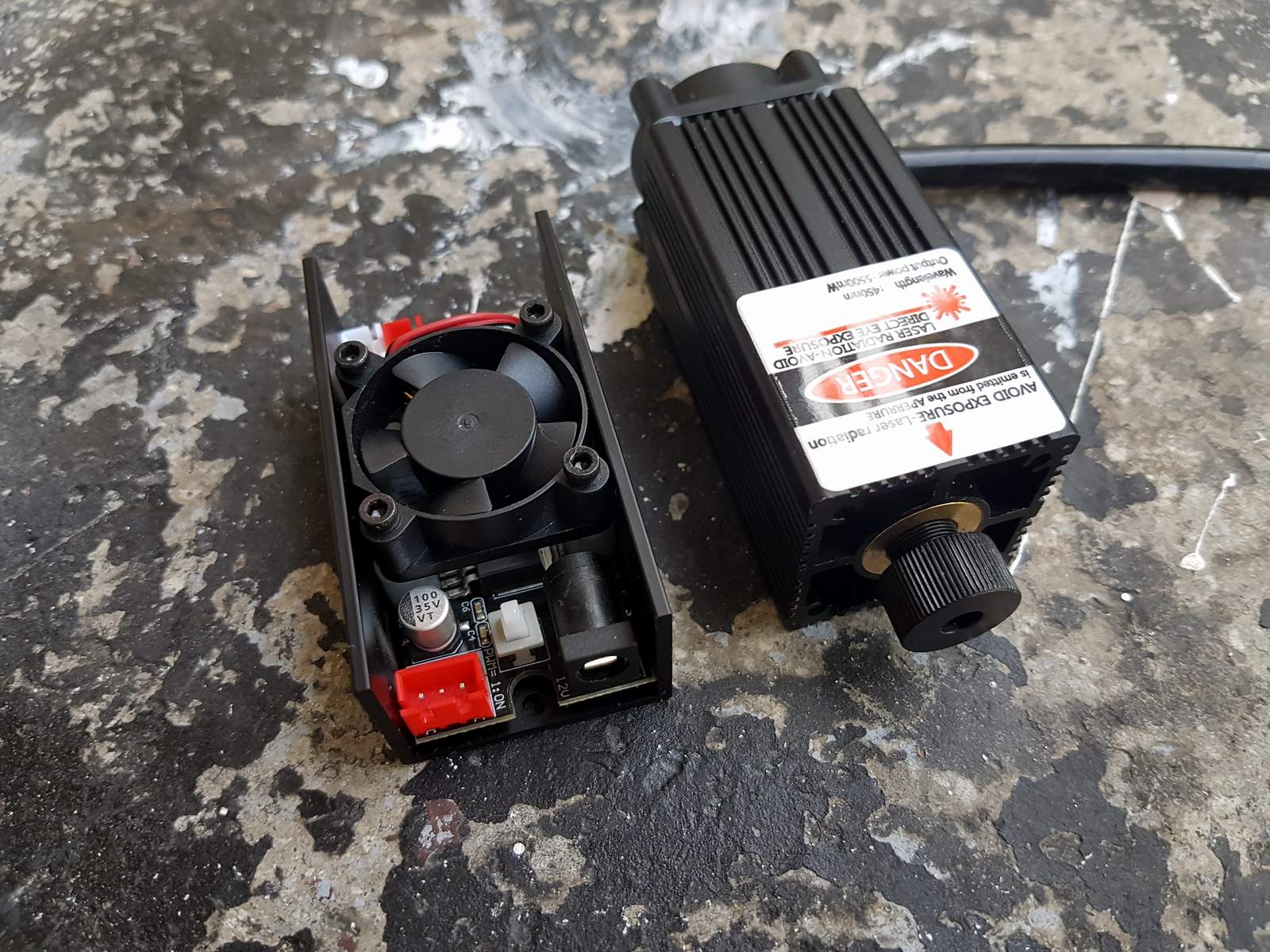

        Recently i bought cheap one, smaller, 3018 Pro CNC with laser and spindle, exchangeable.
        After 20 days and 4-5 hours overall working; the laser died suddenly.
        Diode type. Allegedly 5.5W, highly doubtable.
        Later i discovered it is cheap Chinese scam, the laser not the machine.
        The CNC machine, the construction, is quite alright, decent made. With good GRBL controller.
        So now i can use only spindle, until i obtain proper diode laser. Which is tough to achieve for small bucks.
        And what's worse; it is hard to tell which one is right one, since market is flooded up with Chinese scams.
        Instead; i can use the housing of present one and change only the diode.

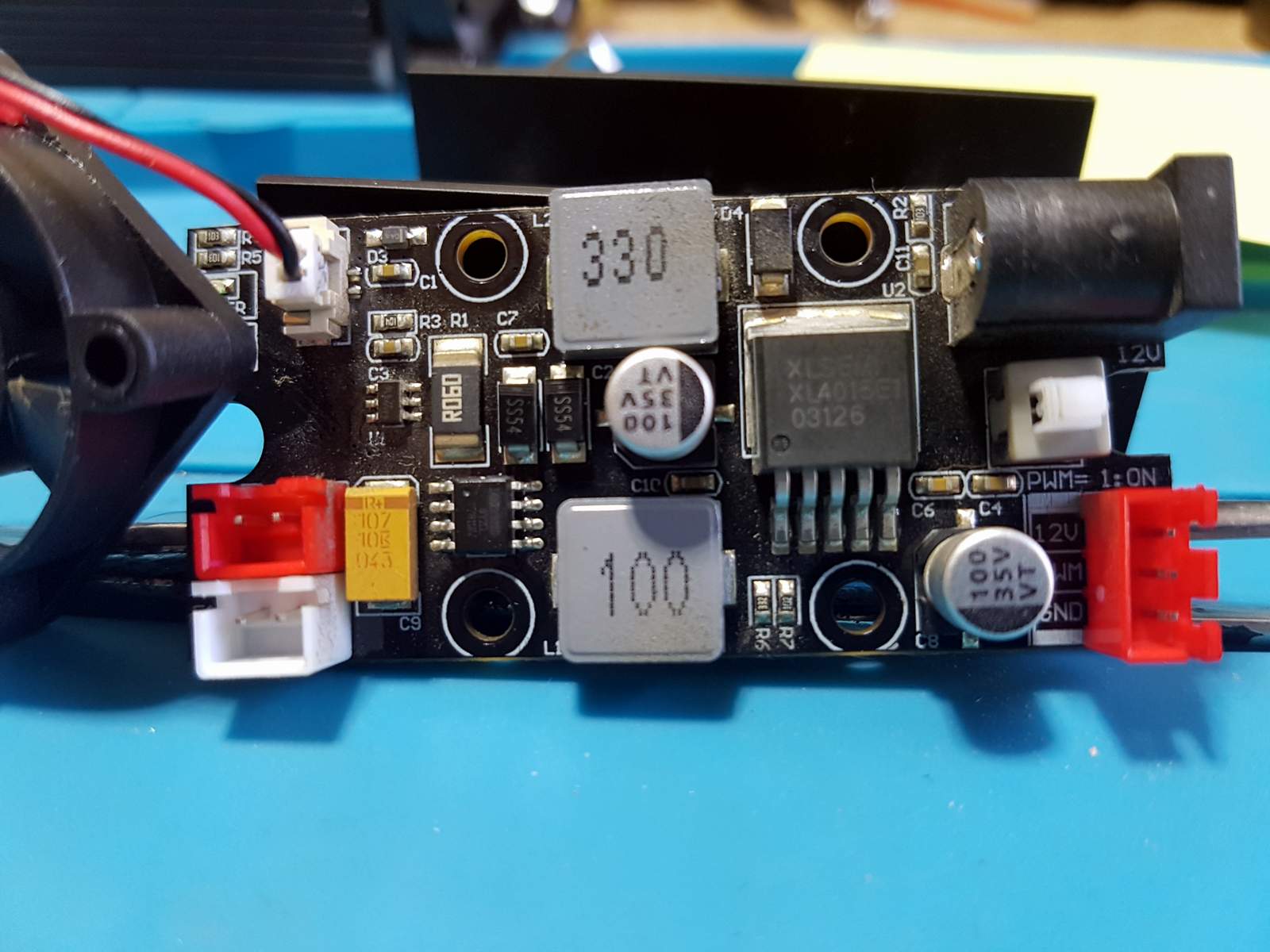

        Why and how it died? Don't have a clue, only suspicions.
        Such diodes needs rock stable constant current source.
        This one is having separate "controller board" with XL4015E as PWM controlled constant current source.
        I suspect that random sudden power transient appeared and XL4015E gone wild for a fraction of time.
        It was more than enough cheap Chinese fake diode to die.
        Spindle motor is also small and weak. Good only for "scratching" the material.
        Maybe good enough for pcb milling, will see these days.
