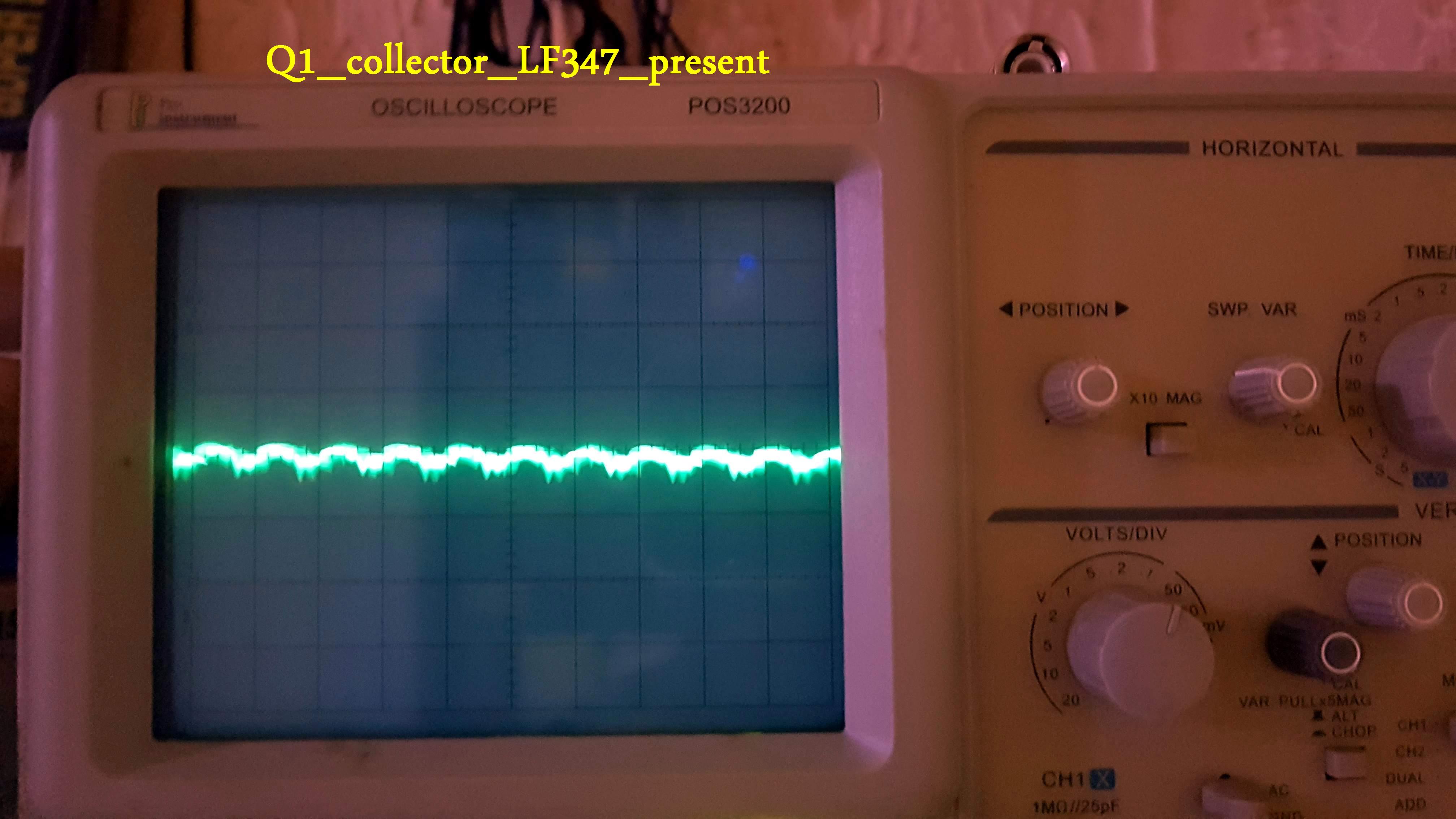

                          This should be instructive and educative ...

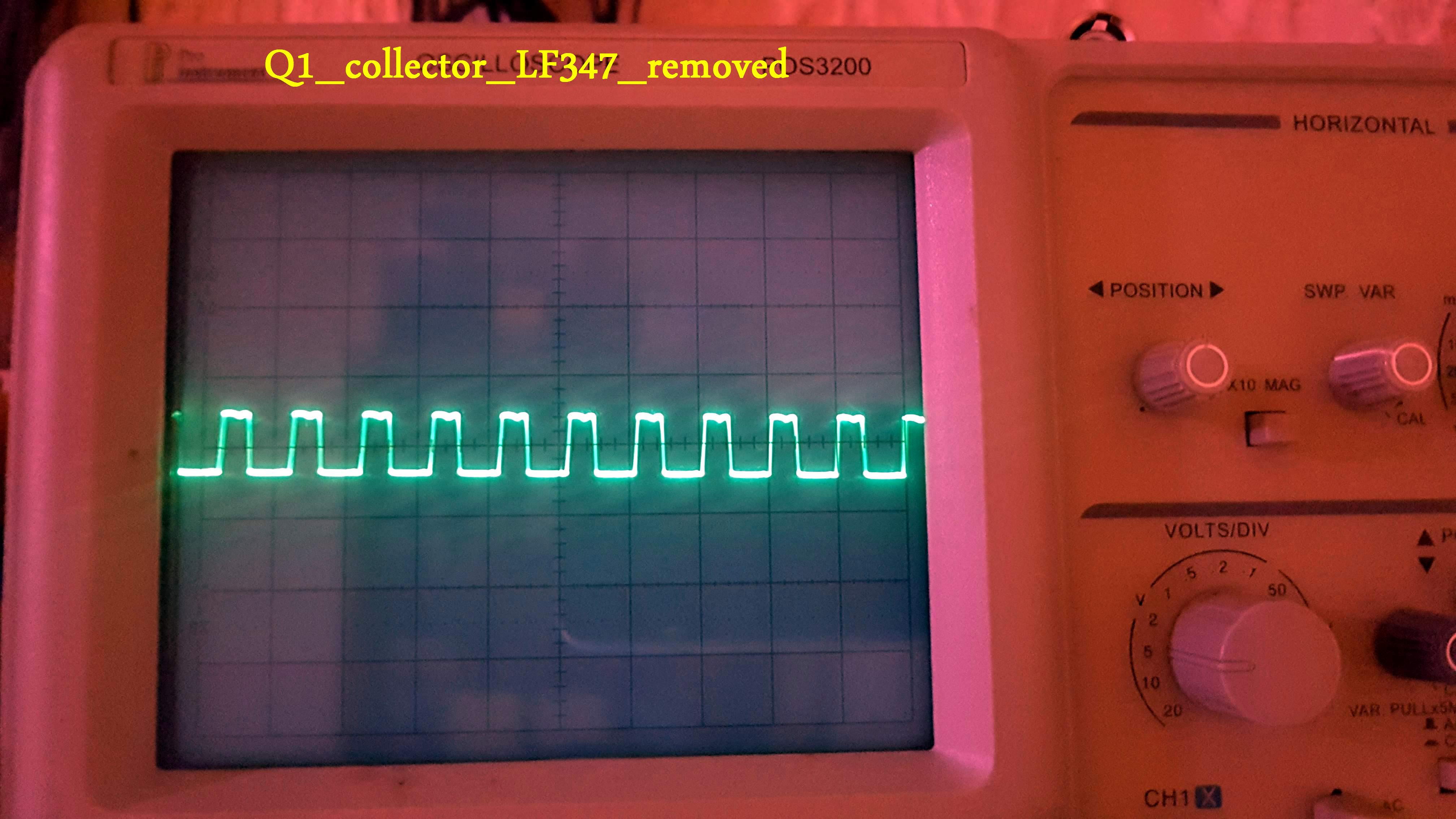

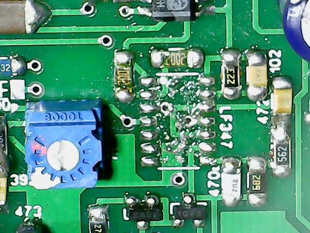

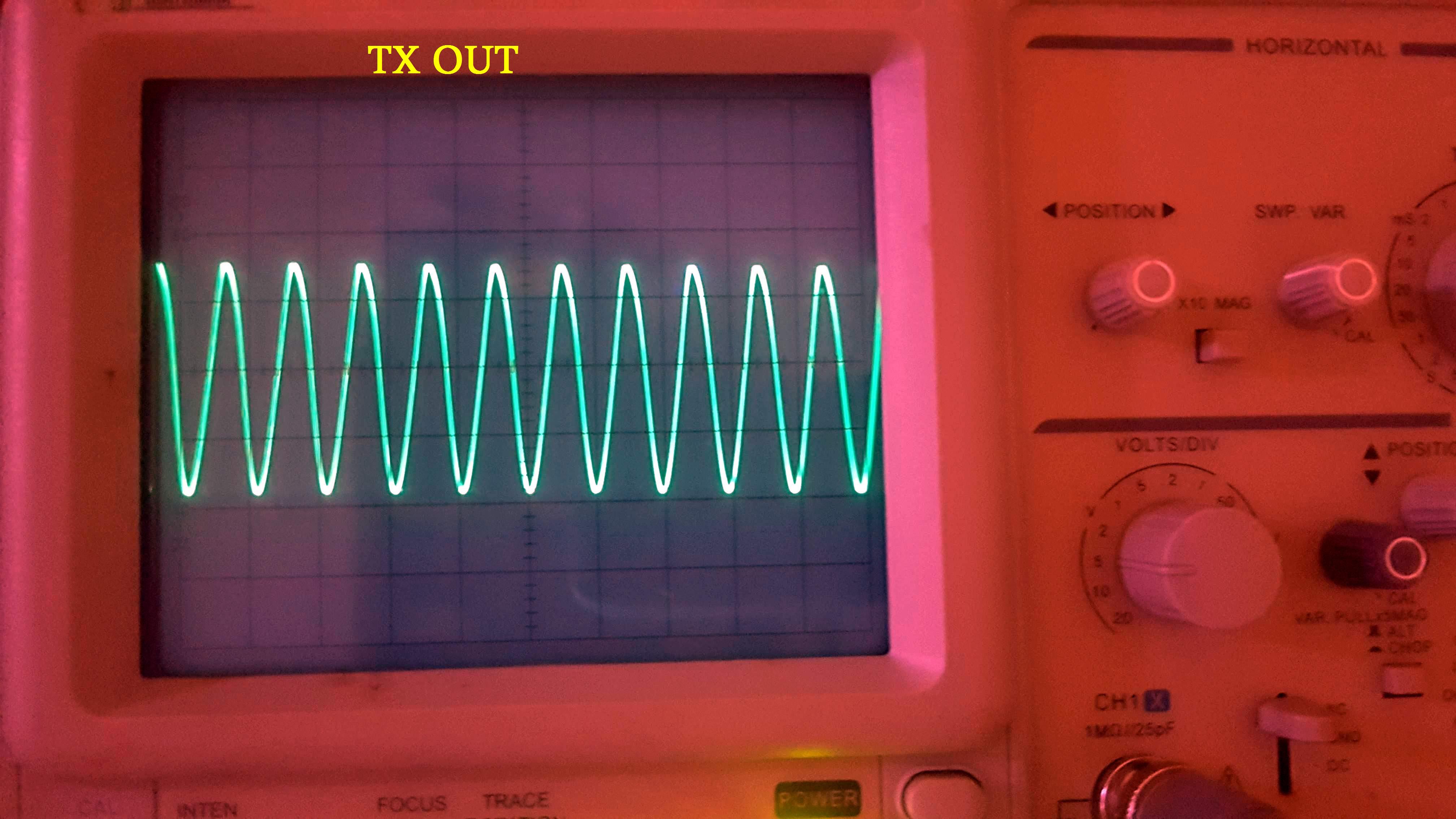

                          I soldered all the parts to the SMD board for the SMW detector.
                          First turn on ... it doesn't work! ?? And I've made at least 200 so far ... never a more serious problem.
                          The strange thing is that the human brain is always prone to complications.
                          And somehow I always forget about that phenomenon.
                          So I started fantasizing and assuming it was some complicated issue on board.
                          There are several reasons for this. I put all the used components.
                          SMD transistors have some dumb tags, so I just checked them simple and didn't measure the characteristics.
                          SMD unpolarized capacitors are also all of questionable condition.
                          I have a capacitor meter but I don't have a handy probe for SMD components.
                          So I was looking for a fault for a couple of days, with completely wrong assumptions.
                          I have a new two-channel oscilloscope, but I literally hated turning it on, calculating that I would easily find what the problem was, without need to use it.
                          After a few days of fooling around ... I realized the devil had taken all the joke ...
                          Finally I turned on the oscilloscope ...
                          The pictures speak for themselves ...
                          1) TX Out - Click image for larger version
                          2) RX signal with first LF347 on board - Click image for larger version
                          3) RX signal with first LF347 removed from board - Click image for larger version
                          4) Situation under the removed LF347 - Click image for larger version
                          5) Again - Click image for larger version
                          Well...
                          That's how I payed the price for the initial steps in working with a hot air soldering gun, gaining the first practical experiences.
                          Experimenting with cheap liquid tin, flux ... nope!
                          In addition, in such works, liquid tin is unnecessary. I manage to solder the ic circuit quite well and easily with an ordinary soldering iron and tin wire.

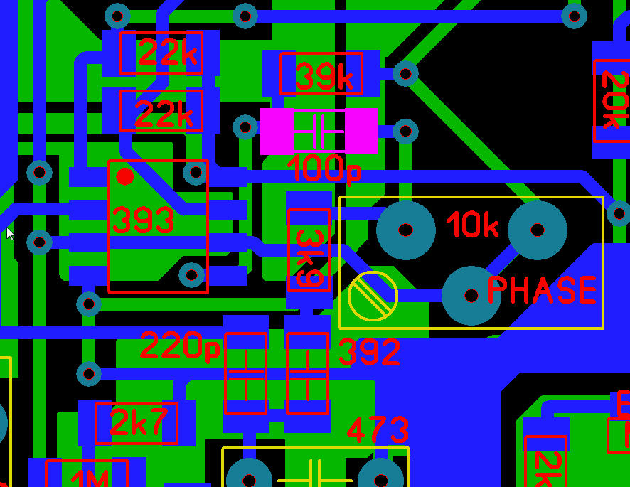

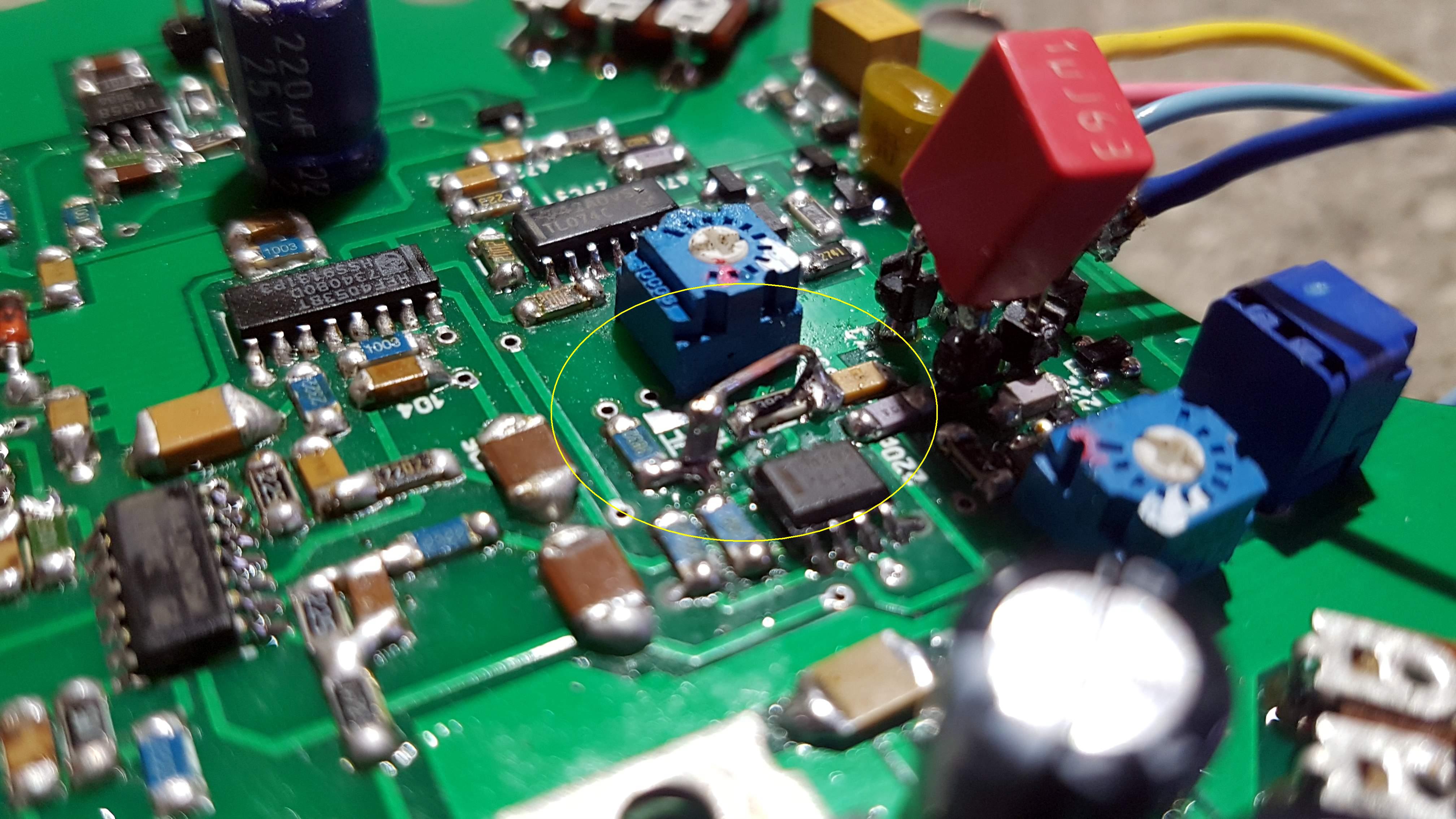

                              Yesterday i discovered a mistake on pcb. 100pF capacitor is wired wrong. My mistake.
                              But i am happy it is only one!
                              Easy to fix.
                              Just lift one side (right side) from the pcb and with piece of wire connect that side to where 392 capacitor and 3k9 resistor are connected.
                              It is wrong connected to Phase trimmer.
                              I don't know how you are testing GEB, maybe with ferrite?
                              If so; than you should know that it can not fully reject ferrite when Disc is at 0. (it actually can reject ferrite with perfectly matched coil, but in 90% of cases coil is not matched perfectly)
                              But in real life you don't need it to reject ferrite at all. Use piece of ancient Roman ceramics instead to adjust the GEB.
                              Adjust Disc at ... say "2" or "3" (still accepts irons) and than adjust GEB trimmer and potentiometer range to suits you.
                              It will than fully reject iron at "6" on Disc pot.
                              Sorry for the mistake, I haven't made it since the other day, so i couldn't warn you about it.

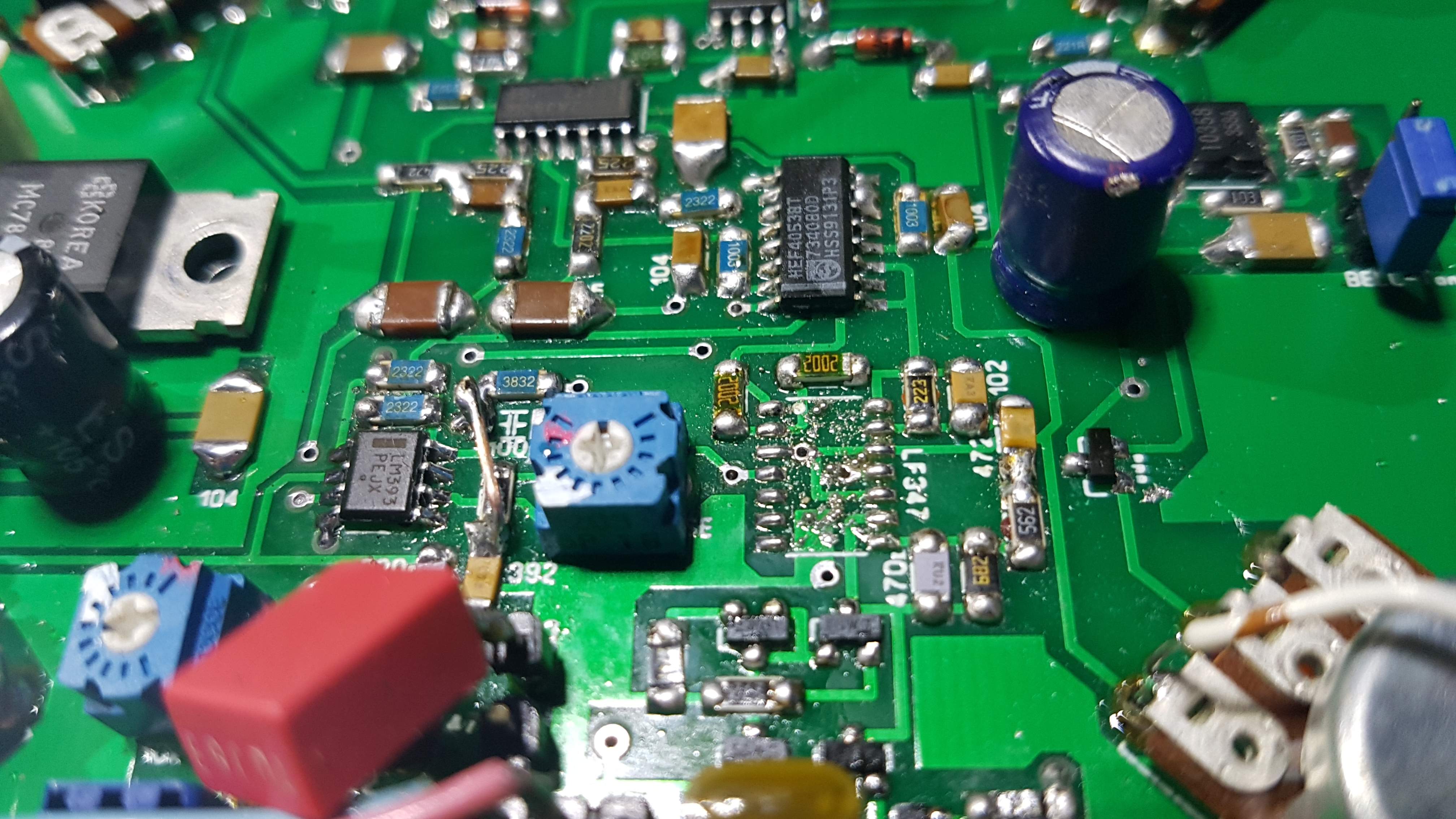

                                It is obvious that I sacrificed this pcb for the purpose of training with a hot air soldering iron.
                                It is so greasy and dirty I can't look at it. I have never done such dirty and messy work.
                                I'm thinking of removing all the components, washing it in nitro thinner and re-soldering new components...
