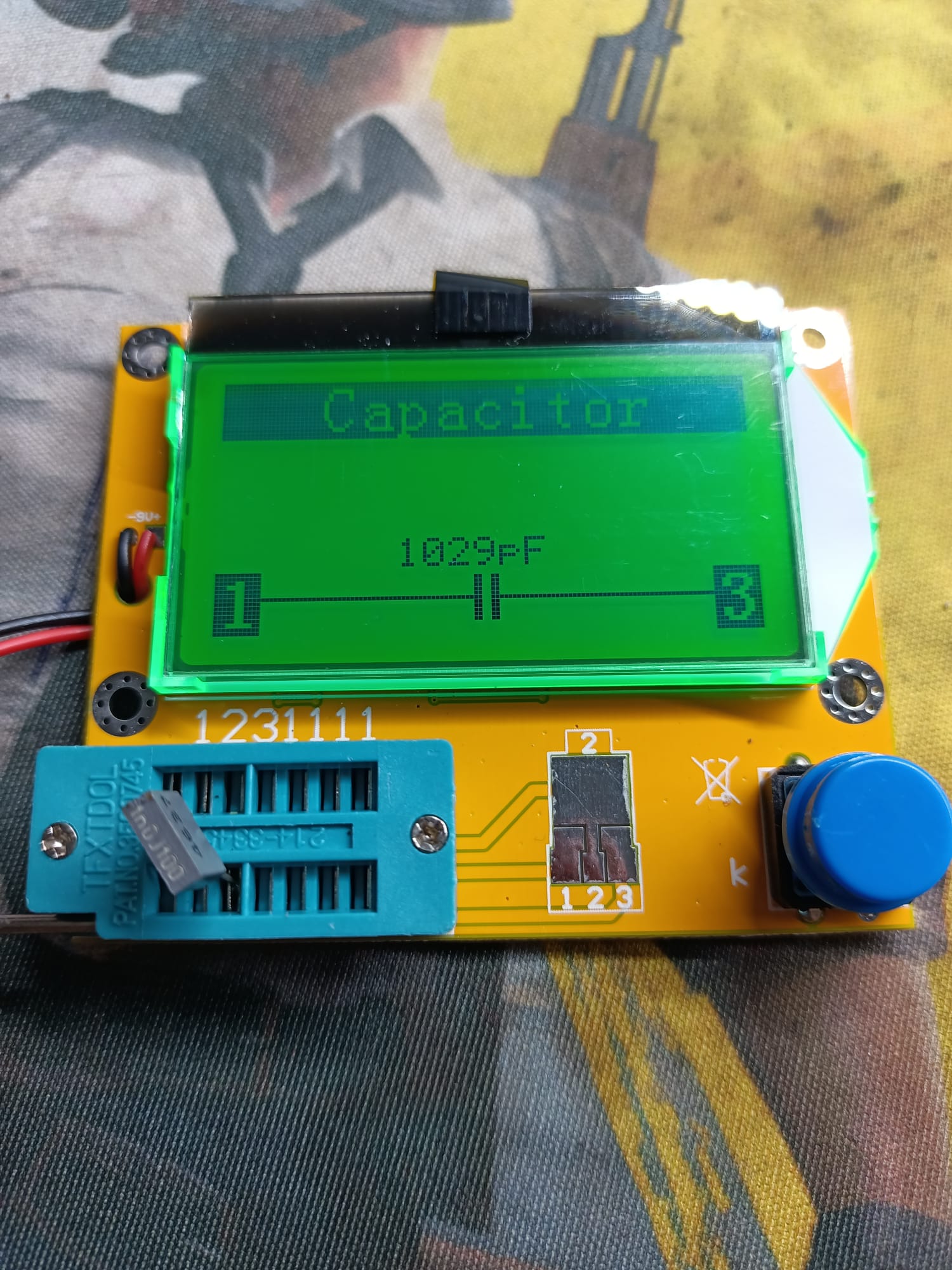

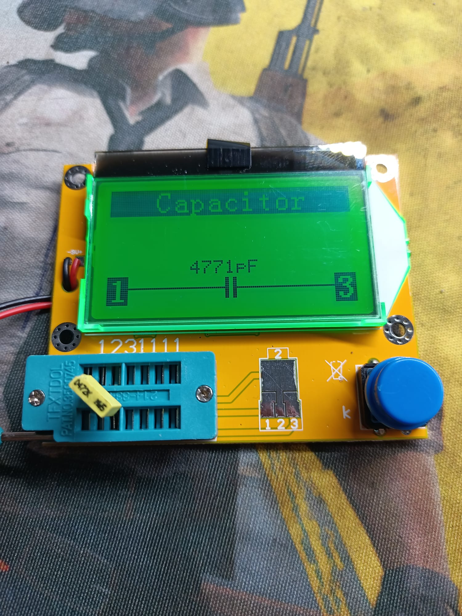

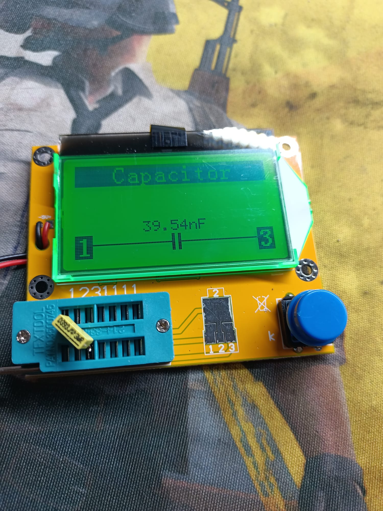

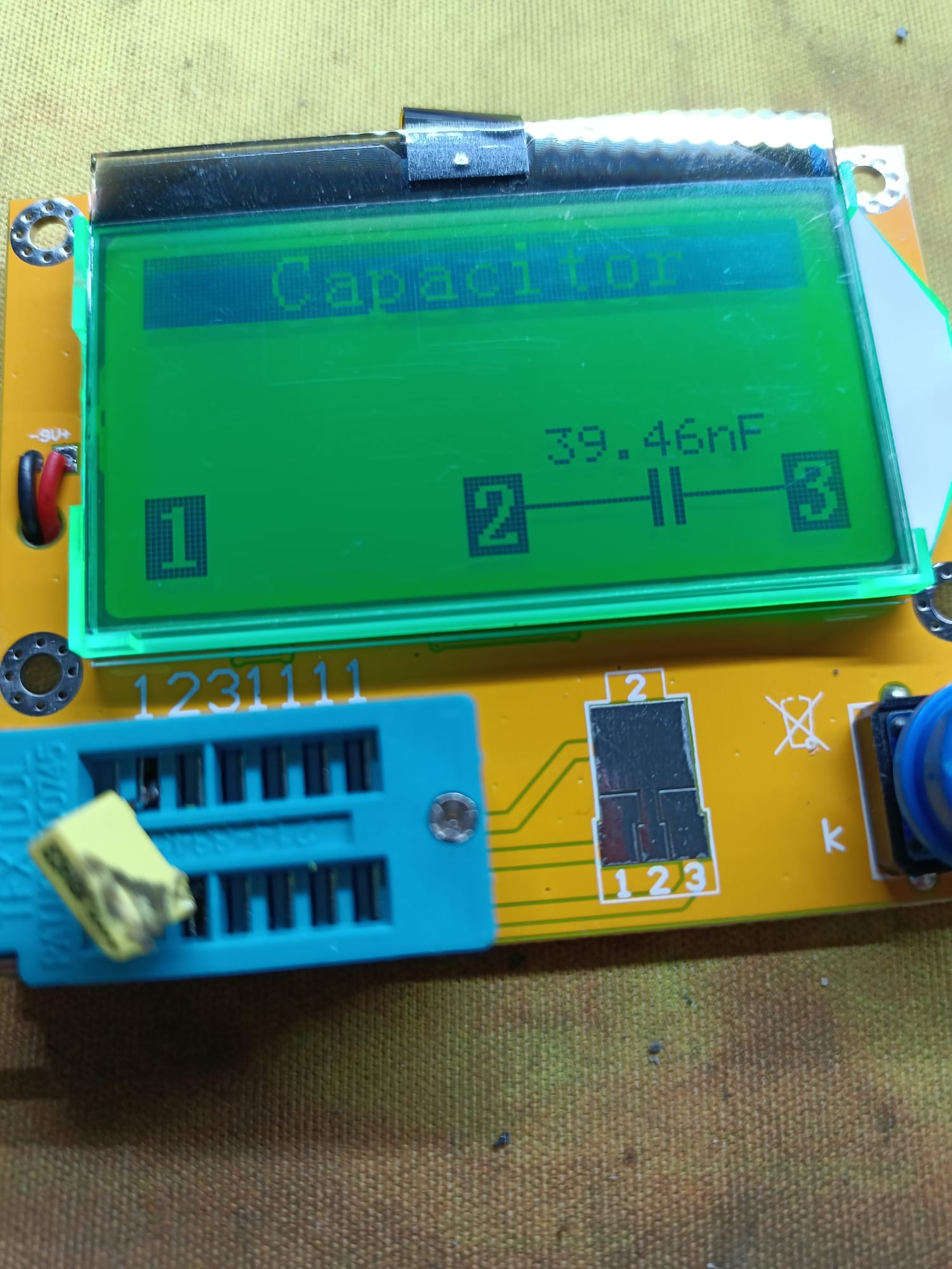

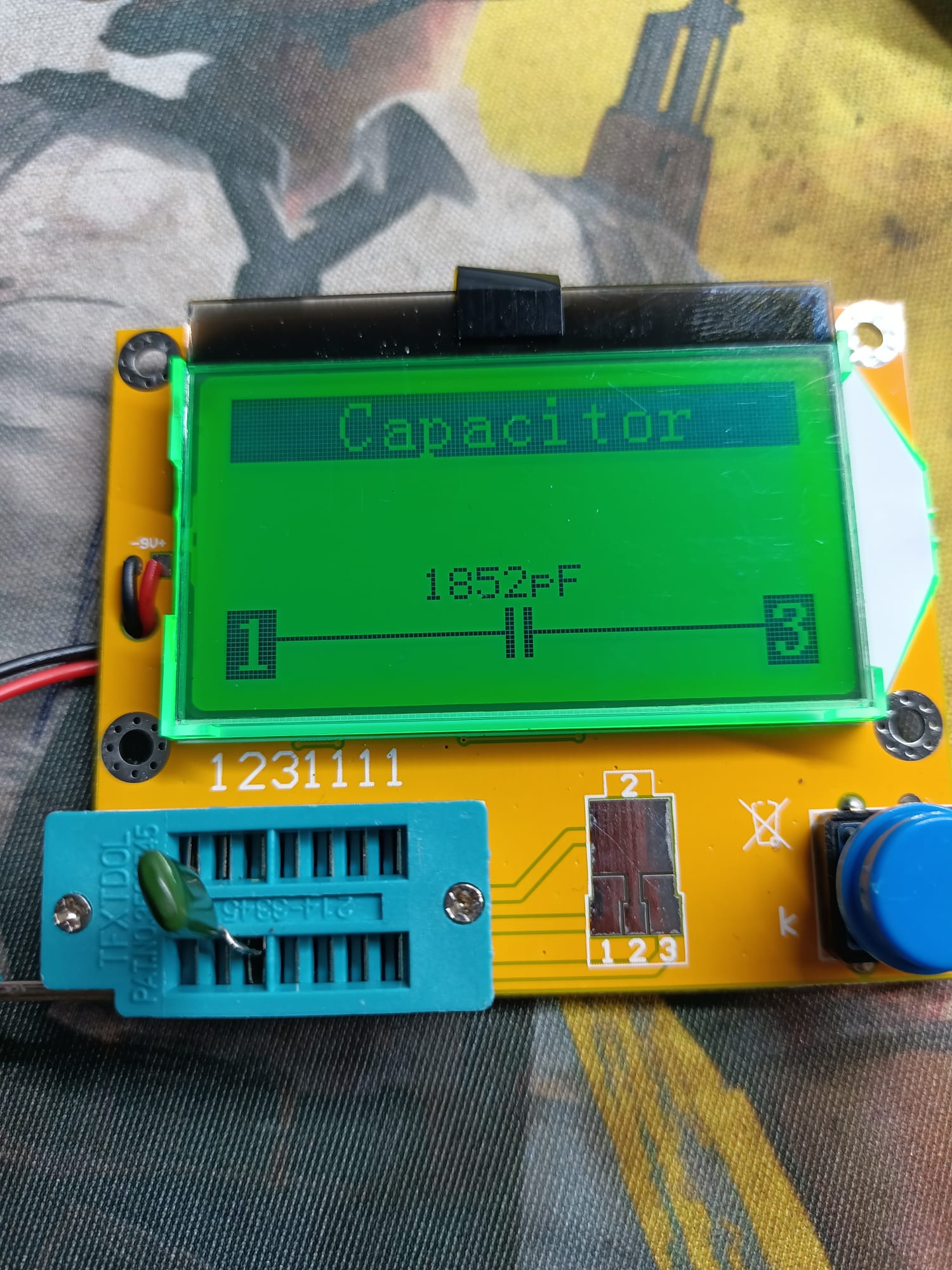

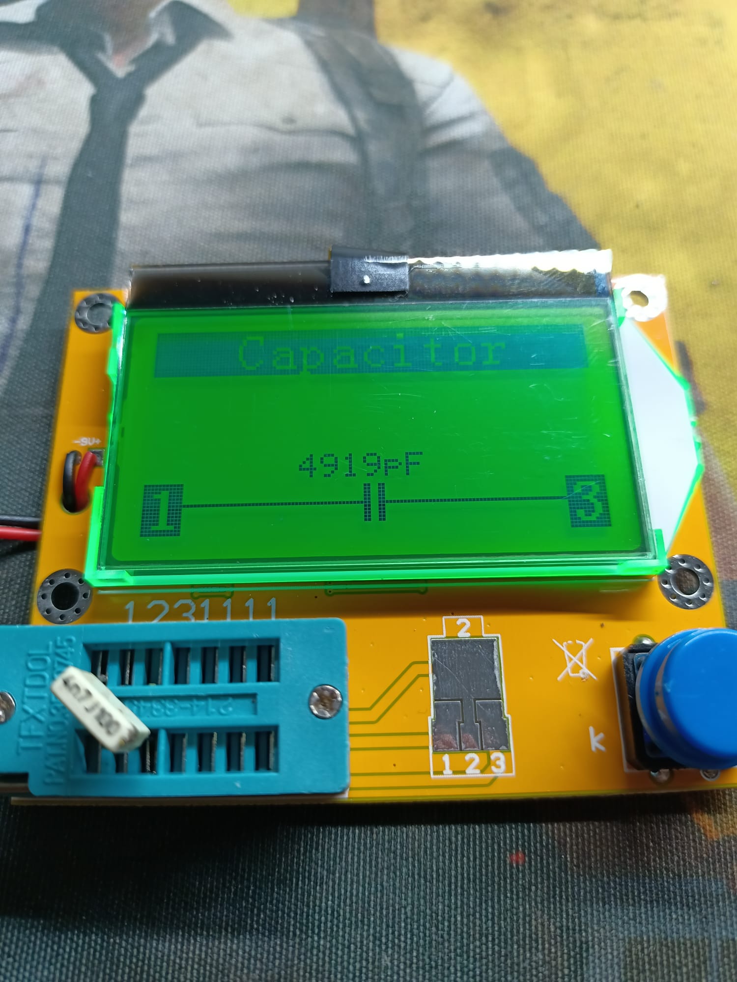

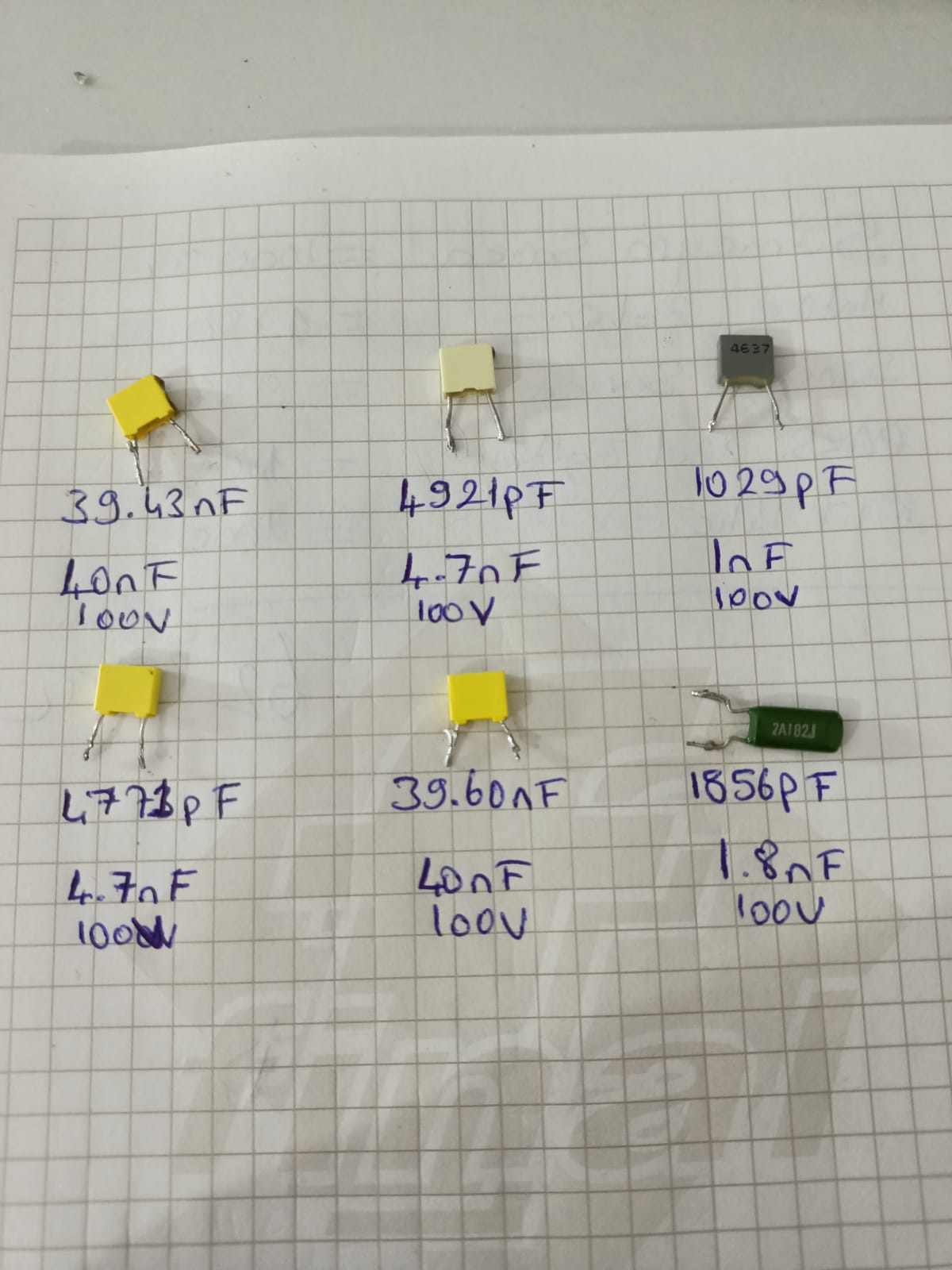

I have illustrated the values of the Capacitors I have in this way, I have measured these values with the LCR Meter. Can you help me convert the values of the capacitors in the picture into nF.
there exists Standard Capacitor Value Chart
according this chart no 40 but 39 is. this rule also for resistors. look Google. E24, E48 etc.
but i did meet ceramic 40nF on boards... so it's possible despite on the rule.
