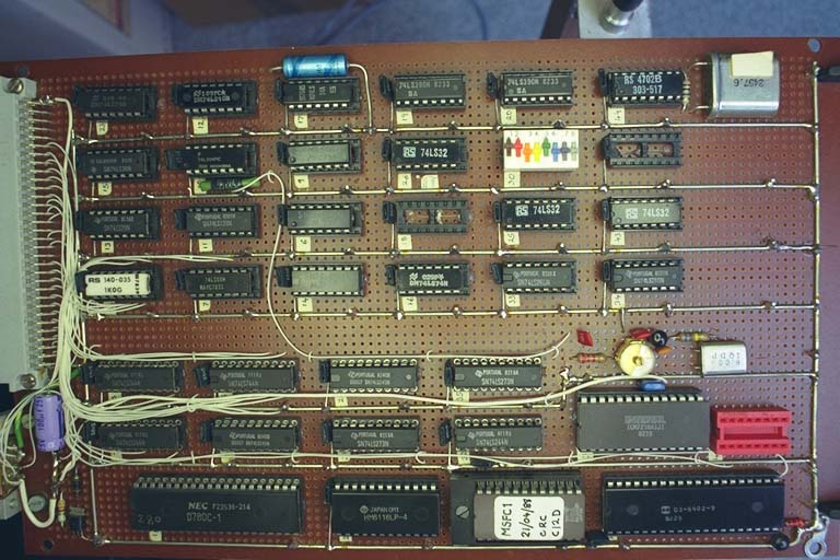

            There aren't chemical pens or the like to draw PCBs but a number of permanent markers useful, then board must be etched as usually with common products like FeCl3 · 6H2O, very common dark green or yellow/brown compound mixed with water.

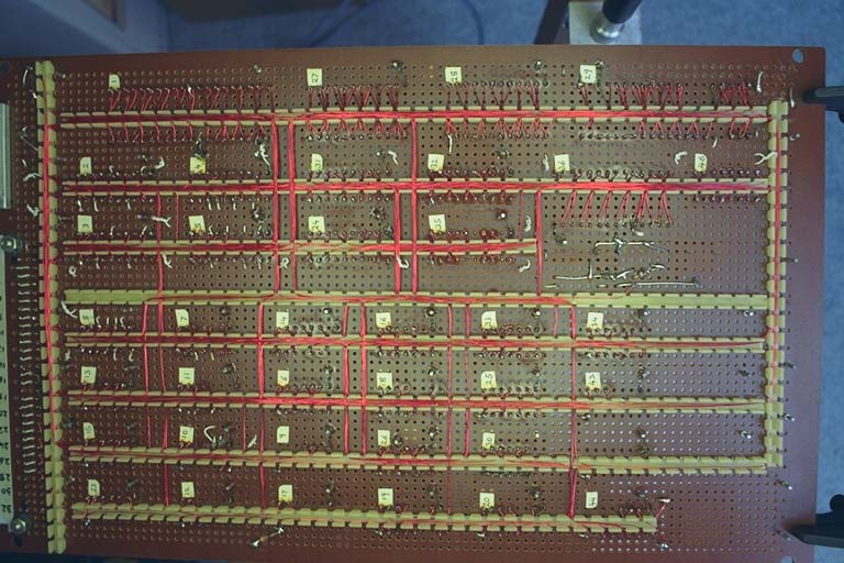

            There was an interesting method for circuit making ...usually different from veroboard/perfboard (uses dedicated boards or your own): circuit wire wrap using wiring pens... old method but really effective, I've used for digital stuff many times in past.
            You mount components on an insulant stuff e.g. bare fibreglass piece, drilling holes etc... then wire-wrap using the pen: it requires soldering on joints but you don't need etching a regular pcb and for small stuff it's competitive and also fast approach though need practice.
            The method is useful also for veroboard and other protoboards, cause speed up much the circuit "writing" ... you need to solder joints, of course.
            The best example of pen is the ‘Road Runner’ wiring pen , look here:
            http://www.rrunner.co.uk/pens/pens.htm
            Here some pictures as example of finished board.

              now u r complete, but u forgot about Circuit Works silver Pen, they specify them for prototypes....
                I never used them... but similar, yes. If they are like the ones I have used... I don't suggest soldering on them... impossible task and big waste of time, at least for me.
                I tryed on mine but always the heat from soldering iron melt everything.
                I concluded that these articles are good just for repair or jointing components but with varnish itself, not soldering stuff.
                It's much more easy draw, also by hand, a pcb and etch it ... make some holes and get what you need than messing with the silver varnish.
                Also it's cheaper... cause good silver based products are not so cheap... and you need much ...and they always are about small about useful volume of conductive paint... at least... at my place.
