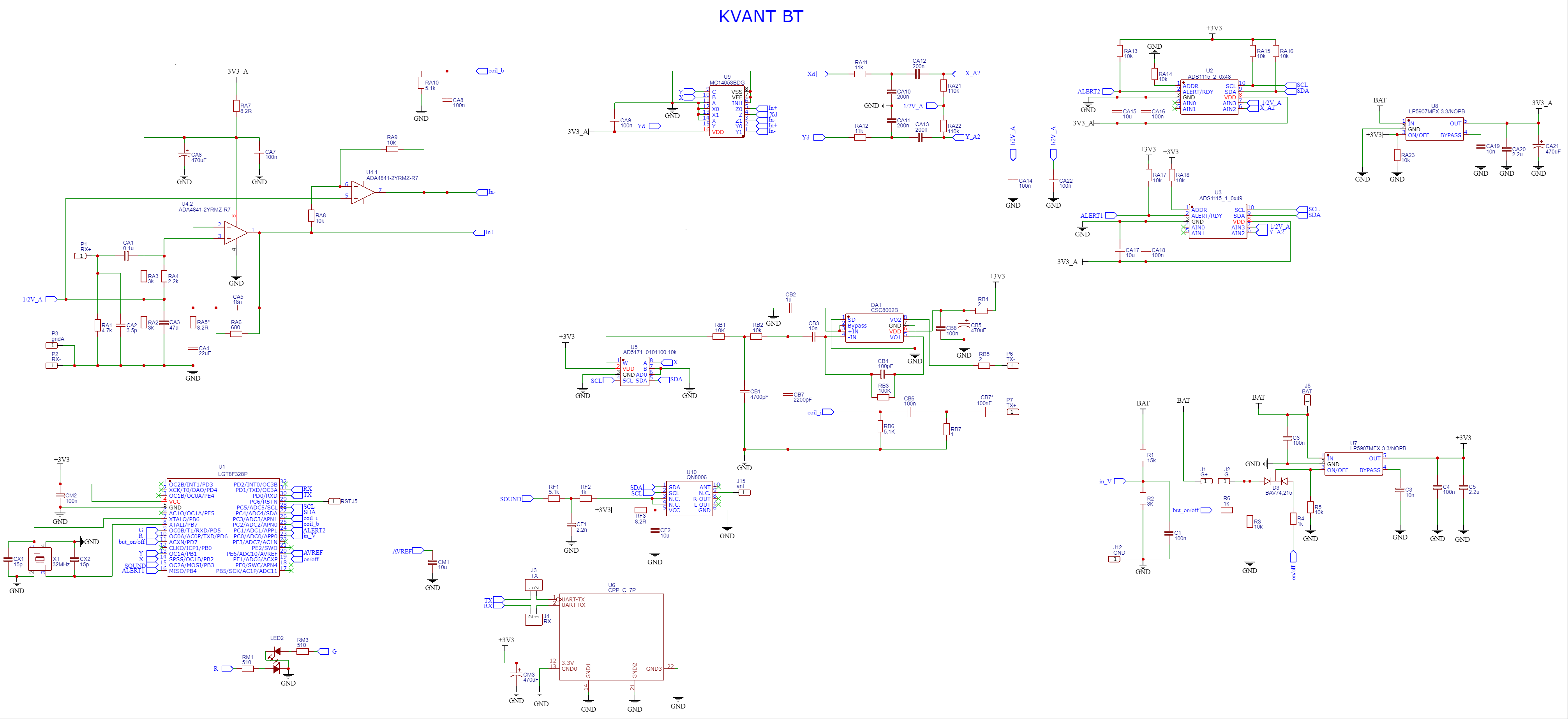

              simpler, full wave quadrature detector Click image for larger version  Name:	image.png Views:	0 Size:	353.0 KB ID:	427548

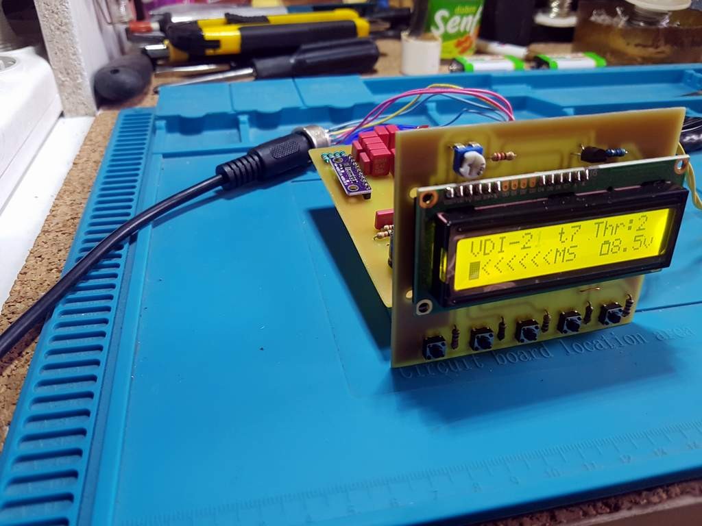

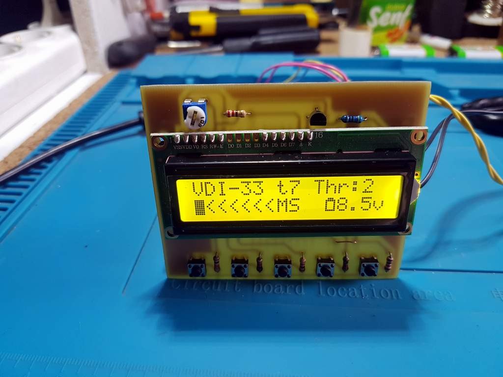

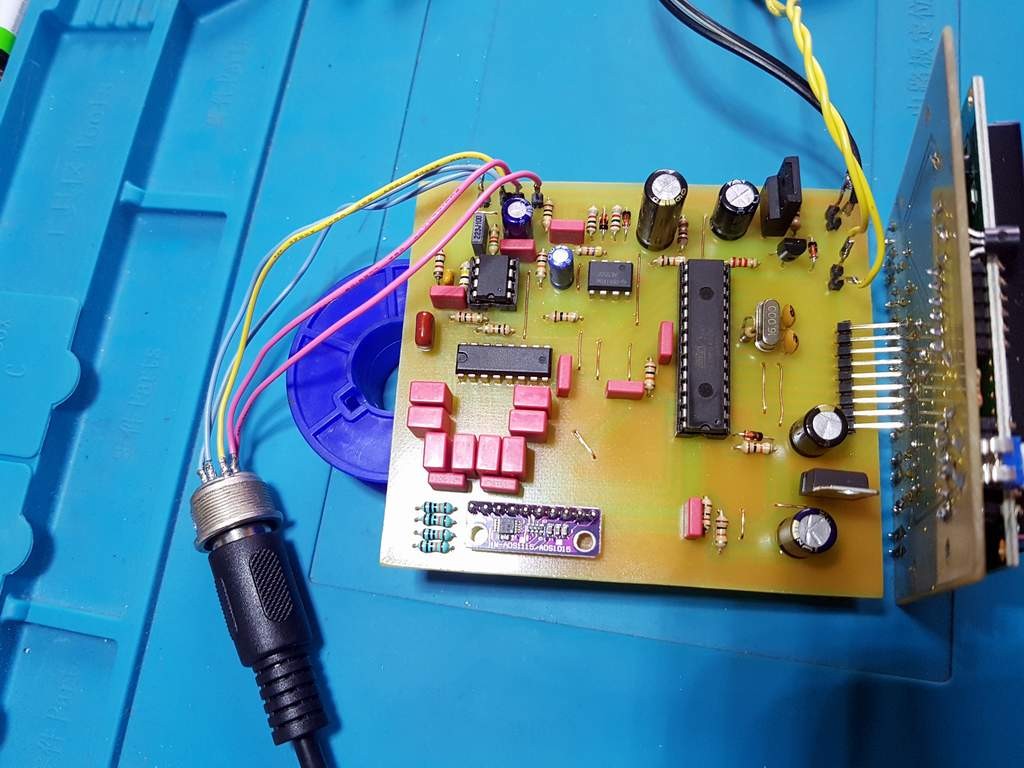

                I made one of those.
                Not bad for a hobby project.
                But I never made it to work quite well.
