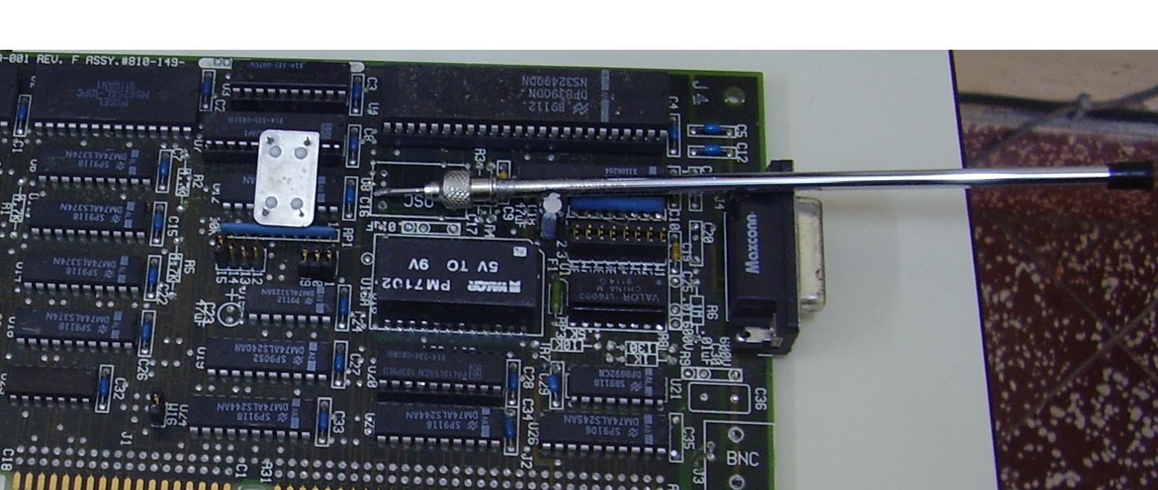

    When you can't obtain a special device for to desolder components solder on both side, you can use hipodermic needle for horses
    # 12-20 or 15-20. Here attached to metalic cilinder. You hot the solder with the iron ant at same time make circular movement
    into pin of device and PCB.
    Hi Esteban,
    But with this technique you will damage the PCB through hole connexion, right?
      Originally posted by Fred View Post
      Hi Esteban,
      Hi, Fred
      Yes, I use this for to recovery components from many but many PCBs (in boxes) of equipment I have. This extracted components is for projects. This tool is for components difficult to extract. Don't used for recovery caps, resistors, diodes, etc. Just for many pins components.
      When I recover of my interest, the PCB and not useful materials (for me) go to the garbage. Yesterday, with this tool extract a MC1403U, volt reference for 2.5 V. After extracting, I connect to 9 V battery and... voila! output obtained is exactly 2.5 V, so the component don't suffer damage.

            This needle thing is a good idea, actually dessoldering 2 or more sides PCB´s i a real pain,and hot air for many-pins through-hole components is not easy either, it will burn the PCB..
              This needle idea is used for technicians wich repair electronic equipments used in home as TV, DVD, etc. You must have a lot of needle, because with the use these are deteriored.

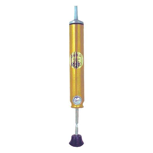

                    Also this tool is usual for to desolder components. This suck (aspires) the melted thin and suck strongly it. If you hot very well the pins, you can extract both side of solder.
                      Those solder pumps work quite well. Make sure to get one with a plastic tip, and move your iron out of the way just before hitting the button to suck the solder out. Otherwise, you can damage the solder pads.
                        teflon tip
                        Probably the best all-around dessoldering tool.

                          Indeed. I should have been more specific.
                          Definitely a great tool to have. In most circumstances, a dedicated desoldering station is better, but is not something a hobbyist typically has.

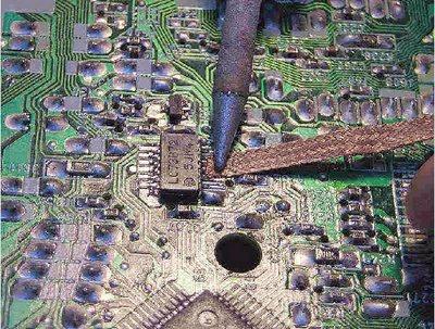

                            Mesh for desoldering. In the epoch of videocassette in the 80s I saw a technician that use this mesh for desolder. He has skill for to extract components with more 40 pins with it!
                              Never could get used to it
