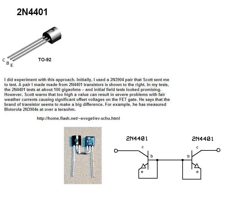

    Around 100 gigaohms!
    Are you making homemade ion chambers ?

      Exactly!
      Probably from the link i found some day, the problem is the gigantic value resistors.They are rare and expensive
      I donĀ“t know if this transistor thing work, but it is interesting.

        Who knows... maybe is interesting. The most high value commercial resistor I can find here is 22 M. No, I'm not making homemade ion chambers!

            Maybe is a curiosity the connection of the both transistor as very high value resistor. I post only for this. Do you think that only I think in such things for use in ion chambers or similar?

                    2x 50 G ohms =100 G ohms

                              Hi everybody,
                              I just wonder, is it possible adjust resistance of that transistor network?
                              Let say instead 100G just 1G.
