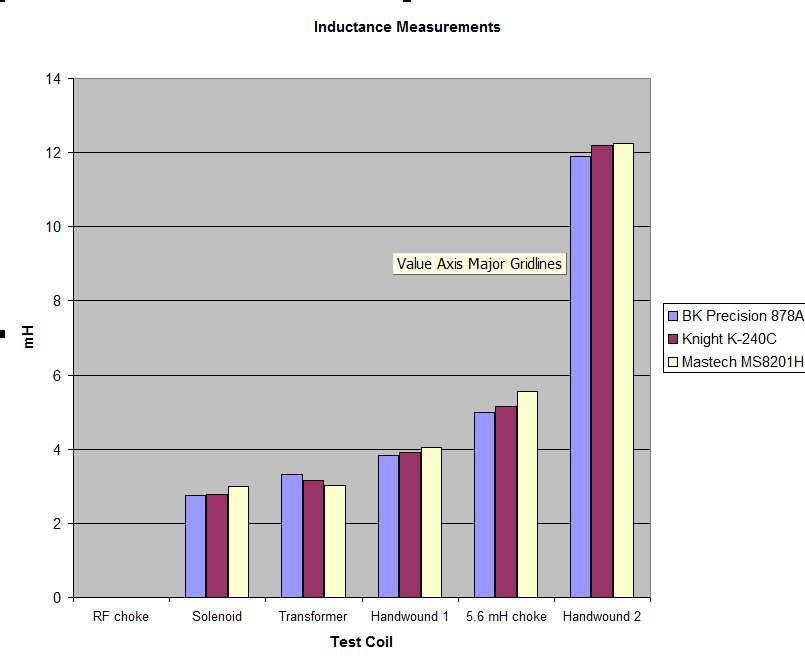

    I compared 3 LCR meters inductance measurement.
    BK Precision 878A ($230)
    Knight K-240C ($80)
    Mastech MS8201H ($50)
    I don't know which is most accurate, but chart shows comparison. My guess is to only trust inexpensive meters to be around 5 - 10% accurate in certain ranges.
    -SB

              Hi Maverick:
              Thanks for your ideas and the time you spent finding and studying the specs.
              I currently own the Knight and the Mastech meters I tested. I borrowed the BK to check the ones I own because they did not perfectly agree on measurements.
              The Knight meter does not have as many functions as the Mastech, but the low ranges are better on Inductance and Capacitance and it seems like a better engineered product.
              The Knight meter was always a little closer to the expensive BK than the Mastech. If you assume the BK was more accurate, then the Knight is more accurate than the Mastech for inductance. I did not have time to check other functions.
              The BK was very nice to use I will say because it had autoranging and the more professional features.
              I don't have money to get more meters, but it was an interesting test.
              If you ever get a chance to test your meter against a very expensive one I would be interested in the results.
              -SB
                Hi Simonbaker !
                I used the specs for compare.
                They are papers, therefore only real tests tell you which is the best instruments.
                But you know that the brands are different therefore they used different "champions" and methods for set their instruments.
                You are assuming that BK is correct but I think is better to do tests in another way.
                Take a lot of at least 3 champion inductances with values many different between them, turn on your meters, wait almost 10 minutes and do the measures at the same temperature, use ambient temperature, about 18/25 ºC, no more. Then compare them.
                Perhaps, you will discover another situation.
                In September I can repeat all tests but using other instruments and champions.
                Kind regards,
                Maverick

                  I agree. I don't conclude that BK is most accurate; but if it is, then Knight is more accurate than Mastech.
                  What is a "champion"? A reference?
                  I would like to take some stable inductors, capacitors, resistors and test with really good, expensive tester so I have a reference.
                  I know it isn't really important for this hobby, but we like to tune our test equipment just like our metal detectors!
                  It is an interesting problem to try to determine true measurement when you don't have any precise reference.
                  -SB
