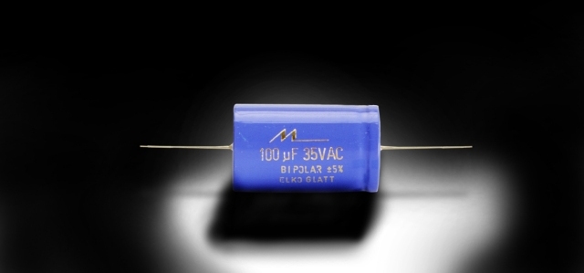

    I'll construct a conductivity-meter schematics that written before.But there is 2 electrolytic capacitor named "axial capacitor".They are known as non-polarized.I never find electronic shop in my city and inthernet market of my country.If I use 2 polarized electrolytic capacitor instead of these , may any problem occurs ? By the way all capacitor values are same .

        No, they aren't.
        There are bipolar electrolytics...
        Look
          I don't see why you could not use Non Polarized or Electrolytic in this circuit.
          Just be sure Caps are oriented correct if you use electrolytic type.
            No, they aren't.
            Look
            Can I use non-polarized instead of them ?

                That one , I'm looking for . But couldn't find my shop's stock and internet Big capacities I found all electrolytic capacitors
                  You can use them! Just orient them correct.
