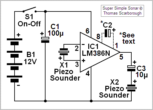

    Sonar target detector
    While I've tried to discover myself what amplifies a sound oscillator containing an audio frequency amplifier, microphone and loudspeaker, and whether it can be used as search oscillator for location of different obstacles, it turned out that Rev. Scarborough ahead of me and has already published the circuit diagram of a super simple sonar. Will burst of anger.

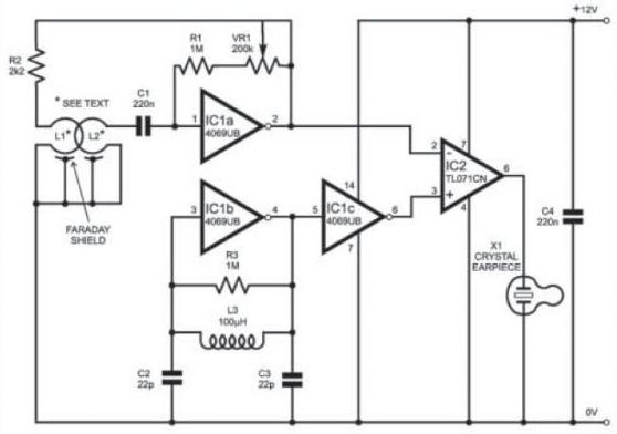

        Maikl, you know that for me this circuit is incompetent design.
        Resistor R2 is top of incompetency. It reduces TX current and draws useless DC current 3mA. This can be easy improved by a capacitor C5 to stop DC. The TX current can be increased by connecting not used gates IC1d, IC1e and IC1f in parallel to IC1a . Capacitor C4 should be electrolytic and circuit will operate with 9V battery. Try this and measure operating point in pin 2. Voltage measured with DC voltmeter should be almost half of battery voltage.

          I am for reliable knowledge represented someone about modest possibilities, who they would execute this wonder here how in previous # 17, he did not send to all devils Thomas' reverend. This usual arrangement BFO.
          This is normal generator Meisner, coils serve to coupling manageable and not no Tx / Rx.
          The generator of reference will act with dependence from resistance of coil, it can lacks the small of condenser here? 1Mom has to make amplifier from comparator, and to does not reduce kindness Q.
          The very critical setting to op the point of work of generator, lack of tensions of reference - the amp; TL07 will act worse and worse with growth of frequency of work.
          About influence of temperature better does not remember.
          Conclusion: the user will hear every grass and the lump of the ground, but not the signal of treasure!
          It such CCO / BFO made on SN7400 arrangements and was could meet in popular periodicals for 1975 year SN7474. I am for return of Thomas' reverend to original bible.

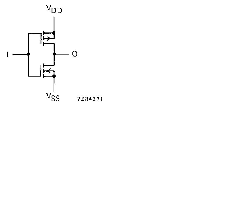

          I enclose patern inwerter 4069.

              HC04 instead 4069

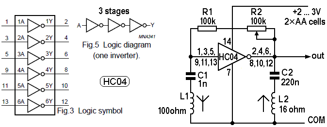

              A better circuit for CMOS search oscillator.
              Instead 4069 is used HC04. Instead 12V battery are used 2 x AA cells. To increase TX curent and to lower input impedance of amplifier, the six inverters are connected in parallel.
              An inverter of 4069 can deliver output current only 0.9mA. It has low gain because cosists of one stage.
              An inverter of HC04 can deliver output current almost 5mA. It has high gain because consists of three stages as shown below.

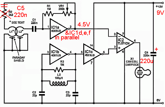

                Hi mikebg. I'll try this combination (unfortunately only in winter when I had a surplus of free time). But I will keep the voltage of 12V for TL071 and I will tell the results. HC04 does not have and the combination I do not try. L1=100ohm (and what is the inductance which is more important?)

                    Maikl, because of high operating frequency, the circuit in posting # 17 is very sensitive for targets at air test. The reference oscillator (BFO) in that circuit generates too high frequency. Despite C2 and C3 appear in series, equivalent tank capacitance is not 11pF but more because of stray capacitances. For calculation of oscillating frequency I use equivalent capacitance 20pF. With inductance L3=100uH, it gives oscillating frequency above MW band. That means your search oscillator also oscillates at MW frequencies where the earth generates large GND signal.

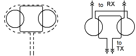

                    To test search oscillator circuits with CMOS IC , I used my sensing head designed for IC type LM386 (because it can deliver much more current for TX coil). My circuit is like HOUNDOG, but RX coil is also tuned. I tune RX and TX tanks to frequencies below 20kHz to reduce GND signal. For addional suppressing of GND signal, my sensing head contains two RX coils (about 30mH and 56 ohm each). They are connected in series as TWIN LOOP configuration shown below. Since both RX coils are coplanar and connected in opposite direction as shown in right scheme, total inductance increases to 63mH (mutual inductance appears positive). The rectangle TX coil is placed in the center of head (in middle between RX coils) and each RX coil is placed almost in induction balance with TX coil. Despite for testing with CMOS IC I used smaller capacitances, oscillating frequency was no more than 30 kHz. The TX tank of HOUNDOG is also tuned to VLF frequencies. Because of lower operating frequency, my circuit has no more sensitivity at air test as the circuit in posting #17, but I'm sure it operates better in the field with conductive soil.

                        2. See Fig. 8 and compare with sound oscillator in posting #16. The principle is similar: Piezo Sounder X2 operates as transmitter or loudspeaker . The piezo sounder X1 is receiver or microphone. Now see the circuit diagram in posting #10. This a better operating circuit because TX coil is driven with large current. The CMOS ICs can not deliver so strong current as an audio frequency amplifier LM386. It can operate with 8 ohm and even with 4 ohm load.
