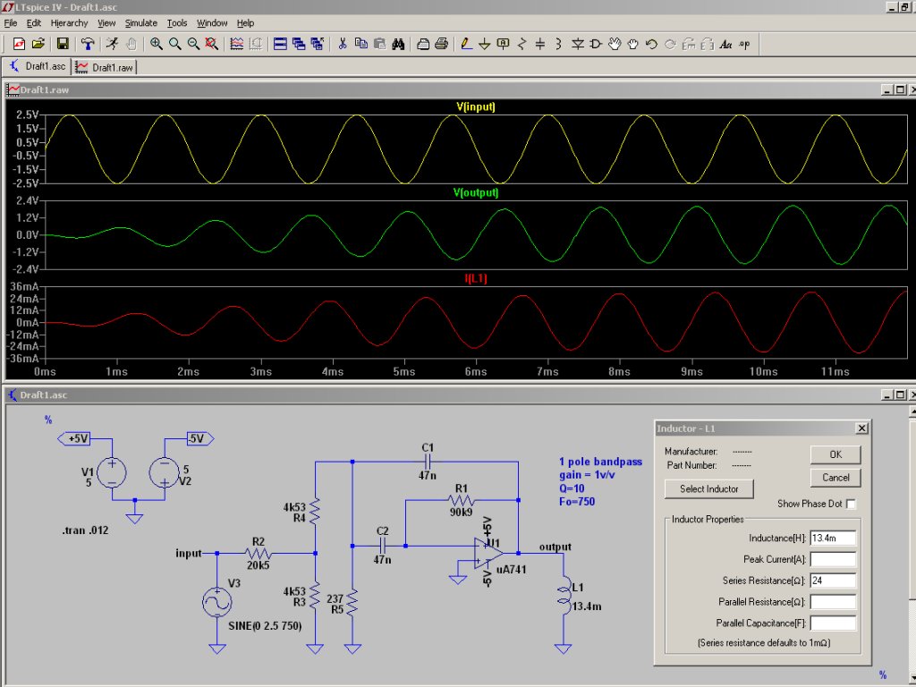

                  Thanks, Carl. What I did was a RC passive filter at the output of DAC and before the input of Op-Amp, however, the waveform distorted badly --- in terms of both amplitude and phase, however, individually conneting the ampilifier to the coil seems to work, but I'm still not getting filtered signal... I wonder why is that...
                    Instead of using a passive filter followed by an opamp,
                    why not use an active bandpass filter to drive the coil?
                    You can get FilterPro to do the design work. Quick and easy (and free).
                    http://focus.ti.com/docs/toolsw/fold...filterpro.html
                    edit: Or, design an active lowpass filter if you desire frequency agility.
