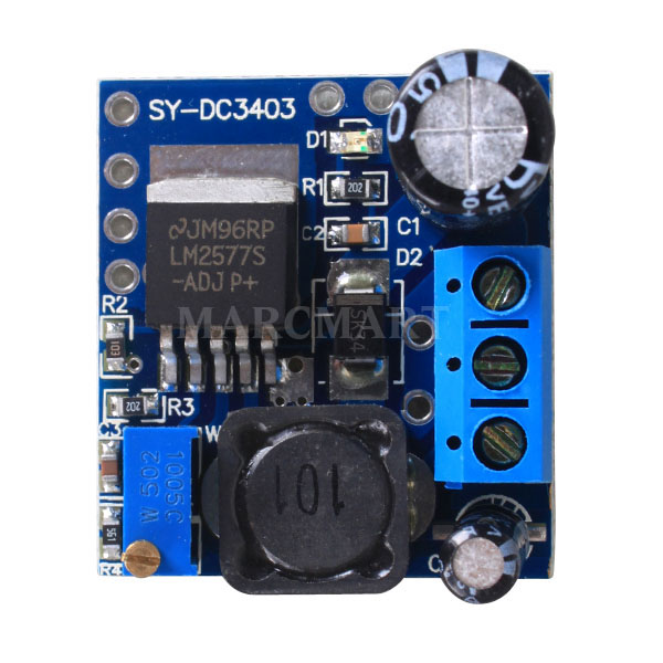

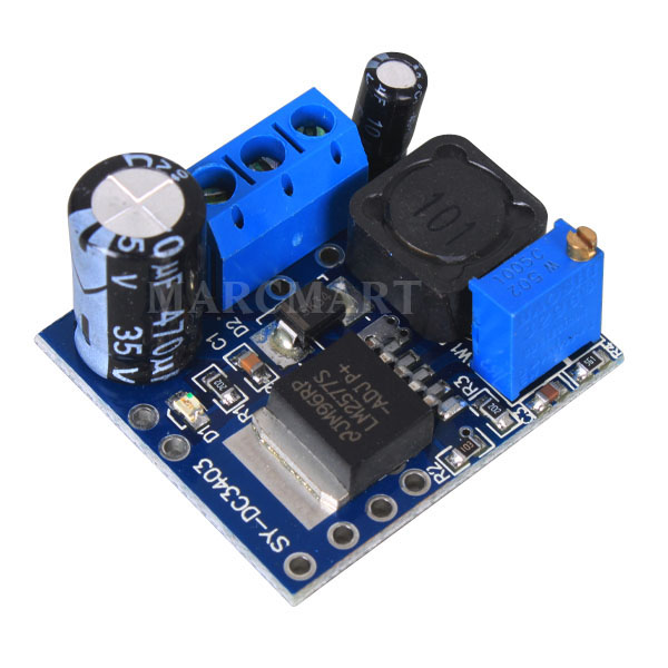

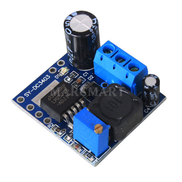

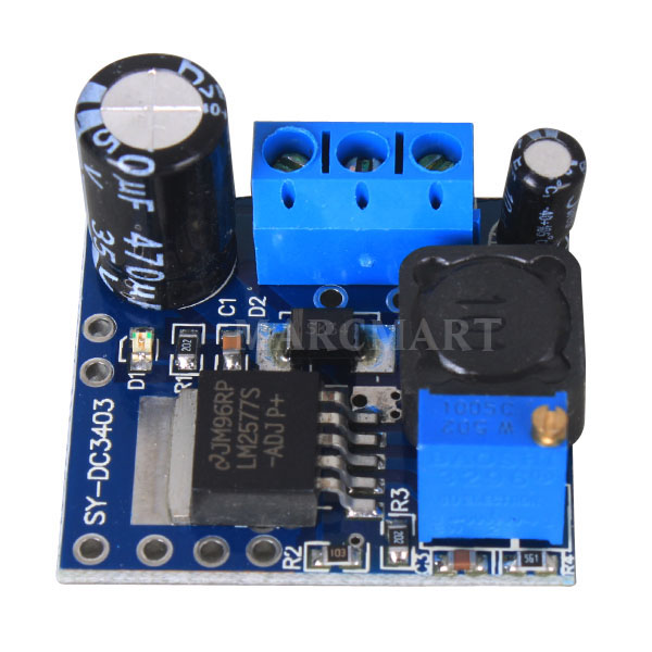

          thanks Ap. good info on 34063. i use LM2577 converter i buy from chinese at feepay. you see it in another my posting.

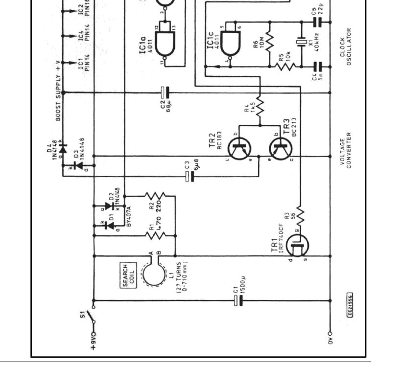

            Try the Voltage doubler set up Eric Foster used in this detector.
            Running at 40KHz, I don't think the noise would bother you.
