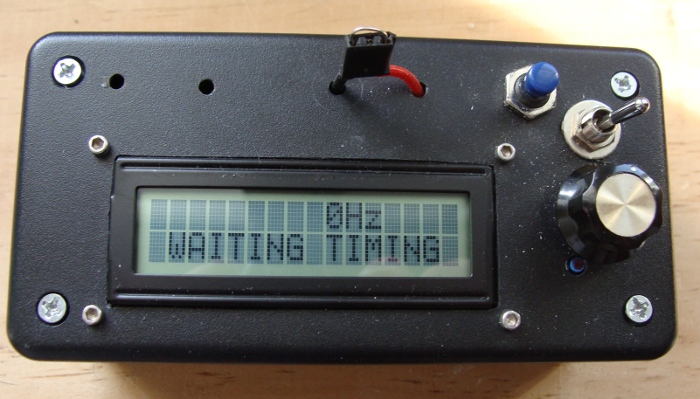

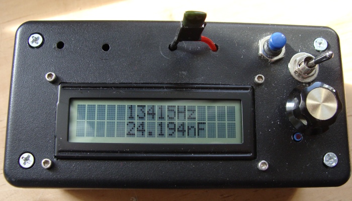

    Bought a PIC cap., induct. meter kit from Silverdog.
    Cap. meter features works fine.
    Problem is Inductance meter feature will not work.
    I took this PCB apart twice, checked everything, even used new caps and resistors, wiring was checked over and over, I cannot find the problem.
    Inductance test with short stays at 0--AWAITING TIMING

    Just a quick observation without knowing anything about this meter. Try using a larger inductance. Looks like you have just a jumper wire in the picture.
    Jerry
      Yep, your trying to test something out of the limits of the meter.
        But, per instructions for this meter:

          I've not looked at the circuit.
          It stands to reason you have a open on the Osc?
          Corrupted Code on the PIC?
                    Check the inductor oscillator around IC3a, L1, VR2, C5a, C5b, C6a and C6b. With the probes shorted (and the switch at "inductance") it should be producing a signal at pin 11 of the IC. If it isn't you probably have a little solder short somewhere or a bad component.
