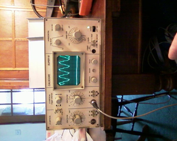

    My old Calscope which Ive had since serving my apprenticship is about 35 years old is giving trouble as in cant get nice clear cut wave forms anymore.
    Dont know wether to have a go at it or maybe change.
    Any pointers to bringing new life back into it would be handy from members here.
    Or do I call it a day and replace.

    What does it look like?
    Do you have a photo?
      Hi
      Its the super 10 calscope
        Hi

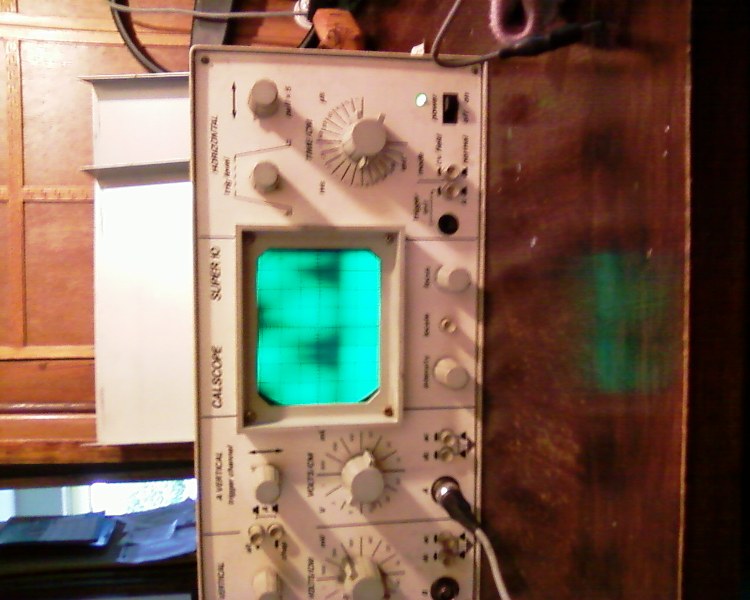

                  calscope 10 out of focus
                  Hi
                  Here is picture that shows symptom of the fault.
                  As I said previously it wasn't clear cut display but now its gone completely out of focus.
                  Checked the EHT/HT/LT lines and they seem ok, checked voltage on CRT base which vary a bit when altering the focus control on front panel but makes no difference on display.
                  Both channels are showing, channel A is showing 50hz via my finger present on probe.
                  XY and everything else seems to be working ok.
                  Any tips on this fault would be received gratefully as its in excellent condition and has sentimental value, as dad bought me it from new while I was doing my apprenticeship back in early 70s.

                    Maybe the tube is faulty.
                    As I mentioned previously, I have a Scopex 4D 10 (in working condition) that looks virtually identical. If you want it, make me an offer. You can use it to compare the two units and then resell it later.
                      You could be right, what Ive done is checked the 4 electro caps by lifting one end (Discharged before checking) worth keeping in mind as theres charge in these caps long after switching off, anyway they are OK, just need to check the 2.2m resistors theres about 4 or 5 of those and theres about 6 diodes that that are chained for voltage drop which need checking.
                      Your circuit and board layout although similar are not the same there are certain difference's incl component number IDs but managing to find myself around it.

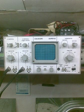

                          Fult located and cured
                          Hi
                          The fault was R614 910k on your circuit and R669 820k on mine, had gone high to 15Mohm.
                          Its located underneath the CRT shielding.
                          What a lovely layout these English machines are and easy de-soldering like the old days using leaded solder, components all well spaced out.
                          The resistor was a half watt high stab 5% and that exactly what I replaced it with from old stock.
                          Now its apart shall give it a well deserved clean before reassemble
                          Picture quality as new which you can see by the picture.
