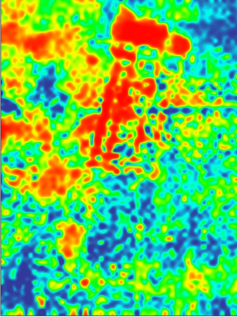

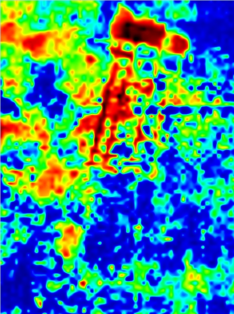

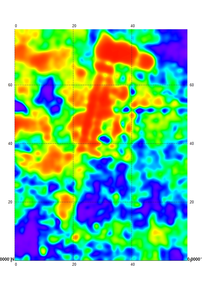

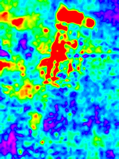

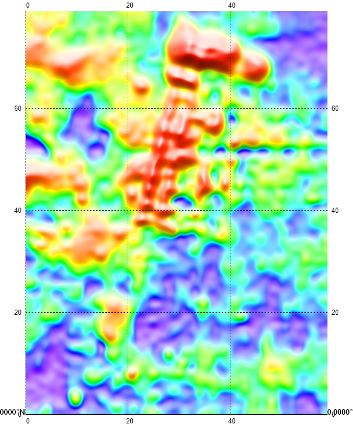

    Snuffler test data file interpreted by the MagPick, Snuffler, Terra Surveyor, and Wumap software.

        How to make image with Snuffler 'testdata.txt' file:
        Craete 'New Project' from 'File' on task bar.
        Click right mouse button on 'Geophysics Data' and select 'Create New Geophysics Data File'.
        Enter Name, for example 'Test'.
        Enter grid size /60, 80 metres/.
        Click on 'Test' label.
        Select File menu, 'Import Data Into This File', From XYZ File.
        Open 'testdata.txt' file from Snuffler directory.
        Click again on 'Test' label and select 'Preview Window' and 'Spawn Main View'.
        In 'Spawn Main View' windows you can use all functions on task bar and assemble multiple grid arrays.

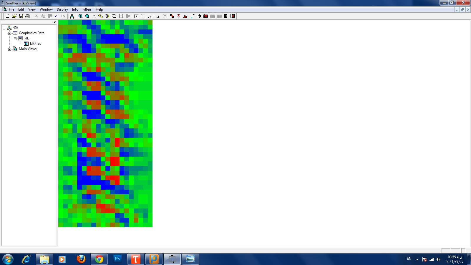

            Hi rael
            Thank's for answer .when i import data (txt file) in to grid the display is Checkered such as this image Click image for larger version
            but your test file (image) is such as geophisical image!!!!
