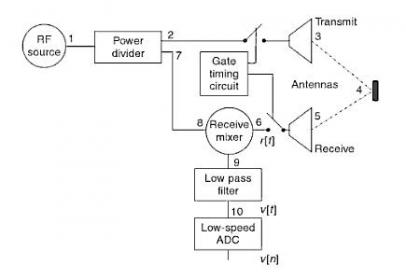

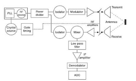

                        • what do you think of that?
                          • Hi Korrigan,
                            Both block diagrams you presented are showing a variety of GPR. This is called "Step Frequency" and from the point of view of component availability, quality, documentation and price this is the way to go. In fact there are to my knowledge two companies producing commercial equipment based on this technology, one of them our neighbor here in the North 3D-Radar http://www.3d-radar.com/. Quite successful by the way and excellent data, to the point that the military bought the company from the fellow who started it.
                            Now, independently of the way you use to collect your data your final goal is always a measurement of time, as precise as possible. So, with step frequency radar you are sweeping the frequencies over the bandwidth of interest and measuring the response, pretty much in the same way a spectrum analyzer with a tracking generator does. After your have your "trace" in the frequency domain you can "synthesize" your time domain response to get in that way your time/depth information. I was in 2004 the tutor for a master of thesis in the local university for a work similar to this and the results were extremely good. Not good enough to be commercially produced though, but still quite good. Must of the work with this approach is done in the software side, so if you are good at programming this is the way to go. Most of the components shown are available of the shelf and should not be any difficult to put together. In fact I think this might be the way to go for a "home made GPR", but you still need a good coder with some DSP background to tackle all the small issues you are going to have.
                            My best regards
                            RA
                            • It can to be too FMICW radar. If you are interested from continuous sine wave GPR see: http://courses.ece.illinois.edu/ece4...inal_paper.doc

                                If that would be the case they would not need the switches for the antennas, a FMCW don't need that. Besides, the antenna development would be a pain and way out of amateur reach because of the complexity of the tuning equipment involved.
