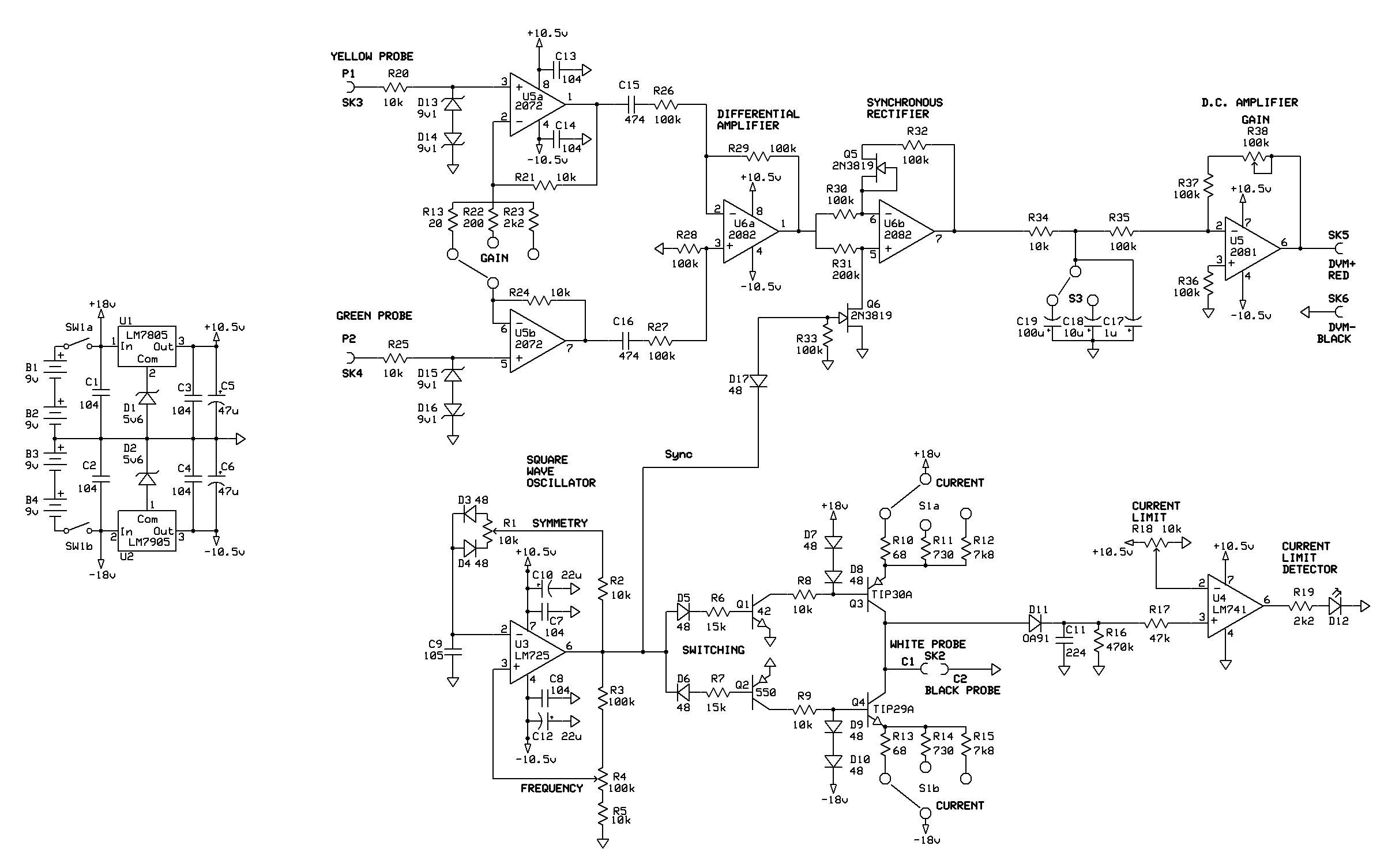

            But than; i already gave schematic for free, didn't i?
            It is Becker's schematic with some adaptations. Gain and output resistance will be switched through the menu system options with use of buttons.
            I'll try (not promising that i will 100% achieve) to add more frequencies, but main 137Hz will stay for sure.
            Also there is switching between two control ("sevice") signals and the third, the main, which will be seriously sampled and processed.
            I did it like that because of lack of pins at Atmega. So in interrupt i will sample the main signal and take as many as possible samples of it, while in a spare tics i will take occasional samples of
            two control ("service") signals and probably display them somewhere on LCD. Maybe also store them in the same pack of data for a column\row.
            I don't know if that is relevant and important. Will see.
            In case you don't need those two pre-samples; you can omit U1.
            I just noticed two "U1" which is mistake. My mistake. There are two CD4052 and are not the same "U". Should be enumerated. I will correct that.)
            Also on schematic there are leds that are about to be used in developing stage.
            Later on not planned on device. But can be also used to save space on LCD, or on device version without LCD.
            I also gave truth tables for all three switching circuits.
            So, it is still Beckers resmeter in essence. But adapted for Atmega32P and with compromises that came along.

                • Robert Beck did also a good job here:
