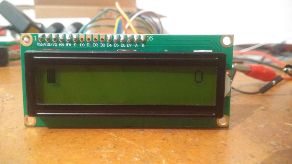

      • Good evening, I made the earth resistivity logger but when I open it it shows a bar on the left and a 0 on the right.What's wrong?
          • Hi
            Where can i find the software for the epe resistivity logger?
            • Download the Snuffler, you just have to make some changes to the circuit. There are old messages that say what you should do.Does anyone know how we change color and design in Snuffler?

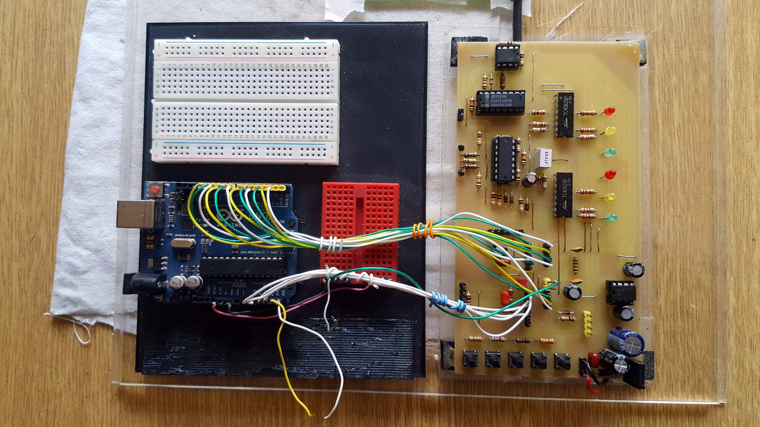

                In the same spirit as i did with magnetometer; i am making preparations to modernize also EPE resistivity meter / logger.
                Yesterday i draw this "sketchy" schematic, sort of proposal, how it may be done.
                Lot of details to take into considerations yet.
                One step at the time.
                This is just first step.
                [ATTACH]51154[/ATTACH]
                I made "development system" for this.
                Now i am writing code for it.
                In meantime i noticed certain issue related to power supply.
                The whole setup from the attached photo bellow is draining 170mA !!!
                This is not acceptable.
                Than i take it a part and measured current drain separately.
                Resmeter board draws 47mA which is acceptable.
                Later when i add SD card module and BT module; power drain will rise to 60-70mA, which is planned and acceptable frame.
                But Arduino UNO board + I2C + LCD draws 120 mA !??
                While I2C + LCD draws 55mA???
                Overall this presents too much load and i had to stop and analyze the problem.
                In final design it will not be Arduino included but only Atmega328P.
                Also at present i had only one old obsolete and HUGE 16x2 LCD, which draws too much current.
                So i had to order newer and smaller (standard) 16x2 LCD. Still waiting to arrive.
                So... this will add certain delay in my work.
                And i will probably have to redesign the power supply stage.
                I will also check other UNO's that i have here on their power drain.
                In meantime i do write some parts of code which can be accurately done without development board.
                Also i am analyzing the "tactics" on handling and operating the future device.

                    • Standard 16x2 LCD arrived.
                      I hooked up I2C on it.
                      24mA overall with full backlight On.
                      Comparing to previous 55mA.
                      Now i am getting somewhere...
