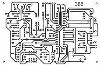

      My friend Ivconic, there is nothing to said sorry for, cause the pcb i made is the same from the EPE 2003 and conections are fine, that means that my pcb already has the tracks as you pointed out.
      Here i m sending the pcb i made from the magazine.
      Instead of that, i will keep looking foward to find the problem. The pic has i said earlier, is 16F876, not 16f877 and i dont know if this could be the problem.
      Thanks for your time and i really understand that doing mulltiple things can confuse anyone.
      I wish my problem was the one you said, but is not and i still have it.
      Take care and best regards
      Nelson

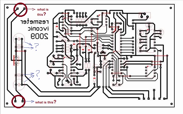

      Nelson....i am very sorry!
      My mistake!
      If you used my pcb than i now what is problem!
      I made few small (yet bad) mistakes on that pcb. I missed two connections.
      When made it i also had same problems as you and after couple hours of scratching head i founded out! Two missing connections!
      Sorry, sorry, sorry!
      I totally forgot that ! I forgot to post corrections later! Until now, nobody asked me about this so i forgot to post corrections!
      Ok...to solve that problem is VERY EASY! Don't worry.
      Look on posted picture and apply those two changes. Just connect those traces and your problem is gone forever!
      Sorry again!
      Best Regards!
