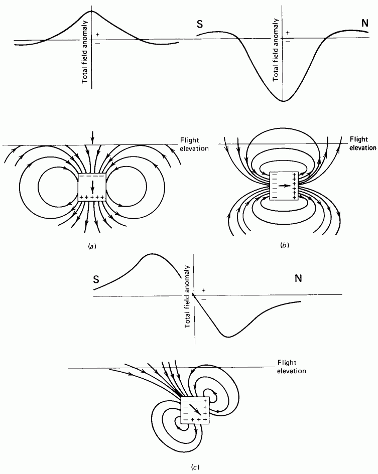

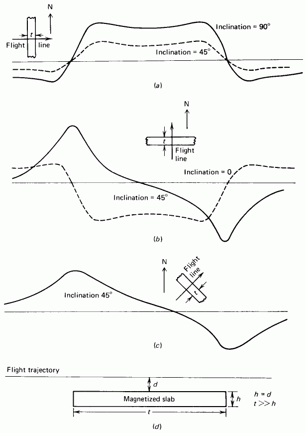

    I'm using Fluxgate Mag But still do not know to specify depth I start survey using Snuffler , Any kind of help about depth
      The images of this kind of software do not give information about depth.
      Some software as "Terrasurveyor" have function "Trace" for analysis of each line of the magnetometer survey.
      "The shape of these magnetic "anomalies" indicates the location and approximate burial depth of the anomaly sources."
      Look link bellow.
      http://www.geo-app.com/techniques.html
      http://gravmag.ou.edu/mag_interp/mag_interp.html
