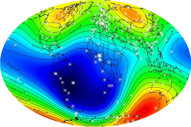

                What about the "tuning", it is suggested to go on the field and experiment with several
                capacitors to get the best tune with the frequency of precession in the place.
                I do not know if the Huggard had the information that we have today relative to
                frequency of precession, so that it now is possible to make the process "tuning" in the lab.
                Here in my area we are under the effect of SAA (South Atlantic Anomaly) or SAMA (South Atlantic Magnetic Anomaly)
Name:	Total Magnetic Field for 2000.jpg
                the frequency, using the model IGRF11 is 22.648.6 nT.
                42.57638811 x 22.648,6 = 964,2955837 herz.
                Using the capacitors C4, C5 and C9 suitable for resonant circuit producing the
                same frequency precession, the magnetometer, will be tuned and finalized.

                  You must be very carefull with the calculation of C4 @ C5 because the input inductance is the inductance of T1 parallel with the inductance of L1 @L2. The best way is to give a signal via a loop at 965Hz and to try to tune it. For my City the frequency is 1950Hz.

                    Baterista can you give the adress so to download the magnetic field map

                        Thanks Geo for the information, the capacitors also has an inductance, in his opinion they can be ignored?
                          Ok, this is the link.
                          http://www.ngdc.noaa.gov/geomag/operobs.shtml
