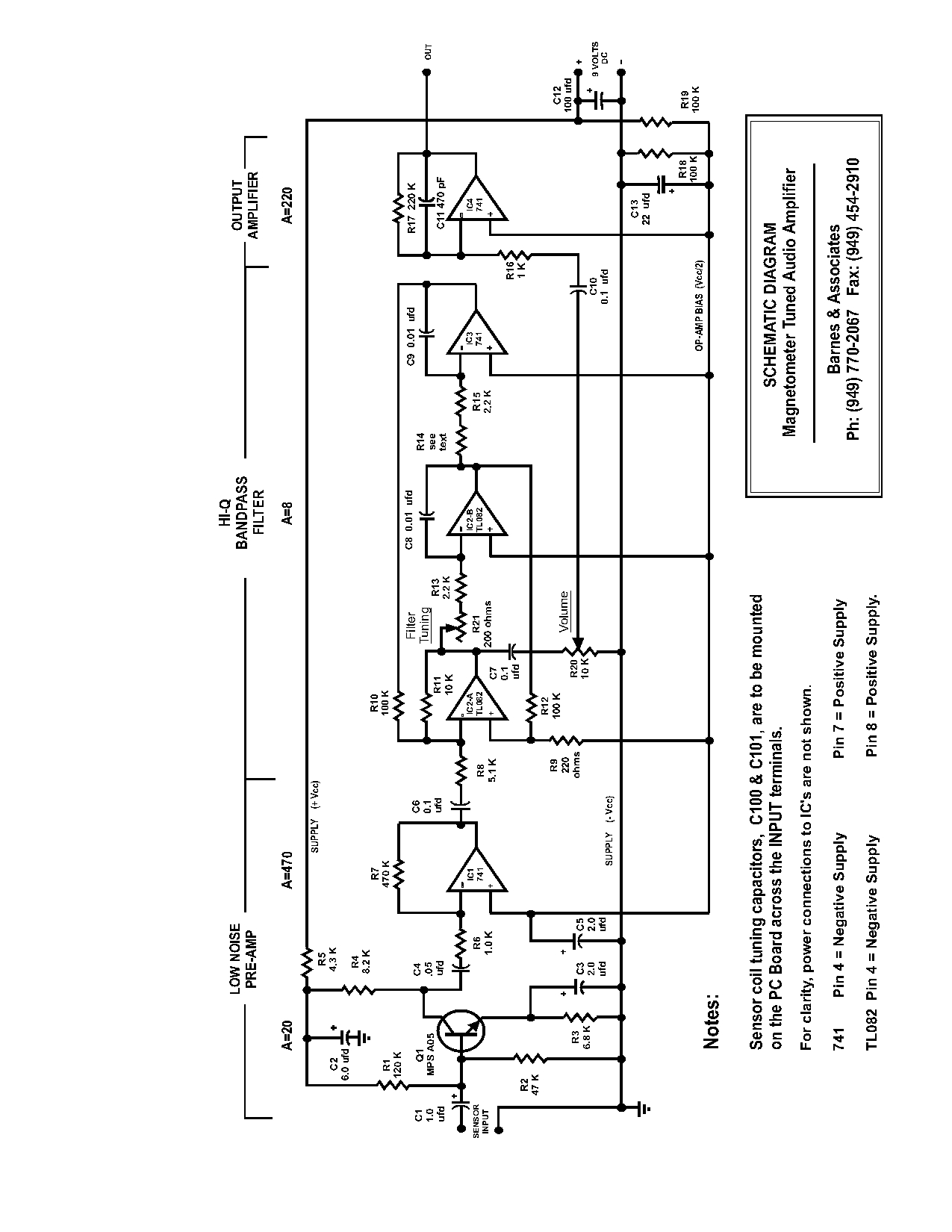

    • #47

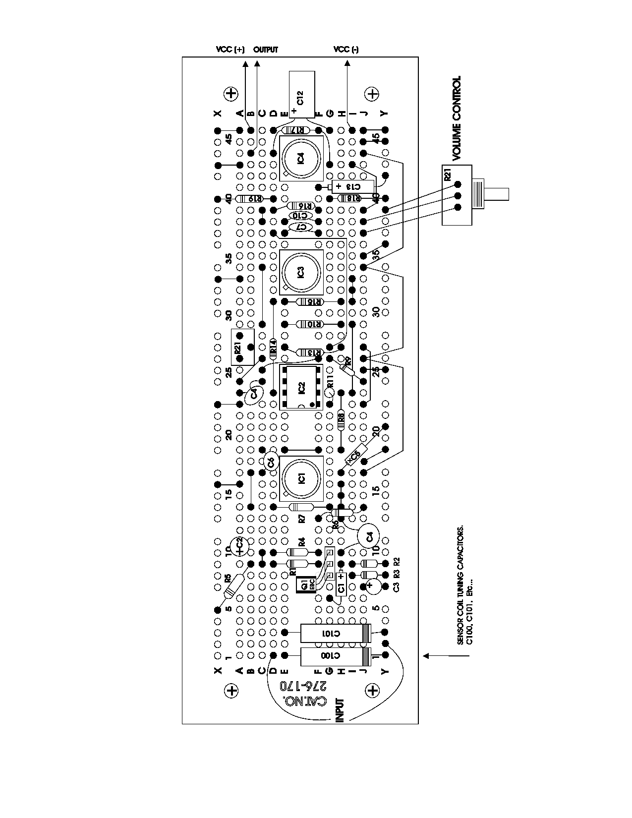

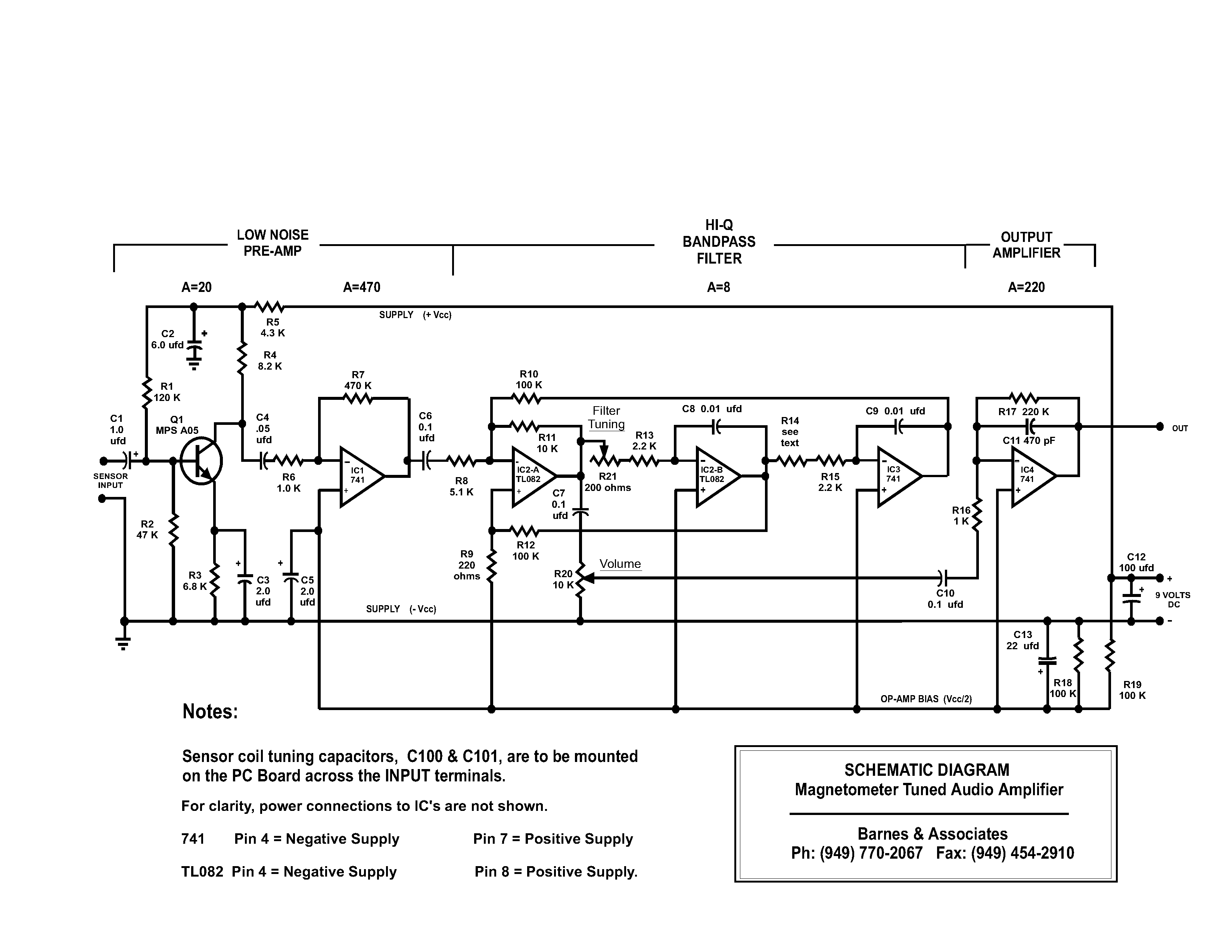

      but to am sure i design a new pcb for another schematic of main amplifier.
      Maybe this can help.
Name:	Magnetometer Tuned Audio Amplifier.JPG
      • #48
        [ATTACH]25365[/ATTACH]
        Hi.
        Do you have more details about this schmatic? as filter frequency or pcb????

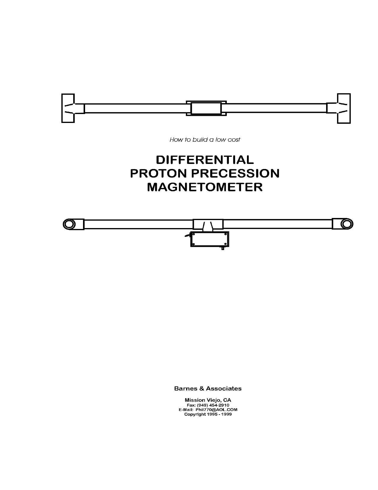

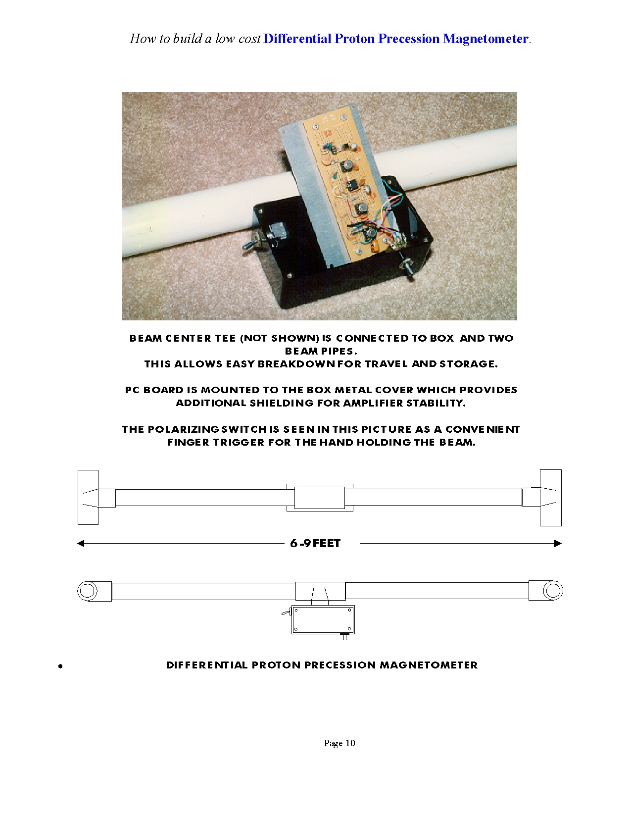

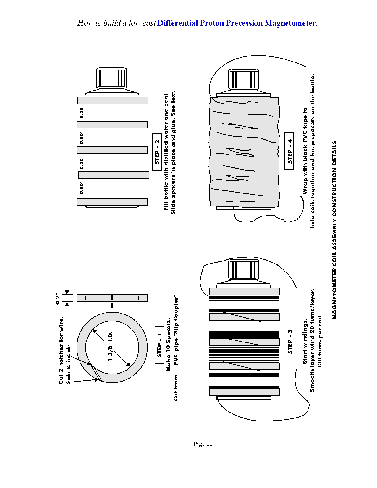

        • #49

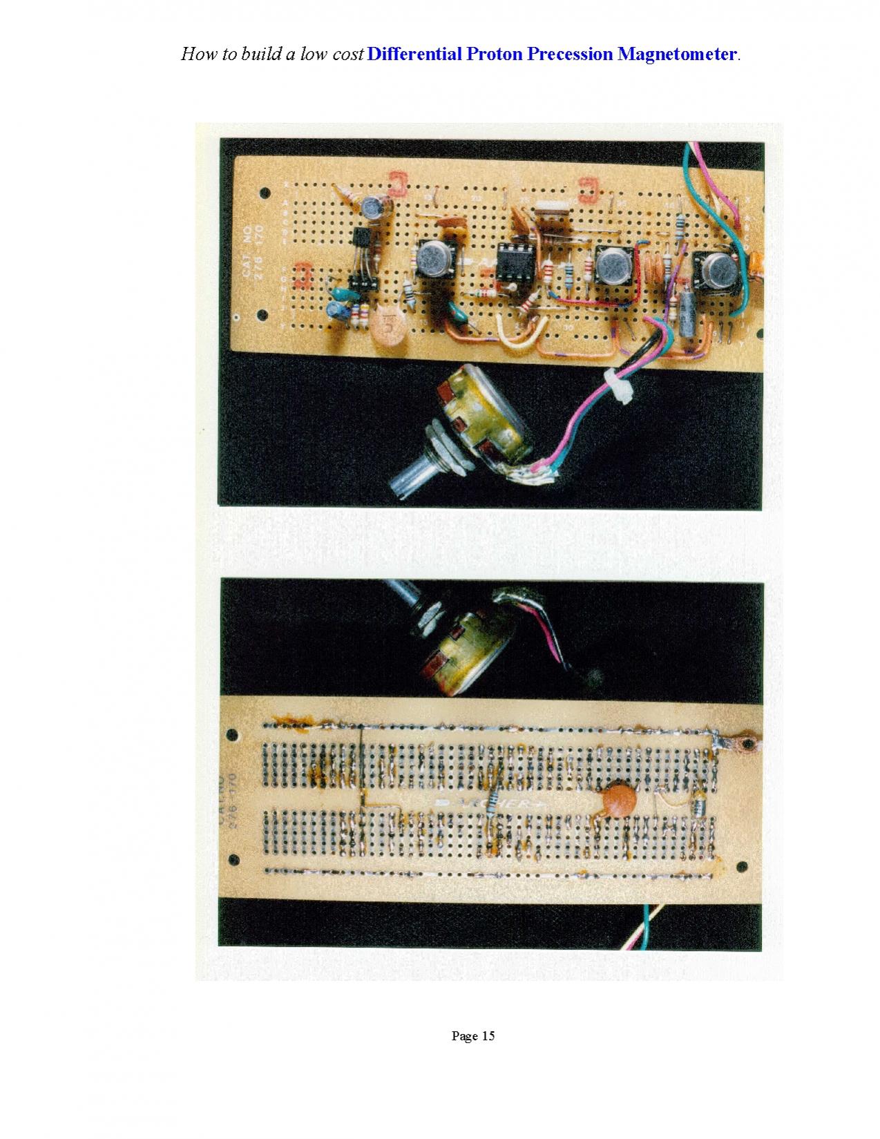

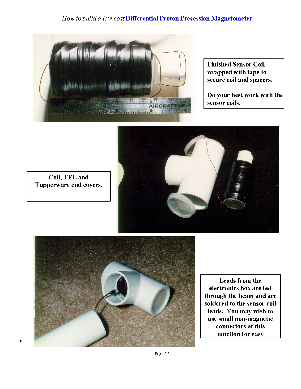

          Ok, Geo, this is all I have regarding this magnetometer.
          Pag. 1 and Pag 2

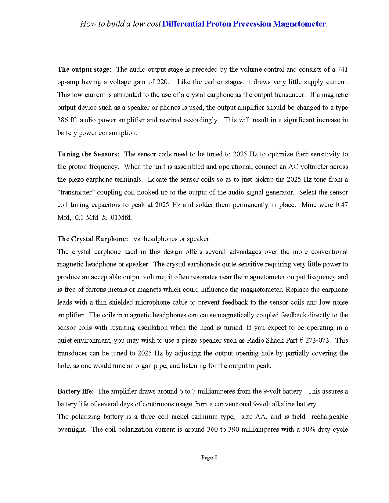

          • #50
            Pag. 3 and Pag. 4

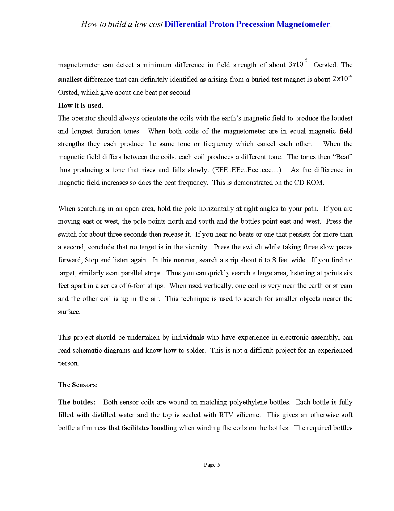

            • #51
              Pag. 5 and Pag.6

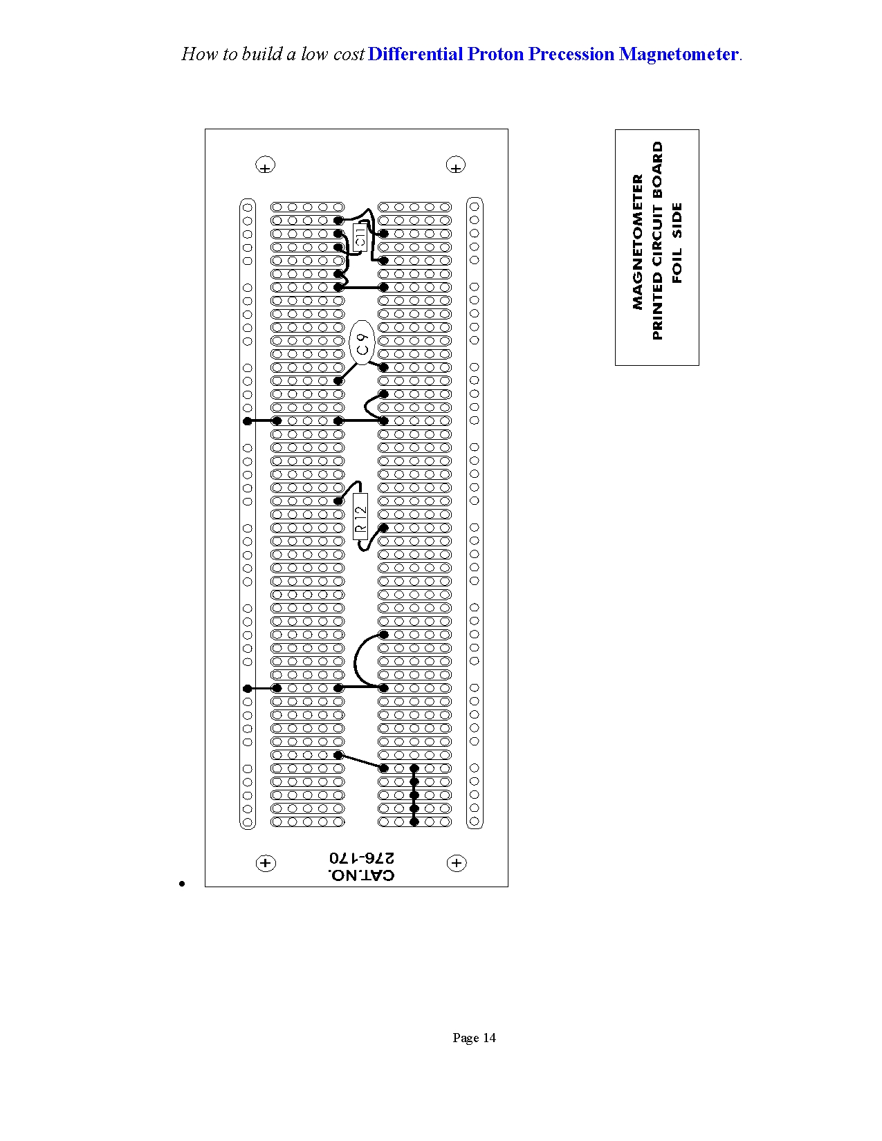

                  • #54
                    Pag. 11 and pag. 12
                    • #55
                      Pag. 13 and pag. 14

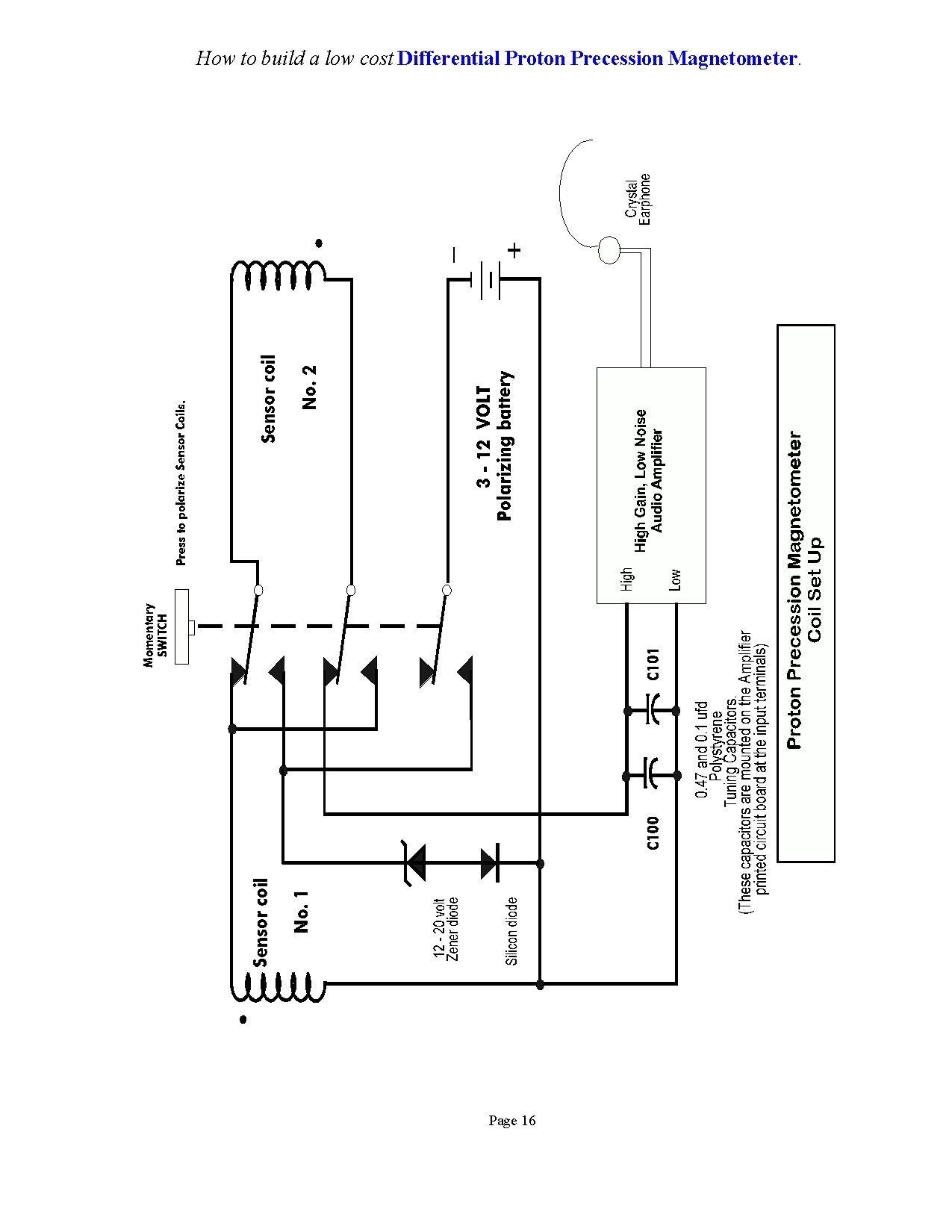

                      • #56
                        Pag. 15 and pag. 16.
                        • #57
                          Pag. 17 and pag. 18

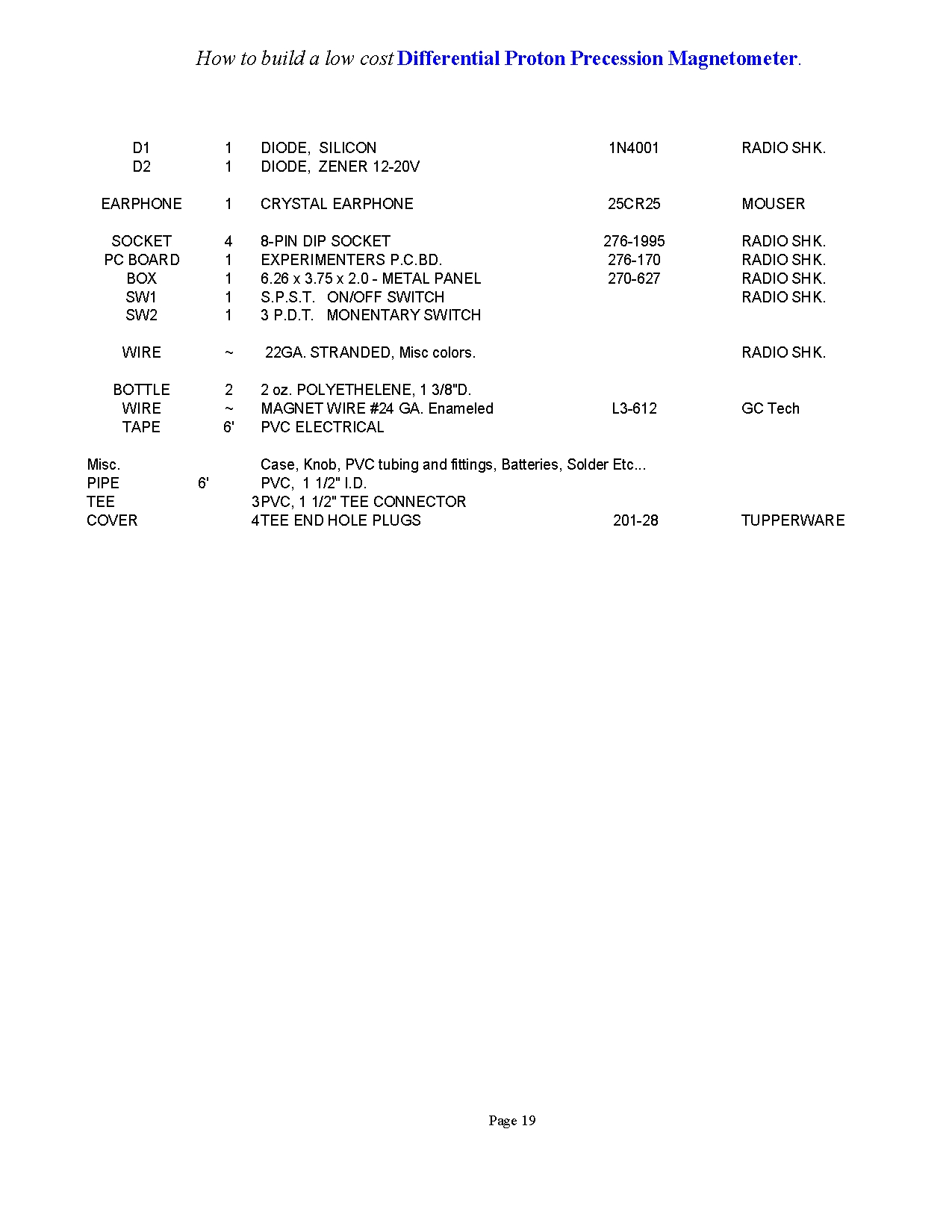

                          • #58
                            And finally page 19.
                            • #59
                              Ohhh ..... what to say????
                              Baterista, a big Thank You
                              • #60
                                Here is a slightly compressed pdf made of these images for easier reference.
