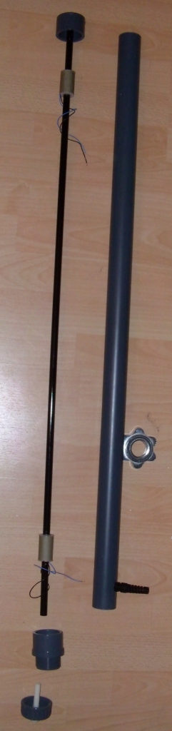

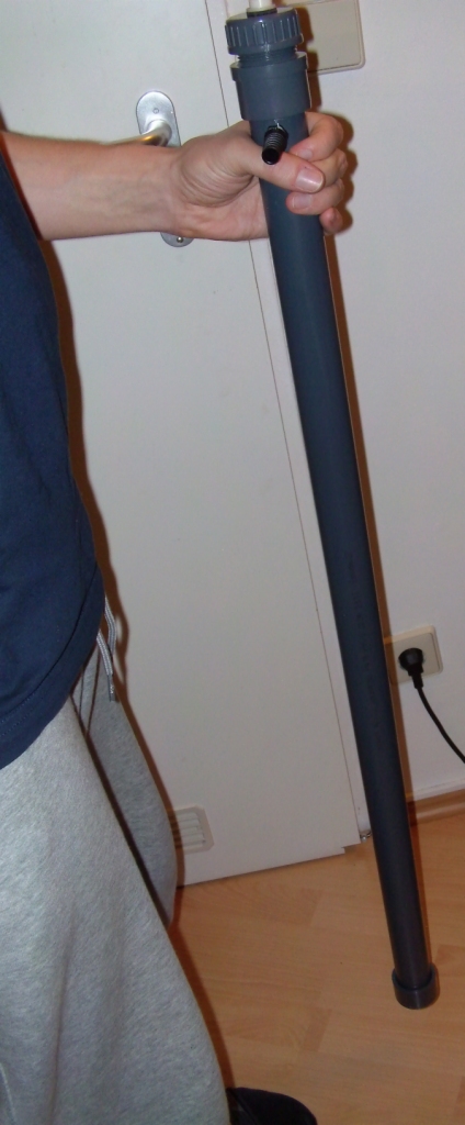

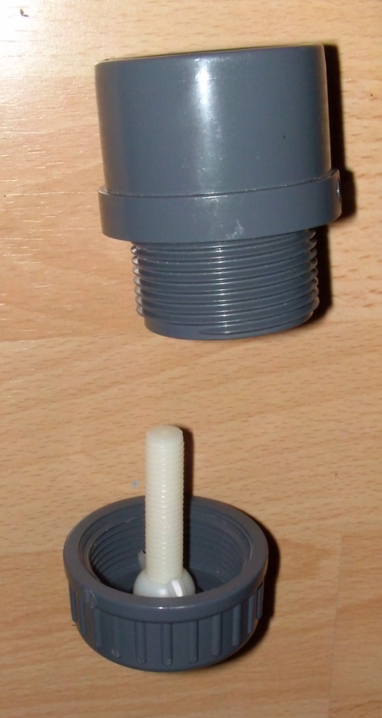

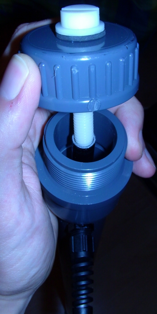

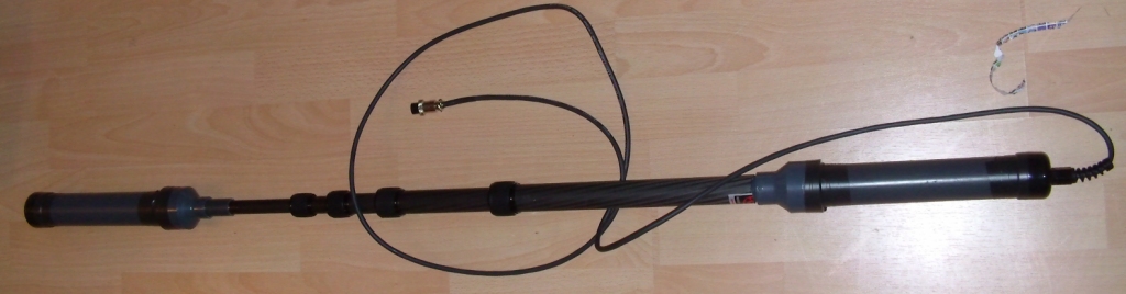

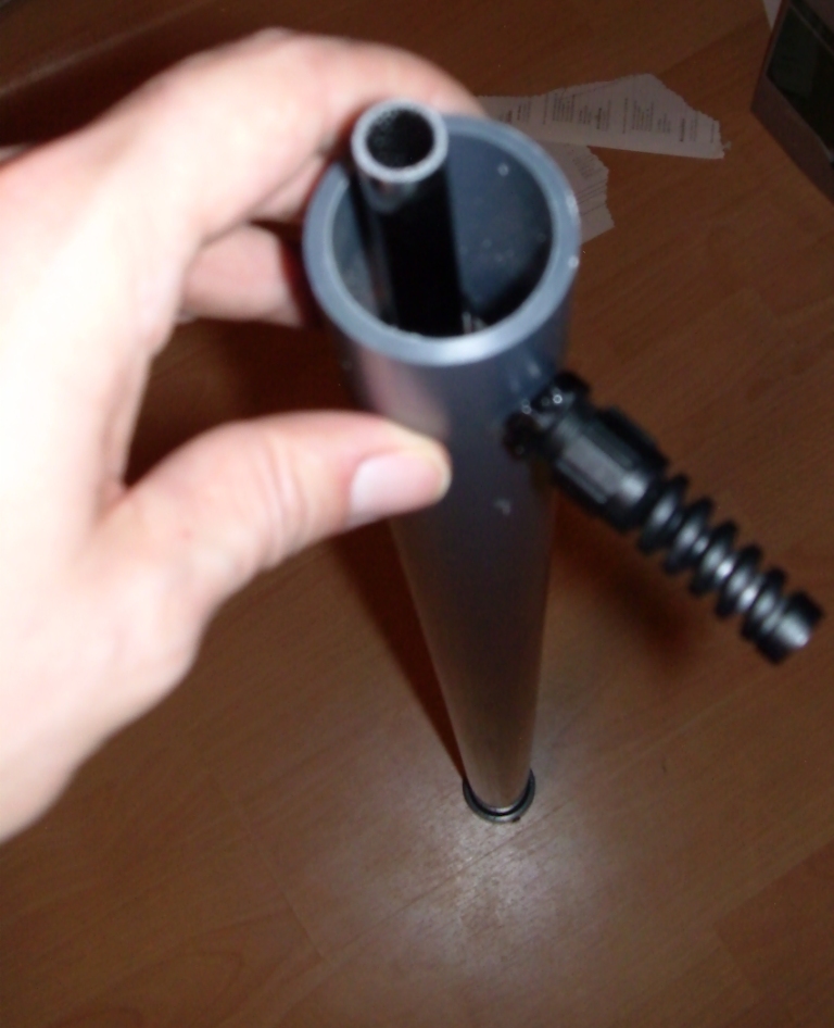

    hello guys,
    just want to show my way of sensor mountig for an easy mag.
    hope it helps others.
    if i have success with the unit it will show more details
    kind regards

    hello, can you give me details.thanks
      yes i can do, but first i need to make this unit working, won´t blame myself hope you understand

            yesterday we were out on field to test the mag
            wow its like a big pinpointer for iron
            i think it is ready to show

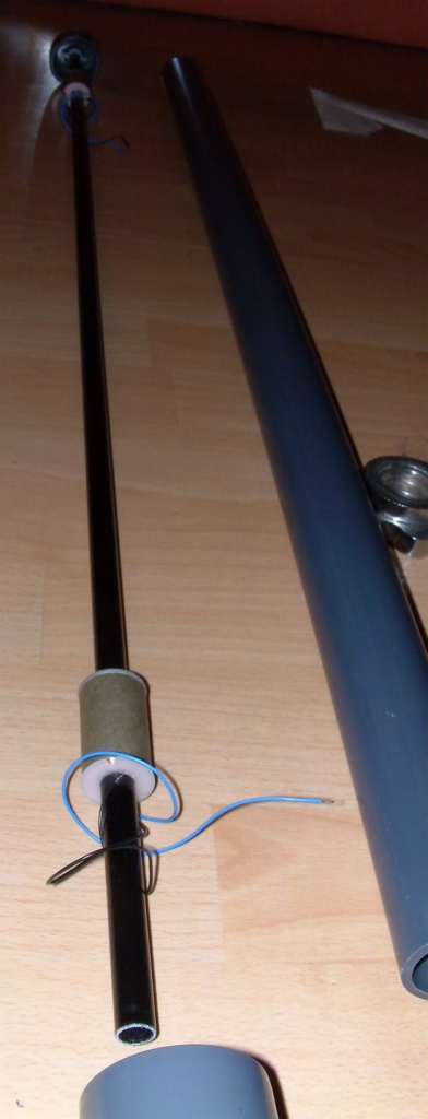

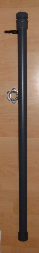

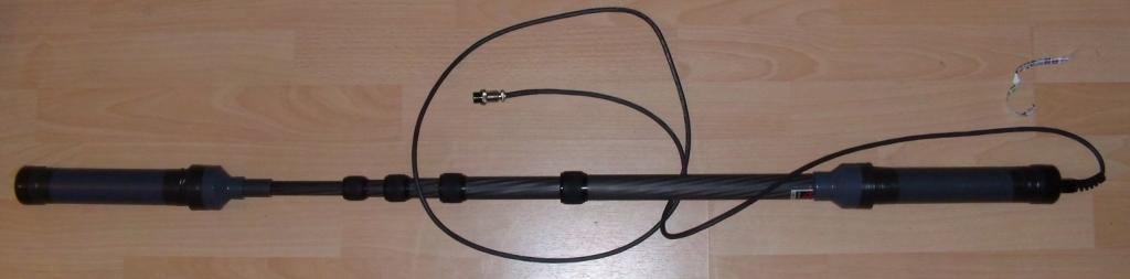

              made a new version with sensors of bigger 16mm ferrite core coils and on carbon monopod around 60cm - 200cm variable.
              next try on field i will make a video, hope i find no ww2 explosives while filming
                new version of sensor

                  Retractable, very good, great job.
                    been reading about mags and some use a quartz tube to mount in. hard to find Id guess, incredibly stiff for the mass and thermally stable.
