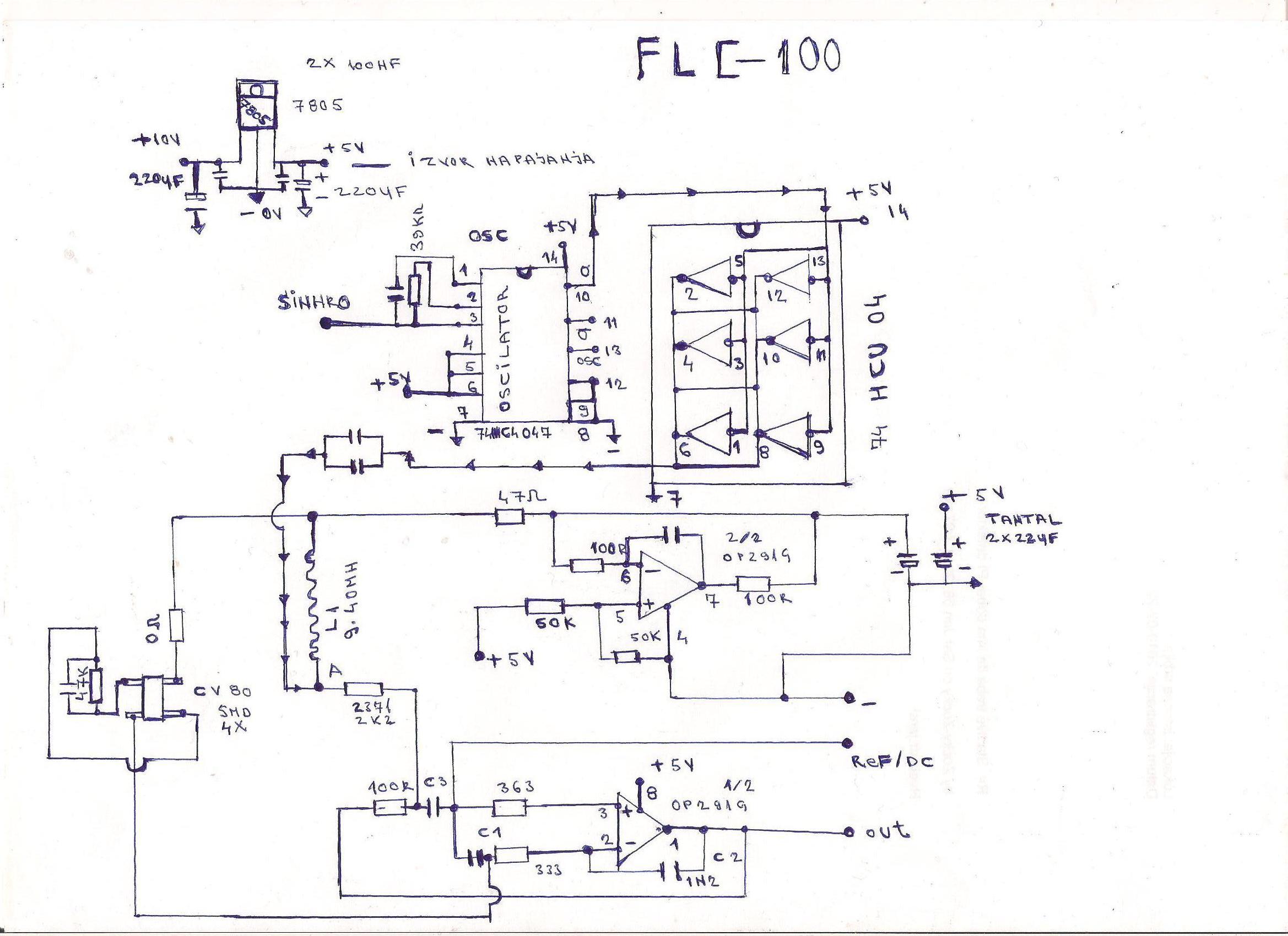

                            Adding to the discussion, FLC-100 schematic. This sensor is driven vs self oscillating.
Name:	fluxgate  flc100 sch.jpg
