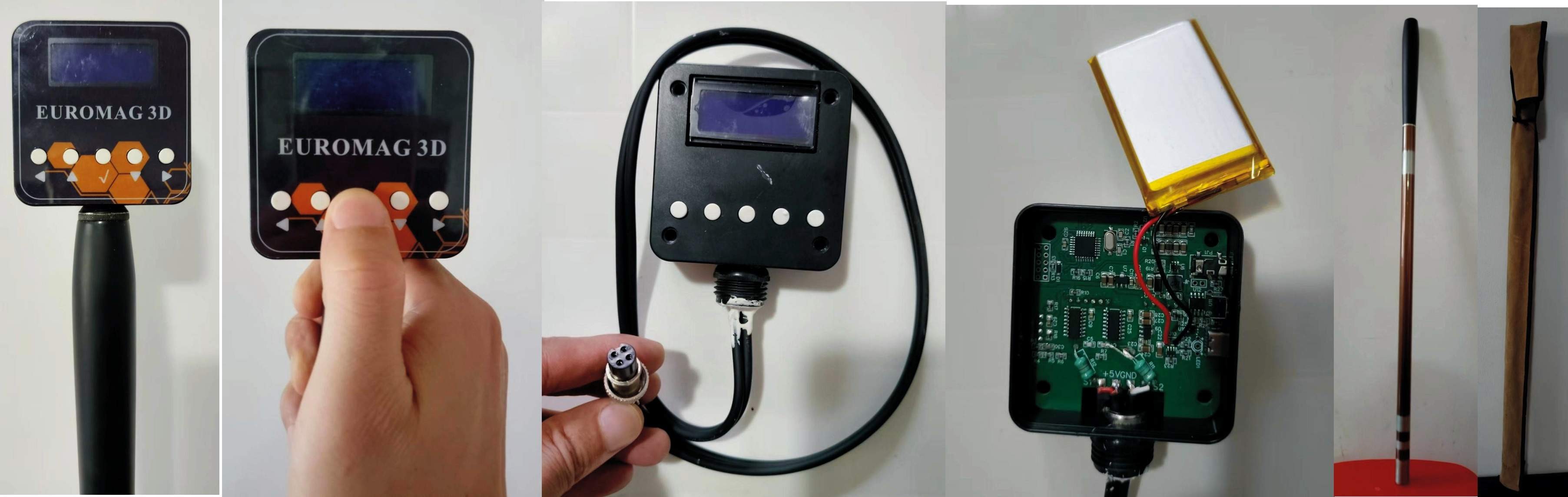

    Originally posted by Credov View Post
    I have one account and I found out about your forum only after I found and bought a product on Aliexpress.
    If I turn on the device through the charging port, why is there no voltage on the contacts, where I understand the battery should be connected!?
    And why does the Lidarking device turn on from the charging port?

    I purchased 5 complete kits, all five had missing parts, 3 off them wont start powered up even holding start button more than 5 seconds. I tried different power adaptors from 1amp to 5amp usb etc, still the same these are poor quality, I was planning to buy lots more, but so far its really put me off buying from any chinese outsource.
    They are faulty units until its resolved from seller these are not great kits, no wiring diagrams to make a safe solder, if people on this forum would stop judging new members about this and help show plans, show videos of how great this unit is to build, show plans on where to wire things HELP us and stop being judgemental .

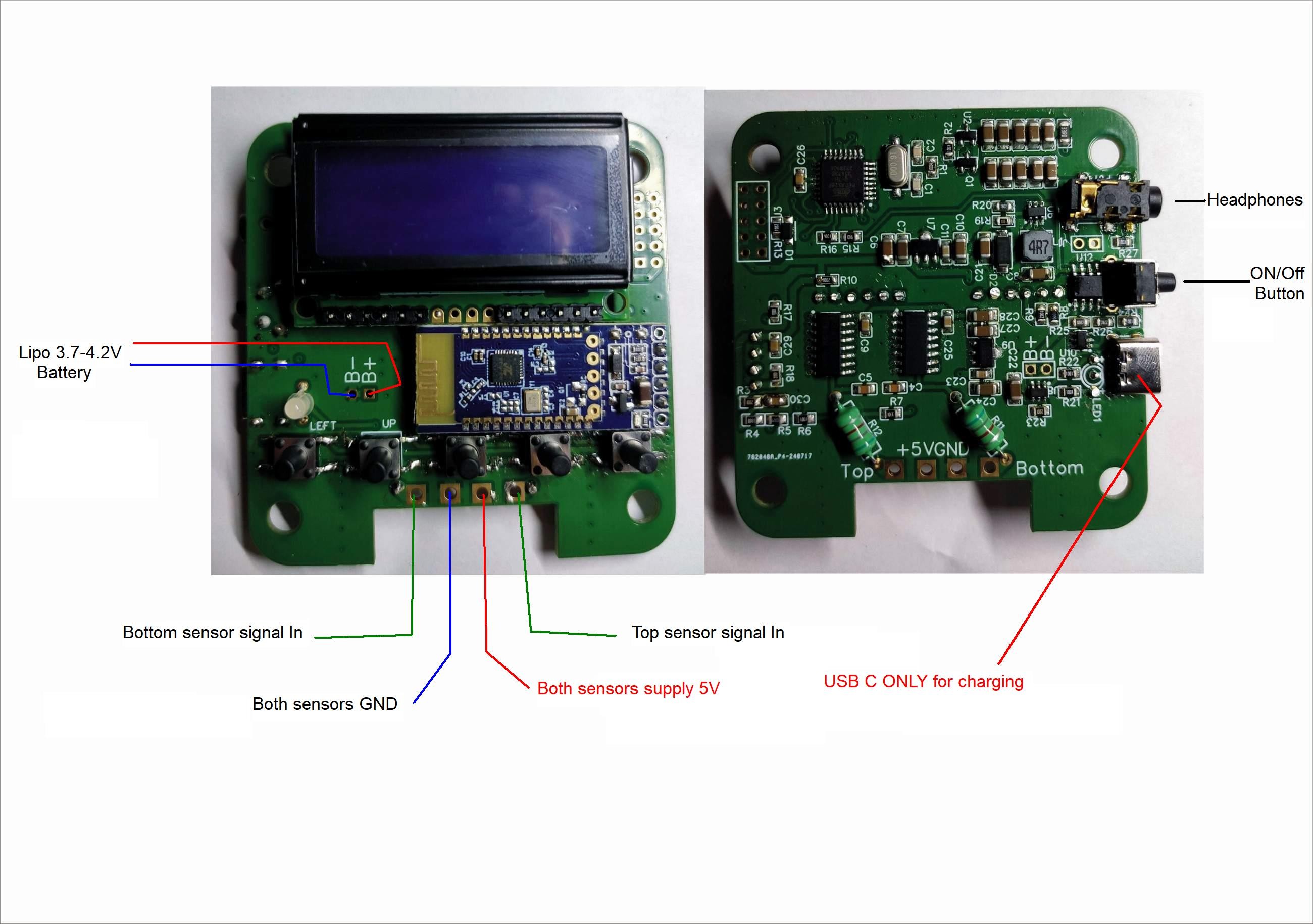

        Ok, so that the other fair members of the forum don't think I'm exclusive, I'll repeat in detail:
        The type C port is only used for charging.
        The 3.7V lithium-ion battery (similar to a mobile phone battery, with a protection board) is connected to the B+ and B- of the main pcb.
        There is a charging circuit, a one-button power On and Off circuit, a DC-DC boost circuit, and a 5V voltage regulator circuit on the pcb.
        The charger can only charge the battery, and using it to power the motherboard is unstable.
          To start the device, do the following:
          1) Install a 3.7V (4.2V full) LiPo type battery.
          2) Make sure the battery is full, if not; plug in the charger to charge it.
          3) When the battery is full; turn off the charger.
          4) Press the "On" button for a maximum of 3 seconds. The device will start.

                    I applied 5 volts to the board and the device did not start.
                    It does not respond to the power button, but the display backlight immediately lit up and the Bluetooth module LED began to blink.
                    What's been done wrong now?
                    https://drive.google.com/file/d/1LGq...sdrieqdpa/view
                    https://drive.google.com/file/d/1X7l...lVDZRjLmR/view
                      On Aliexpress they told me that power should be supplied to contacts B+ B-, 3.7 V.
                      Without instructions it is not clear what and how to do - especially since the board does not indicate that the power supply is 3.7 volts.
                      I will test it soon and write about the result.​

                        Credov... you will do anything possible - just not what is right!
                        You brought 5v to the sensor power points!
                        Ha, ha, ha!
                        Is my English that bad?
                        Is it so hard to understand what I wrote in previous posts?
                        Is it that hard for you to understand that you need to connect a regular 3.7v Lipo battery to points B+ and B-?

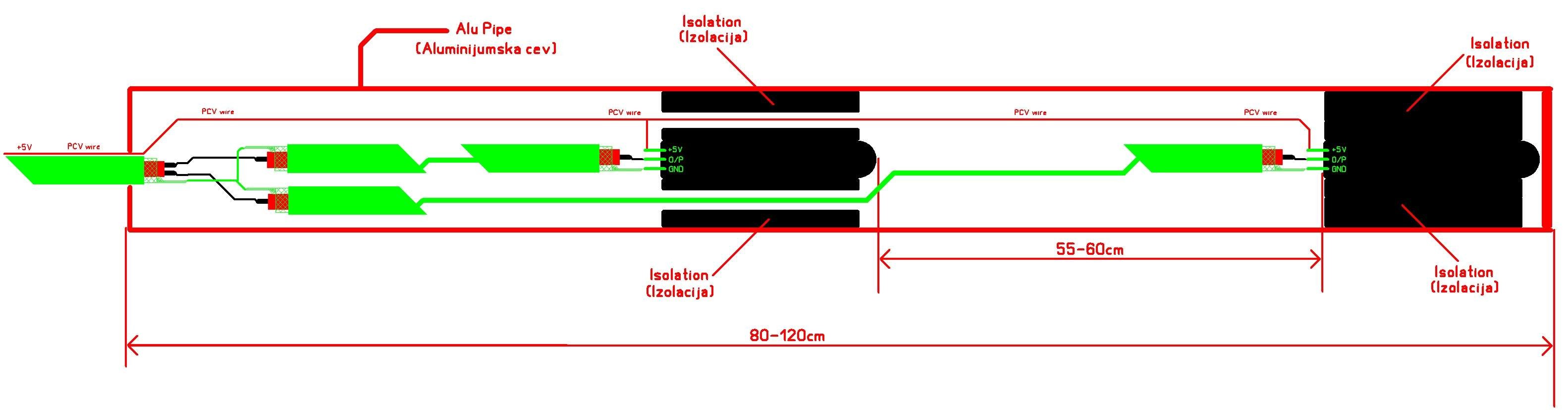

                          • #43
                            • #44
                              Hope this helps?
