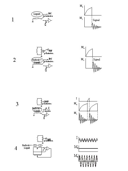

                  Actually, there are 4 different types of PPM's:
                  1. The traditional one with DC switch off only and pure proton-rich liquids
                  2. Polarization by DC switch off + AF excitation of free radicals based liquids.
                  3. Polarization by short impulses + continuous AF excitation of free radicals based liquids (GEM systems).
                  4. Continous AF polarization by whose frequency is controlled by feed-back of precession frequency.
                  I think that the one you have in mind would be the last one.
                  Willy

                      That one seems to be the third one of my previous list.
                      The traditional DC approach requires a polarization field of 100 to 300 Oe while the pulse system only requires 0.2 to 1.5 Oe to get an effective value of 200 to 1500 Oe.
                      Willy

                        What is the HF in your exampel 2-4? Is it proton nuclear precession frequence at the earth magnetic field or is it the electron spin reconance frequency??
                          Re: Polarizeing current
                          the electron spin resonance frequency.
                          Willy

                              This figures come from the article writen by V. Sapunov, etl, Quantum Magnetometry Laboratory, Ural State Technical University ??

                                Yes, I guess the easiest system is shown in the second figure. It just requires that you mix a free radical powder with the proton-rich fluid and that you excite the protons with an RF frequency during the standard polarization of the coil.
