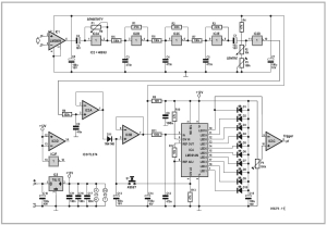

    Simple Magnetometer project found at follow link:
    http://www.elektor-electronics.co.uk...rt=53325&PN=On
    Using 220V/12V mains transformer for sensor.

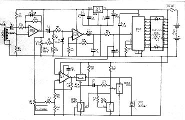

    Andy Flind's project on EPE (January 1995) is based also on transformer. Signal shows via 10 leds and audio variation. Uses common chips. You can modificate it for various purposes.
      Hi Both of them looks easy .
      but I can not get image bigger and clear.
      so can not see components.
      can not you give larger resolution pics.

        Larger resolution pics found at:

          did you build this magnometer?
          do leds shhow increase and decrease of filed strength.in other words for positive and negative fields.

              Not, I never try this. I think Gradiometer is better, if You have HMC1021S sensors.

                You can use the HMC1001 magnetoresistive sensors too, instead of the HMC1021S`s . And even the KMZ ones.
                If you want to experiment you could salvage the magnetic sensors out of an old disk drive, (most have 3, they`re even smaller than the 1001`s, bout the size of a match head....lots of fun to solder without small tip and fingernails, even more difficult to align).

                  why do you think gradiometer is better than this.
                    Gradiometer and induction magnetometer are different things.

                        I think, transformmer sensor have insufficient sensitivity for field research use.
