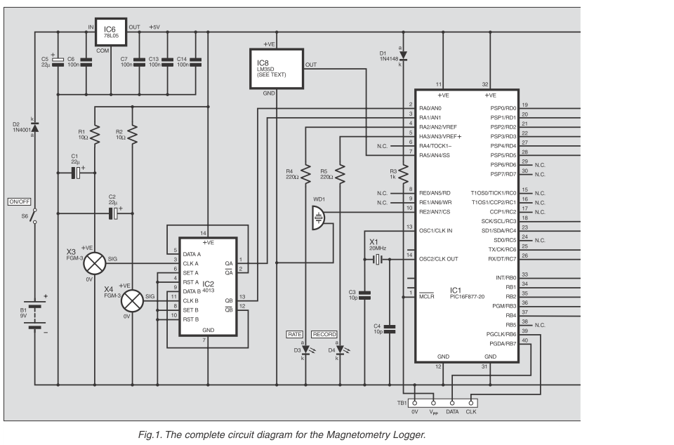

    For FG-3+ no need RC filter. It is integrated inside sensor.
    For my logger I did add also schmid trigger on input. Result are much better
    I will try with a Schmitt trigger...
    • Originally posted by amitech1982 View Post
      Hello.
      I made an LC filter (L = 6.8uH and C = 560pF) as indicated in the article, all close to 4013. I then attached to the device a single sensor with 3 short threads 15cm in length, but unfortunately, the problem persists, and the frequency reading is still unstable ... I do not know where the problem is.
      Have you looked at the signal with an O'scope?
      It should have clean square waves without jitter.
        Unfortunately, I do not have an oscilloscope to check. Do you have another idea to check the sensor output? I can build an oscilloscope on Computer?
        • I tried 74hc14 schmitt trigger and unfortunately the same issues, have not changed anything ... either microcontroller firmware is not compatible with the sensors or sensors have a problem ... but strange that there are several projects used these sensors and never talk about these problems ...Mag-Schield for exemple On the fgsensors.com site.

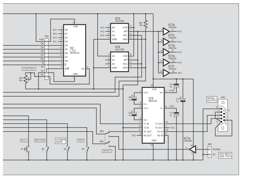

                • Can the scheme for EPE ?
                  • Originally posted by Suhoj57 View Post
                    the complete project schema.
                        Thank you ! Who is the orbit ?I'm a beginner and you are cheeky or kidding.
