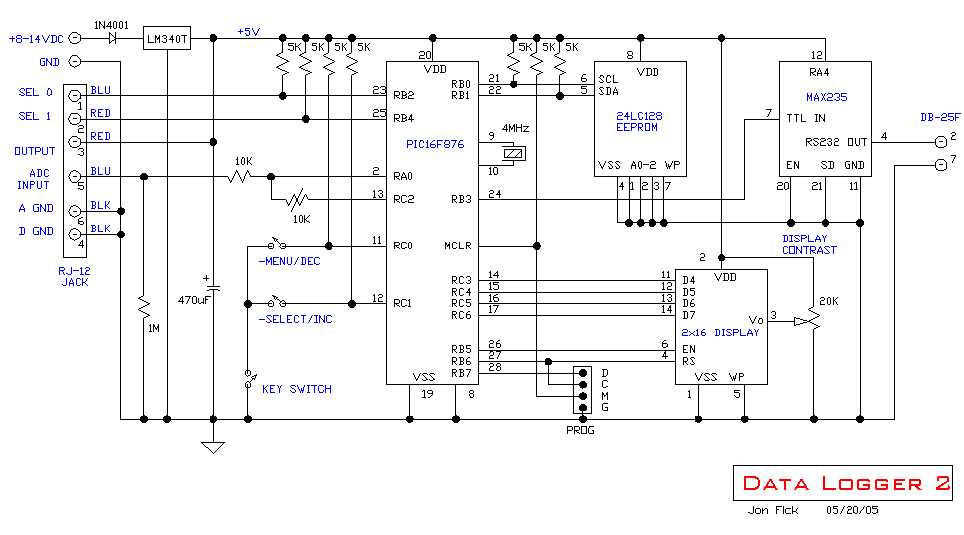

    Jon Fick’s data logger
    Did somebody try to build Jon Fick’s data logger?
    C source is included. Found at:
    http://www.vermontficks.org/datalogd.htm
    http://www.vermontficks.org/datalogs.gif
    http://www.vermontficks.org/datalog5c.htm

                              Does enybody knows what is the correct data logger for :
                              Magnetometer-Gradiometer Kit by Carl Moreland in the site:http://www.fatquarterssoftware.com/product.aspx?id=12
                              please give us some directions
                              friendly epitopios
