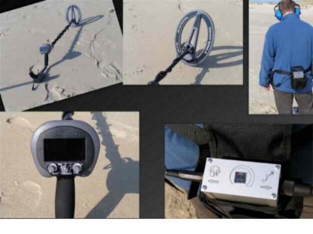

            A new french partner has joined our development team. He is developing a family of metal detectors and has all the capabilities to take care of the mechanical assembly of our PPM system. He has a large stock of boxes and non-magnetic sticks and can provide all the necessary parts and connectors to nicely and professionally integrate our set of electronic boards.
            Moreover, he is used to deal with a coil winding company who couldbuild and provide the sensors to us.
            Last but not least, he has all the necessary contacts with a network of french retailers who seem to get requests from thier clients of magnetormeter systems cheaper than the usual commercial ones.
            This all means that we hoope to be able to supply not only a kit of electronic boards but also or semi-finished or finished systems.

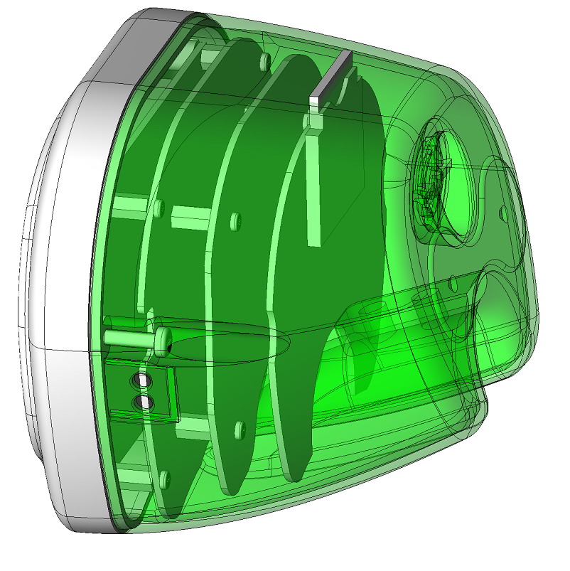

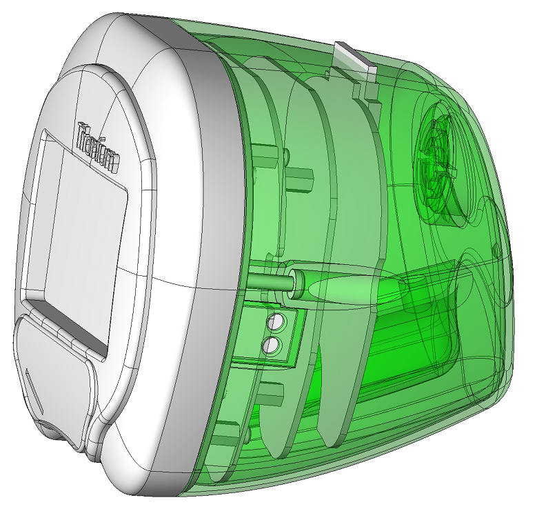

            In order to insert our boards into the existing boxes, we had to modify their shape. We also have designed a third board with an SD-Card socket and an optional internal GPS module.
            The batteries of the system will be Li-Ion or LiPo type with a total of 4400mAh to be carried ona special pocket attached to the belt of the operator. These batteries are the lightest you can find for a given energy.
            I have attached a few pictures which could give you an idea of what I am talking about.
            Willy

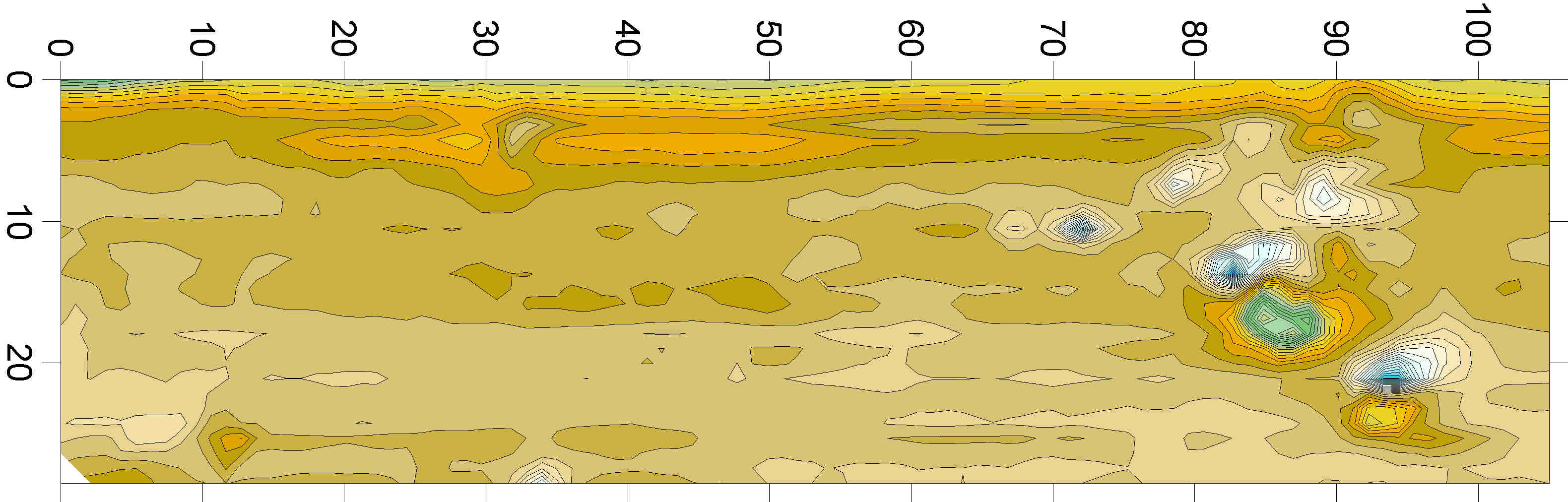

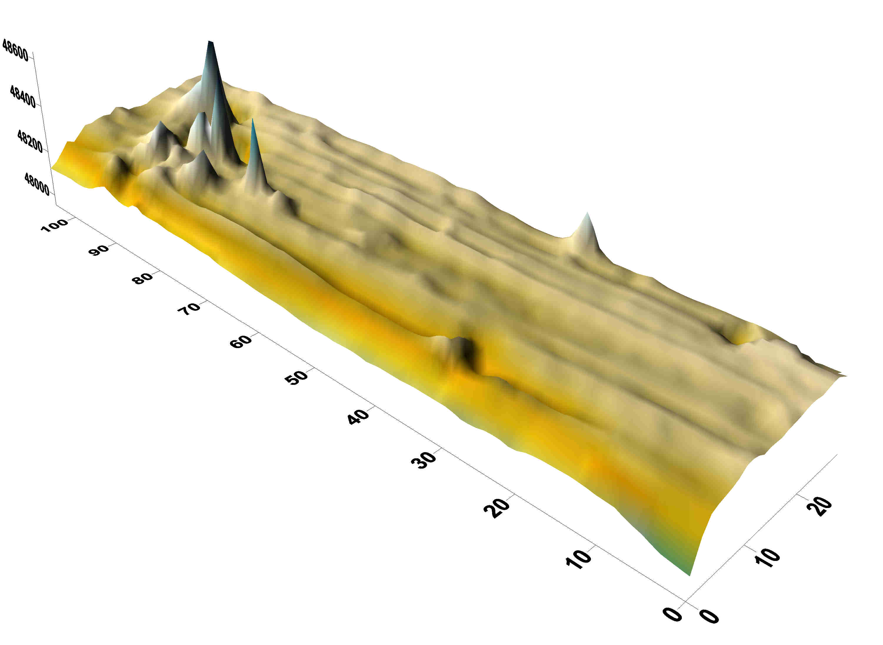

                    I already got good results from surveys with my latest prototype (the one whose design is exactly the same as the one we have started the pre-production).
                    Actually, I have made one survey yesterday on our archaeological digging field. Here it is.
                    Now, we need to integrate this board system inside a proper box, professionally build sensors and test the final assembly.
                    Willy
