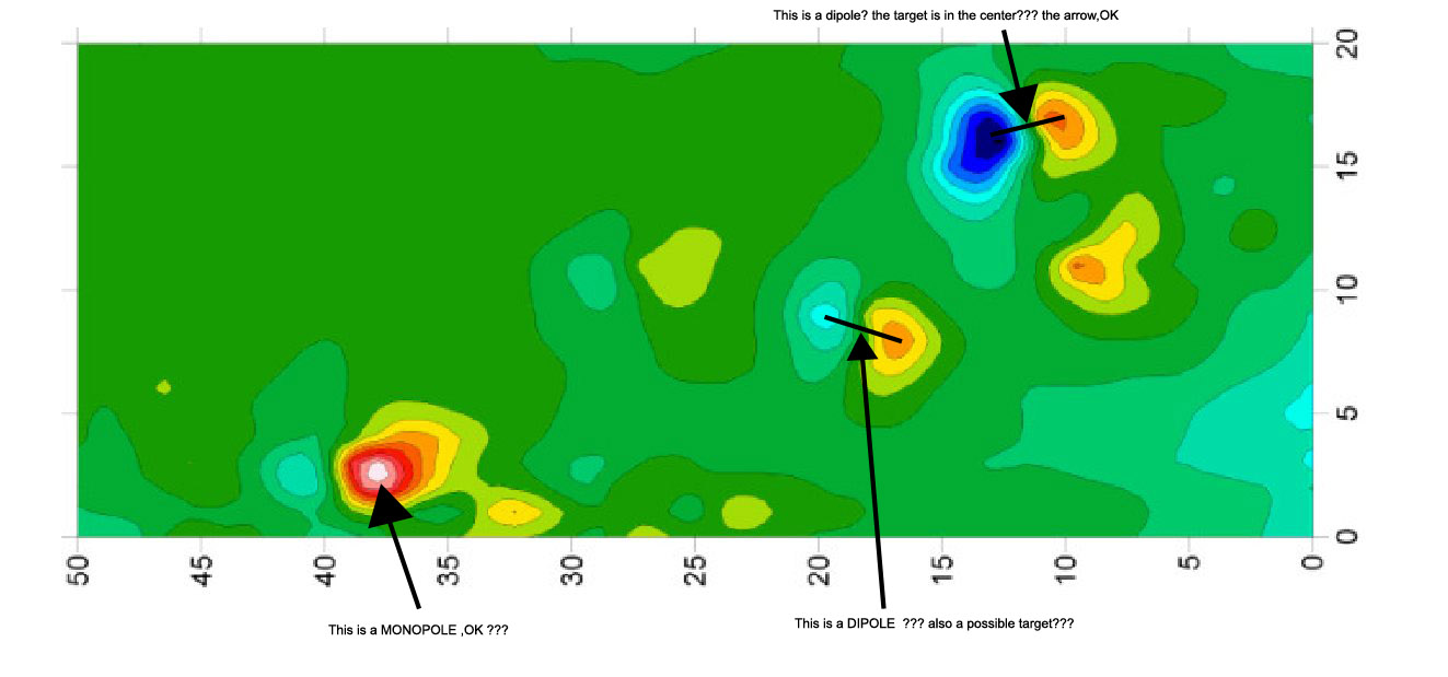

    Thank you for your explanation ...see the Photo, do you think I am right in understanding the data o explain us a little more to definitely have a good perception of the target and very sorry for my ignorance of magnetometry...thank you again for your effort and your equipment conception.
    Best regards.
    Alexis
      Best regards.
      Alexis

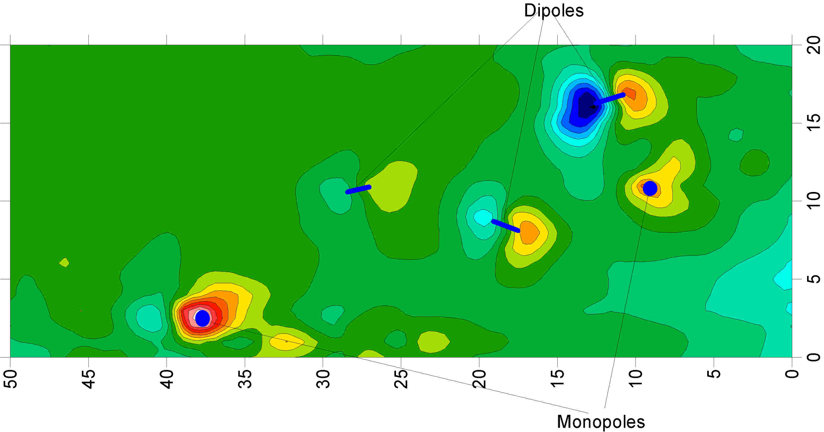

      This is my interpretation of the plot. Note that the leftmost target could be a monopole or a small dipole and the one I noted as a dipole in the middle of the plot is questionable.
      Willy
