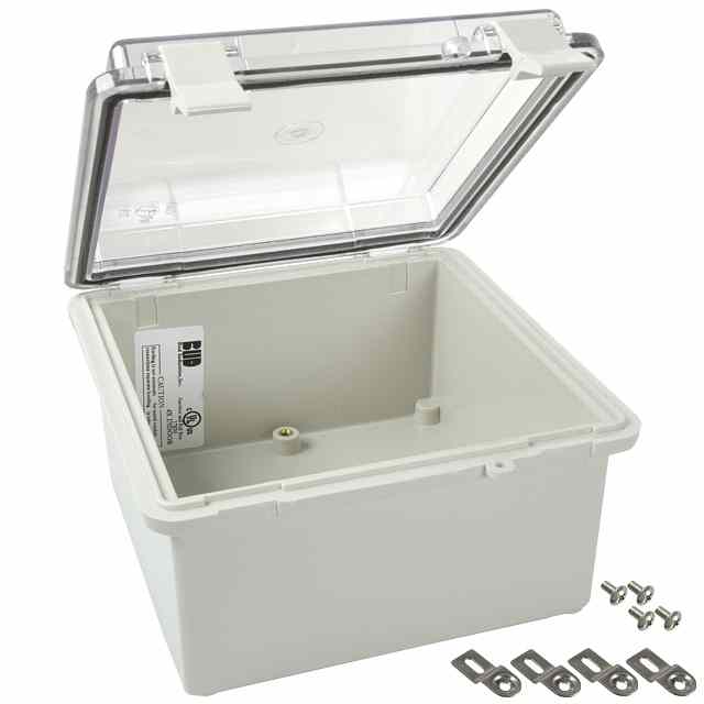

              GPS and new enclosure
              We have decided to use a NEMA-type enclosure to get a better protection against the wet and salty environments. See attached, the picture of box we'll use.
              We know that it is not as nice looking as the small round box shown before but it is also more roomy inside, more rigid and splash-proof. There will be a daughter board fixed in the inside of the cover and on which the LCD, the keypad, the SD card socket, the buzzer and the optional GPS engine will be fixed.
              There will be no openings on the box. The SD card will be removable with the cover opened using its latches. The LCD screen will be viewed through the transparent cover. The key buttons will be protected under a rubber cap.
              About the GPS option, we'll propose two distinct options:
              1. A serial line (with a standard 9-pin DSUB connector) to any external SIRFIII-compatible GPS device. The DSUB connector will also provide one 5V power pin to power the GPS module. This option is software-only, it could be ordered at any time after shipping.
              2. An internal GPS engine inside the control box and with its patch antenna facing up the cover of the box. This option should be ordered before shipping the whole system as it must be integrated by us inside the box.

                re the proposal
                about the new case: waterproof is GOOD, dust proof is even better
                - are you going to utilize water resistant connectors for the battery and sensor(s) ? (generally an o-ring within)
                - is the case large enough for a second set of boards for use as a gradiometer ? (only one with on-board GPS presumably, and only one control panel)
                I do presume that a sensor housing will be available, even if hand fabricated,
                what would the sensor weight be (nominally) ?
                so a gradiometer would be 2x that sensor weight, correct ? (plus fiberglass pole)
                what is the recommended vertical spacing for the 2 sensors ?
                Thanks Willy
                  This new case is for me much better than the titanium case and look more "Geophysical instrument" and it is very good for dust and moisture free
                  Alexis
                    Is it not true that 'waterproof' automatically implies 'dust proof'?
                    We'll see what is available at Digikey. Any idea?
                    This specific NEMA box would not but there exists larger boxes in hte same series.
                    A double-coil sensor alone weights 1.6Kg.
                    Yes
                    You can use a vertical or an horizontal pole. It should be around 1.5 to 2meters long for undergorund surveys. However, it also depends on what targets you are looking for.
