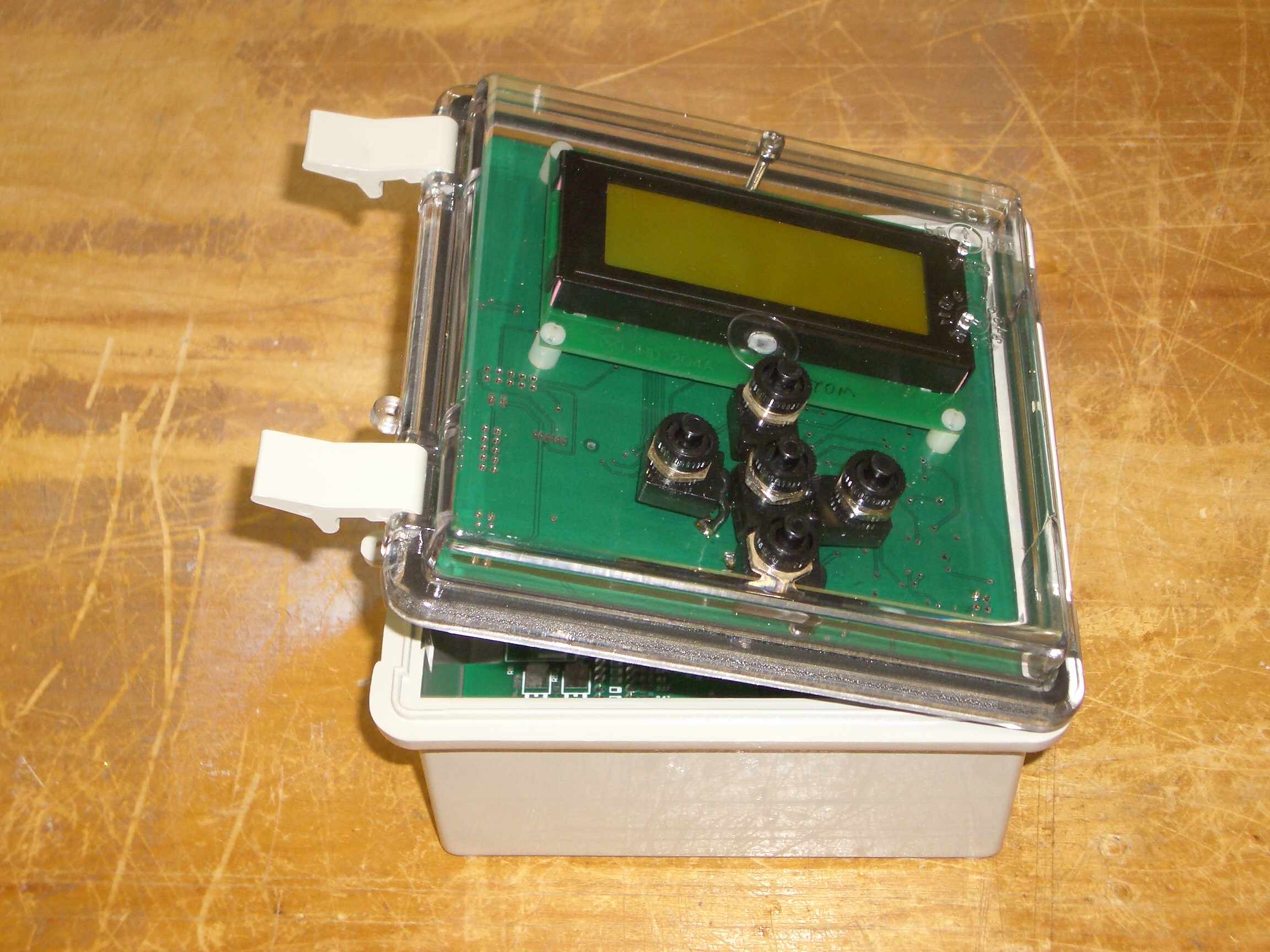

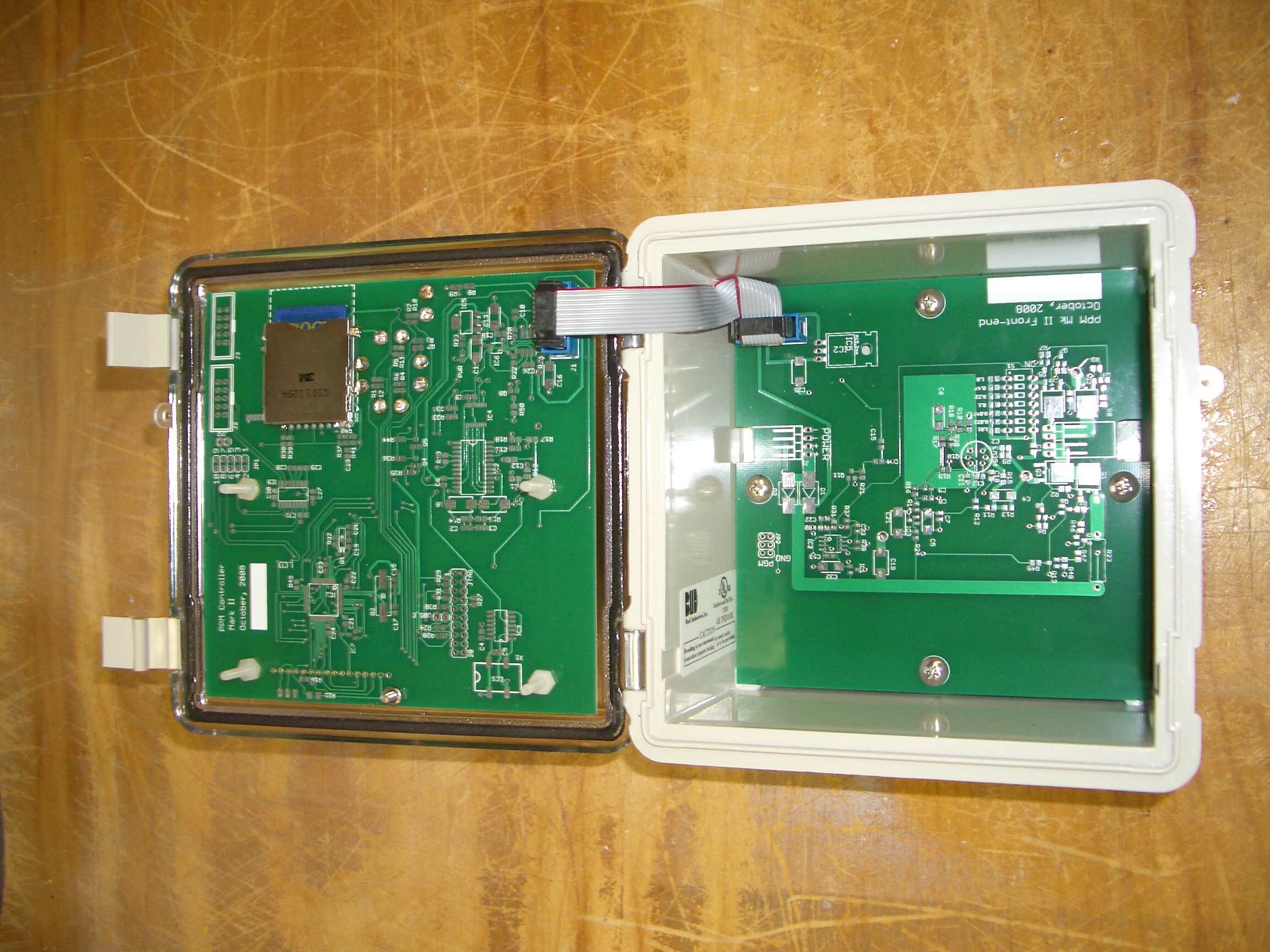

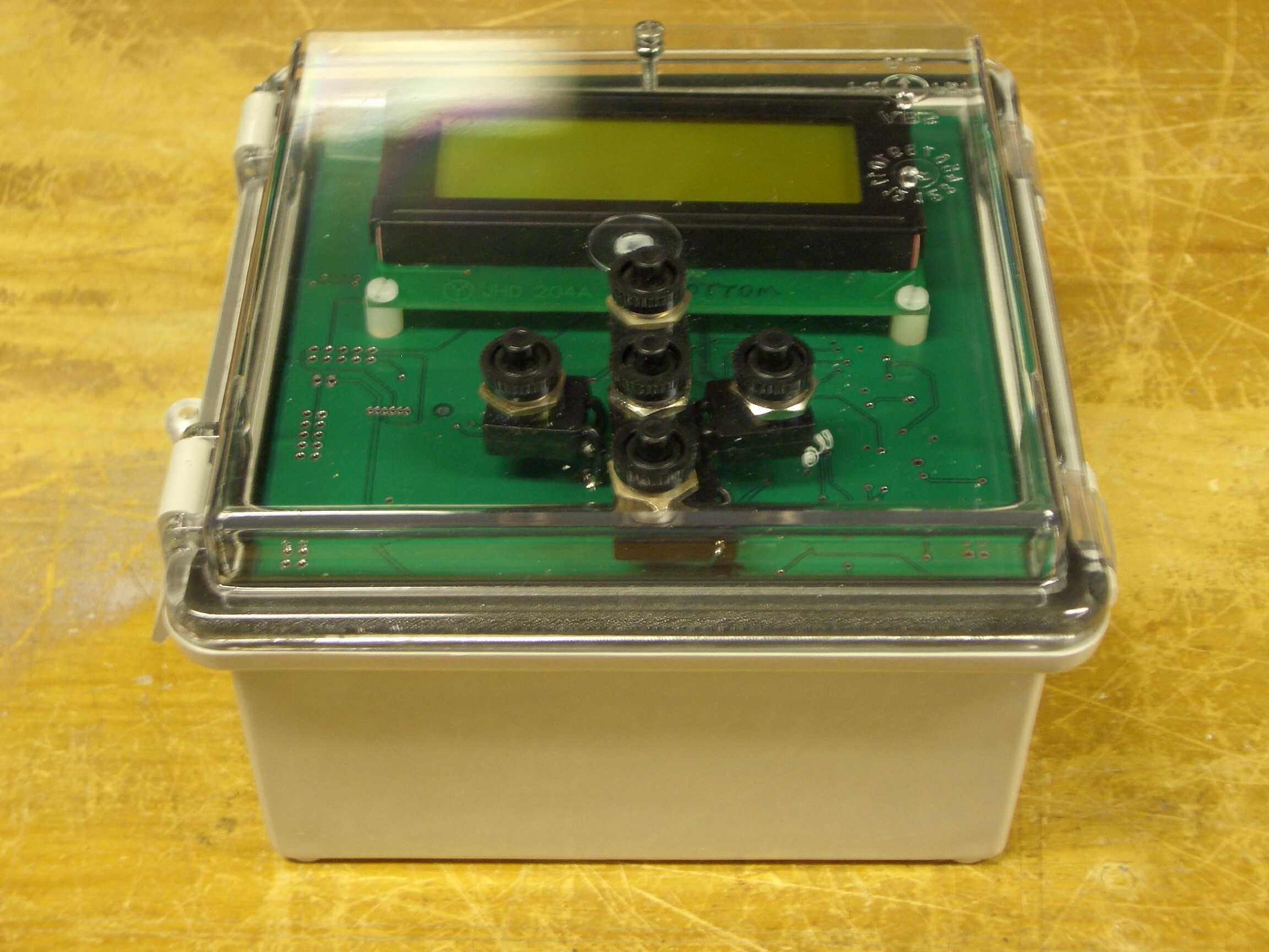

    I also have joined a few pix of our final NEMA enclosure.
    It shows the SD card socket, LCD and keypad in place with the boards as they will be fixed in the box. The boards are still bare as we just have received them from the board manufacturer. I'll update the pix as soon as we have finished assembling our very first unit by hand.
    The full unit, assembled for walking surveys will have another NEMA box fixed under it (back-to-back ) to contain a 5Ah lead battery. The carrying belt will be passed and fixed between the two boxes so, that we do not drill more holes in the boxes. All the external connectors will be IP68-rated.

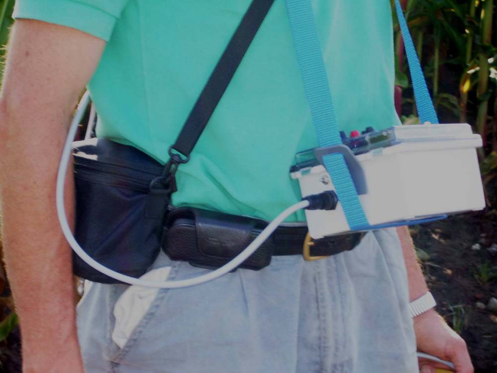

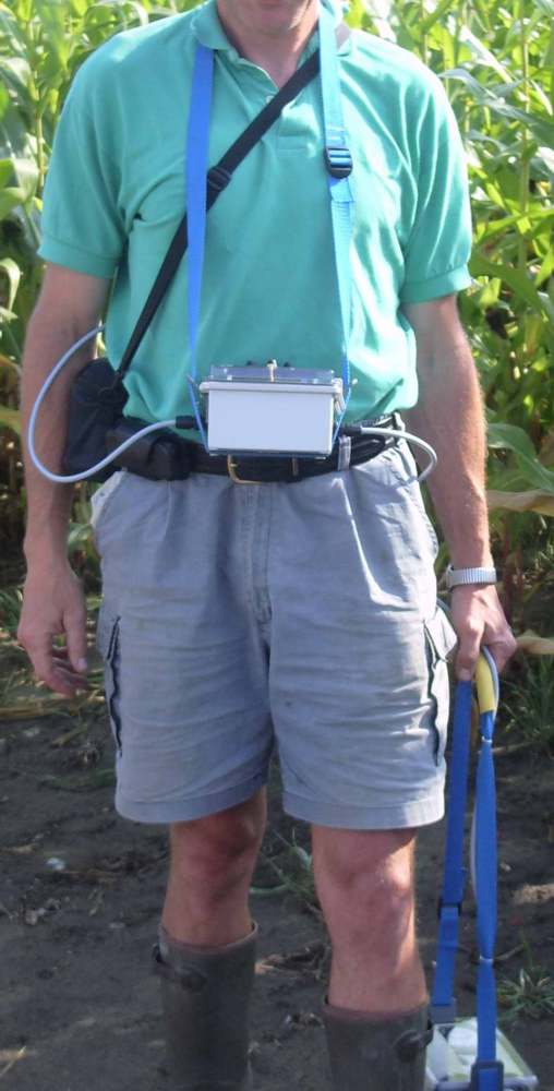

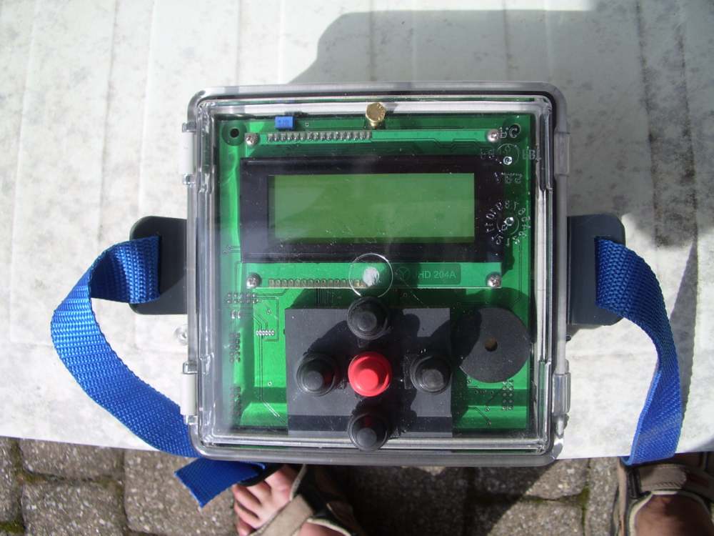

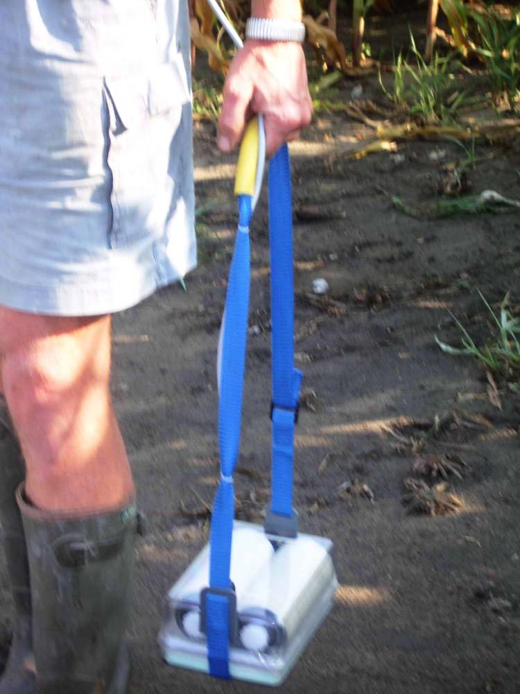

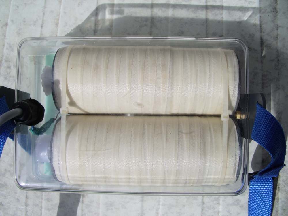

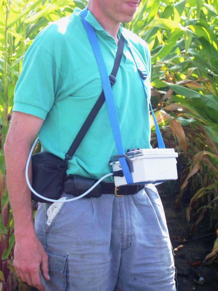

                      This is a set of pictures of the new PPM-MarkIII fully assembled unit.
