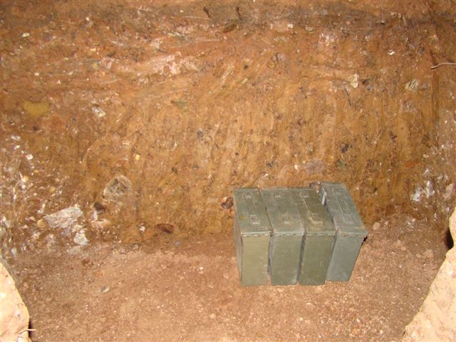

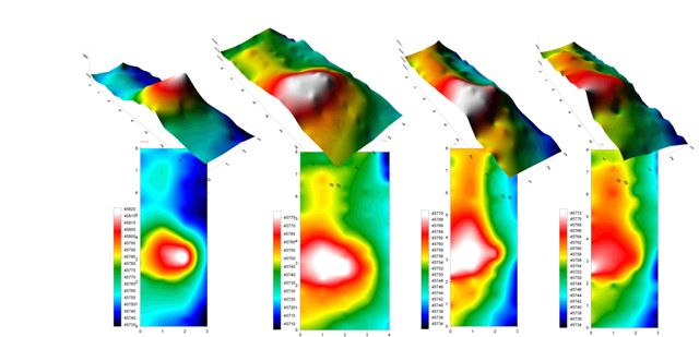

    This is the nice results of a series of benchmark tests with the PPM-Markiii made by one of our good clients.

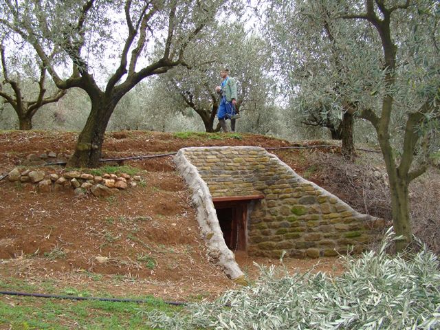

    A tunnel has be dug at a depth of 2.7m under a road and a bunch of empty ammunition boxes have been put in the tunnel. Survey grids were then made over this deep target and the results plotted in 2D and 3D.
    The rightmost plot is with 4 boxes, next is 7 boxes, next is 11 boxes and the last, leftmost plot has been made with 11 boxes elevated in the tunnel to reduce the depth to around 2m.
    Note that an (expensive) EMI sensor device (those so-called 'deep target', two-boxes types of detector) has been used for making surveys in the same conditions and this did not even detect the presence of the last 11 boxes.

    But is hard to explain difference in graph presentation between elevated and un-elevated boxes (I expect more warm/white colours in graph on the left).
      Actually, shallower targets give higher, narrower peaks than deeper targets of the same weight. Deeper and larger targets give lower and wider peaks.
      The 2D surface of the white color area is smaller but you can see that its 3D surface clearly shows closer contour lines.

            You stated in your very early tests that it took you a while to get a proton ring out of your setup. One of the things you had to do was get the sensor off the ground. So this would imply that something in the soil was effecting the protons. If a void, especially as large as the one in the photo, removed a significant amount of soil, wouldn't it effect a reading? I've never tested it, but I've always heard a void could be detected by a magnetometer. This is the first time I've heard that it cannot detect a void.

              Such a void could probably be indeed detected with a sensitive mag like ours but it would require a gradiometer or a differential configuration to really see it by cancelling the earth field diurnal variations which would cover the weak field gradients generated by the void.
              Again, I repeat that a soil with a very low magnetic susceptibility (like normal sand or limestone) is very much looking like air (void) to the eyes of a mag.
              Now, for the sake of curiosity, I could still possibly ask my local friends to make an extra survey using a differential configuration over this tunnel without any known target planted in it. I know they own several PPM-MarkIII systems, thus, they are able to make this test.

                        I'll ask my friends to do a differential survey when their time and weather will permit. Then, we'll see if the field gradients are high enough in their ground to detect a void with or without the help of the differential configuration. Their ground is mainly made of a mix of rocks and soil, it is the perfect ground to grow olive trees and vineyards.
