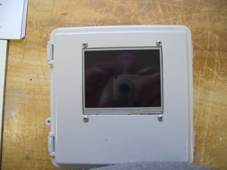

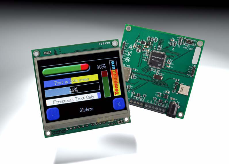

    2. GUI option module
    This is a Graphical User Interface with Touch Pad based on an intelligent 3.5" QVGA module (see picture attached) replacing and upgrading the functions of the character-based LCD and five-key keyboard of the base unit.
    Apart from its neater aspect on the control box (see picture attached), what can you expect from this option to add-on to the existing features of the MkIII or the base MkIV units?

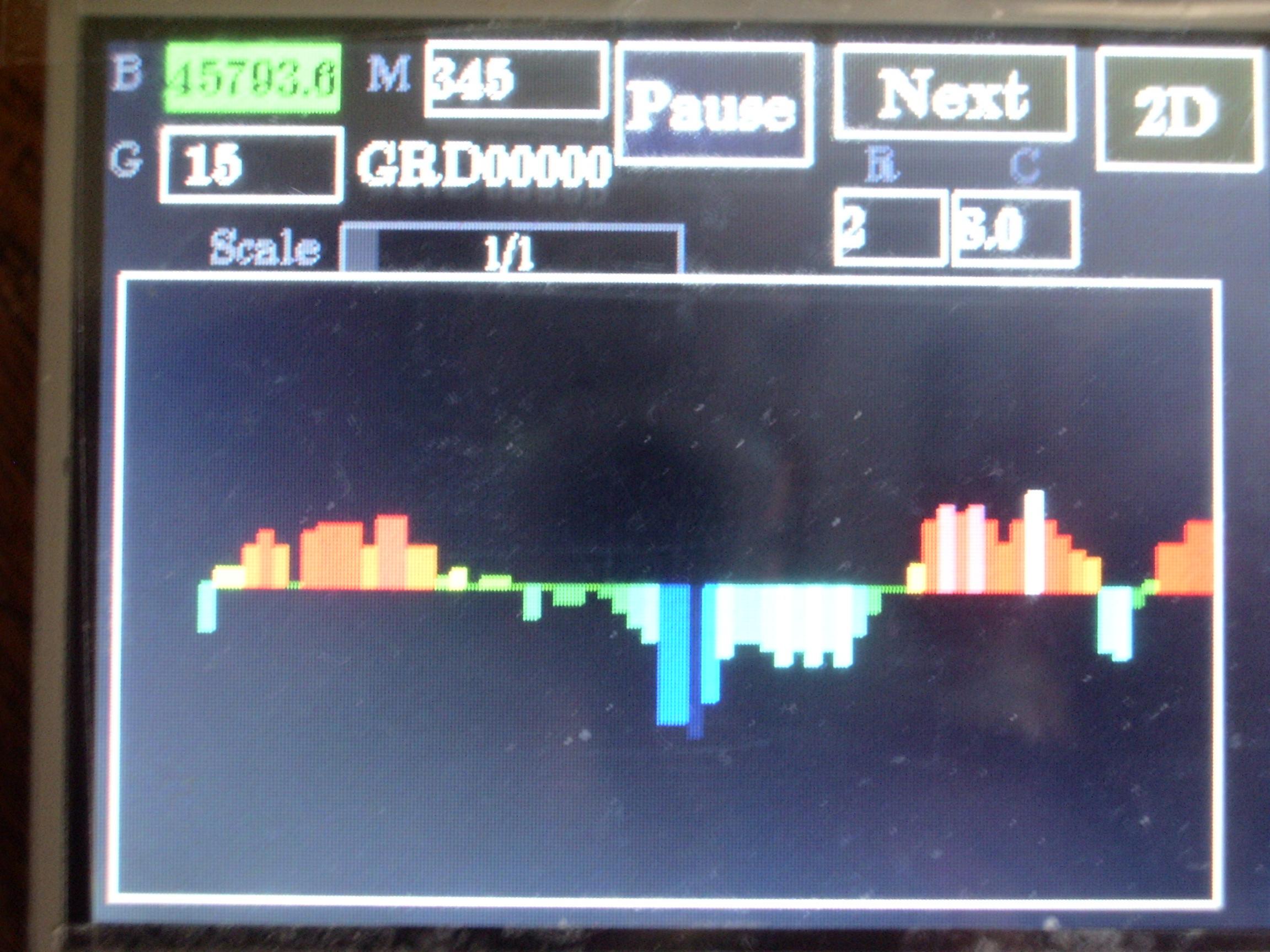

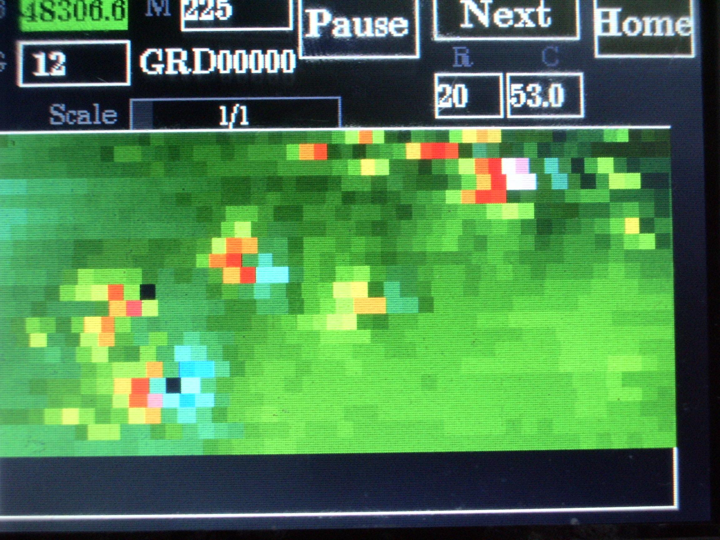

        PPM MarkIV
        This is two pictures of the GUI in operation.
        The first one is the real time display as a running bar chart.
        The second one is the 2D plot displayed on the GUI after executing the post-processing locally.
