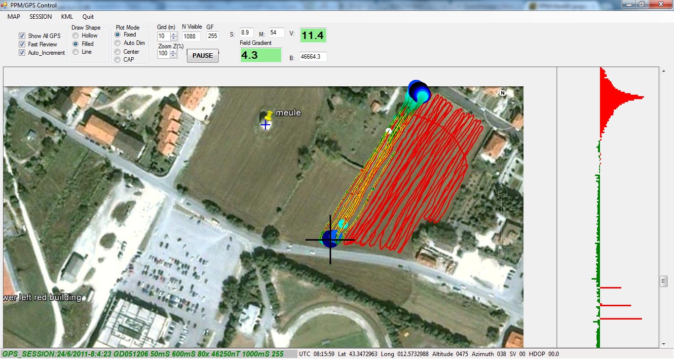

        The PPM Utility program associated with the PPM MarkIVb has been equipped with the capability to display a background map or any picture file on its GPS plot window.
        Any picture file taken from a geographical or nautical MAP or even a screen dump from Google Earth can be integrated in the program using its geo-referencing functions.
        This is what it looks like during a survey or during the replay of a survey. Note that this is based on a screen dump on Google Earth showing the surrounding area around the surveyed field.
        This feature is now fully integrated and included in the price of the MarkIVb package.

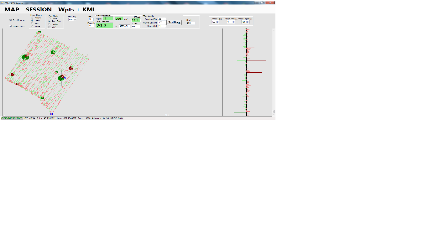

              We have also very much upgraded and improved the PPM Utility program for both underwater and underground surveys in real-time operation and in post-processing.
              This program can now accept the NMEA data stream from an external GPS replacing the integrated GPS.
              It also can complement the GPS data from the integrated GPS with the depth data (as NMEA sentences) coming from a sonar and plot it along with the PPM data.
              We have upgraded the generation of survey paths and waypoints including the automatic generation of full survey routes made of parallel survey lines based on a reference waypoint.

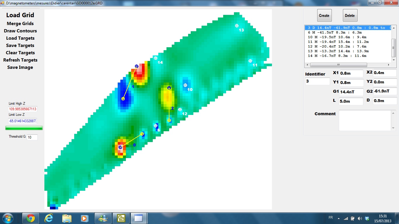

              For the post-processing of grid-shaped survey files, we are now able to interpolate the readings and generate/display on this program 2D contoured, colored grids (exactly as Surfer does it).
              These grids can then be scanned by the program to locate and mark potential targets as monopoles and dipoles with a measurement of their height and surface.

                          The operation of the PPM is being optimized by the mounting of the control box, the GPS and its antenna, the battery and the sensor in a backpack leaving the hands of the operator free. The human-interface has been implemented on a 8" or 10" tablet inserted in a watertight plastic envelope and connected to the PPM control box through a Bluetooth link. The shape of the survey sessions is controlled through a precise GPS system.
                          The windows-based post-processing system has bee upgraded with a 2D colored grid generation process and an automatic target detection system.
                          The figure 95-1 attached shows the GPS and PPM tracks as they appear during the real-time session or during the review of a survey file.
                          You can see the numerous parallel survey lines shown by the 2D GPS plot, the field gradients displayed as variable size color bubbles and the vertical barchart showing the variations of field gradients over time. In this case, the rectangular area covered by this session is 40x40m.
                          Already here, some potential targets are visible. They can be located with their GPS coordinates using this window.

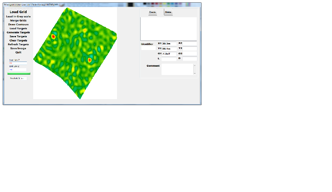

                          Then, a 2D colored contour grid is generated by a sophisticaed interpolation algorithm. This is shown in figure 95-2.
                          The potential targets are now much more visible. The general average field level is colored in light green and the sensible variations of field gradient are colored in warm colors for positive gradients while negative gradients spots are colored in cold colors.
                          From this grid, it is now possible to manually mark and list the location of potential targets and the data to be used for the evaluation of location, size and depth. From this list, it is then possible to generate a list of GPS waypoints to be used later for target pinpointing.

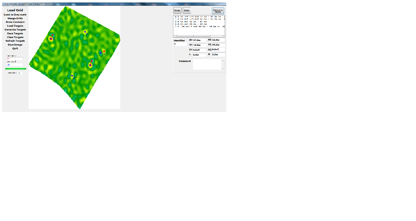

                          From this grid, it is also possible to start an automatic target detection process giving for example the figure 95-3. This process detects all the field gradients exceeding a given threshold, measuring their surface and height and marking them on the 2D grid.
                          Most targets generate what is called 'dipoles', i.e. a positive field peak closed to its corresponding negative peak.
                          Some of them reduce to 'monopoles' made of a single positive or negative peak.

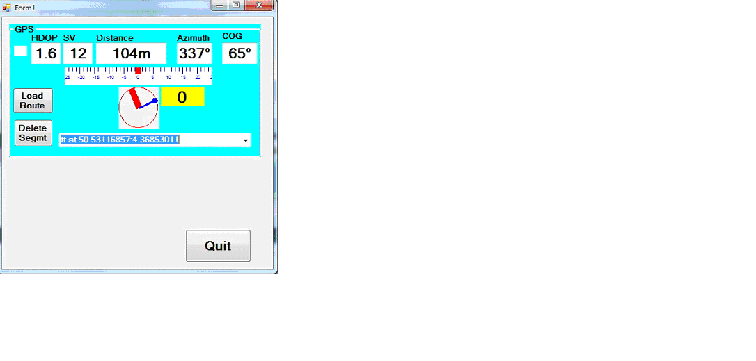

                          Lastly, we have upgraded the real-time system to define the shortest route between the target list and to navigate the operator through that route using a virtual compass. See figure 95-4.

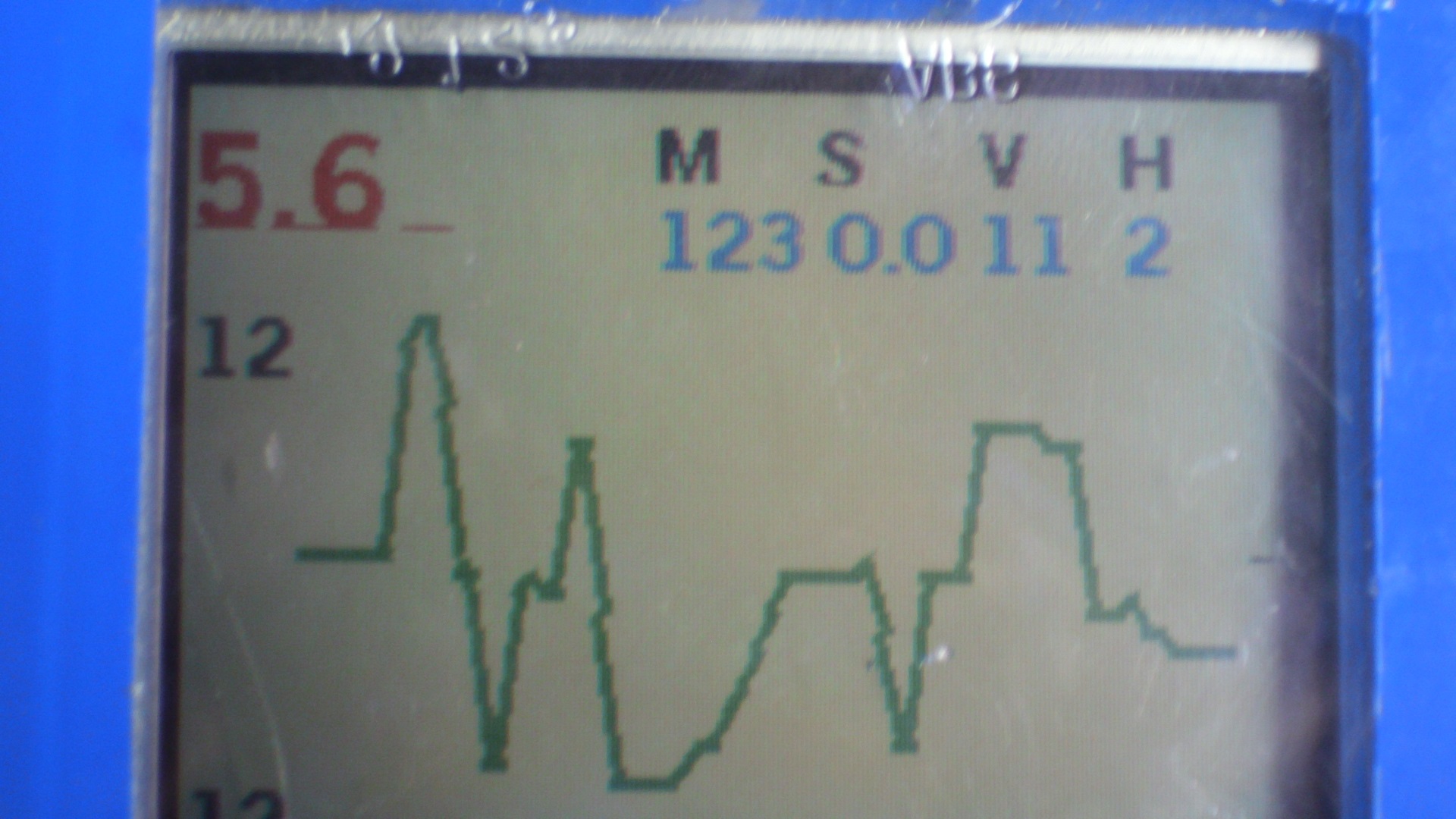

                              • #75

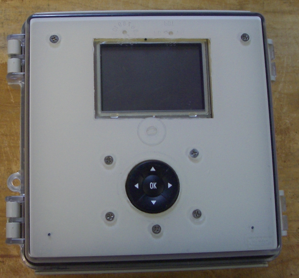

                                The main improvements of this version over the previous MarkIV version are the sun-readable color GUI display and the Bluetooth connection to the PC-based control program.
                                This program can run on a small 8" tablet under Win 8.1 and thus, the PPM box carried in a backsack with the operator having only the tablet in his hands.
                                This program has also a lot of new features, they are described in details on the new web site.
                                As always, the same PPM control box can be used for underground surveys AND for underwater surveys, the only difference being the sensor container.
                                This is two pictures of the new control box and its display during a survey session.
